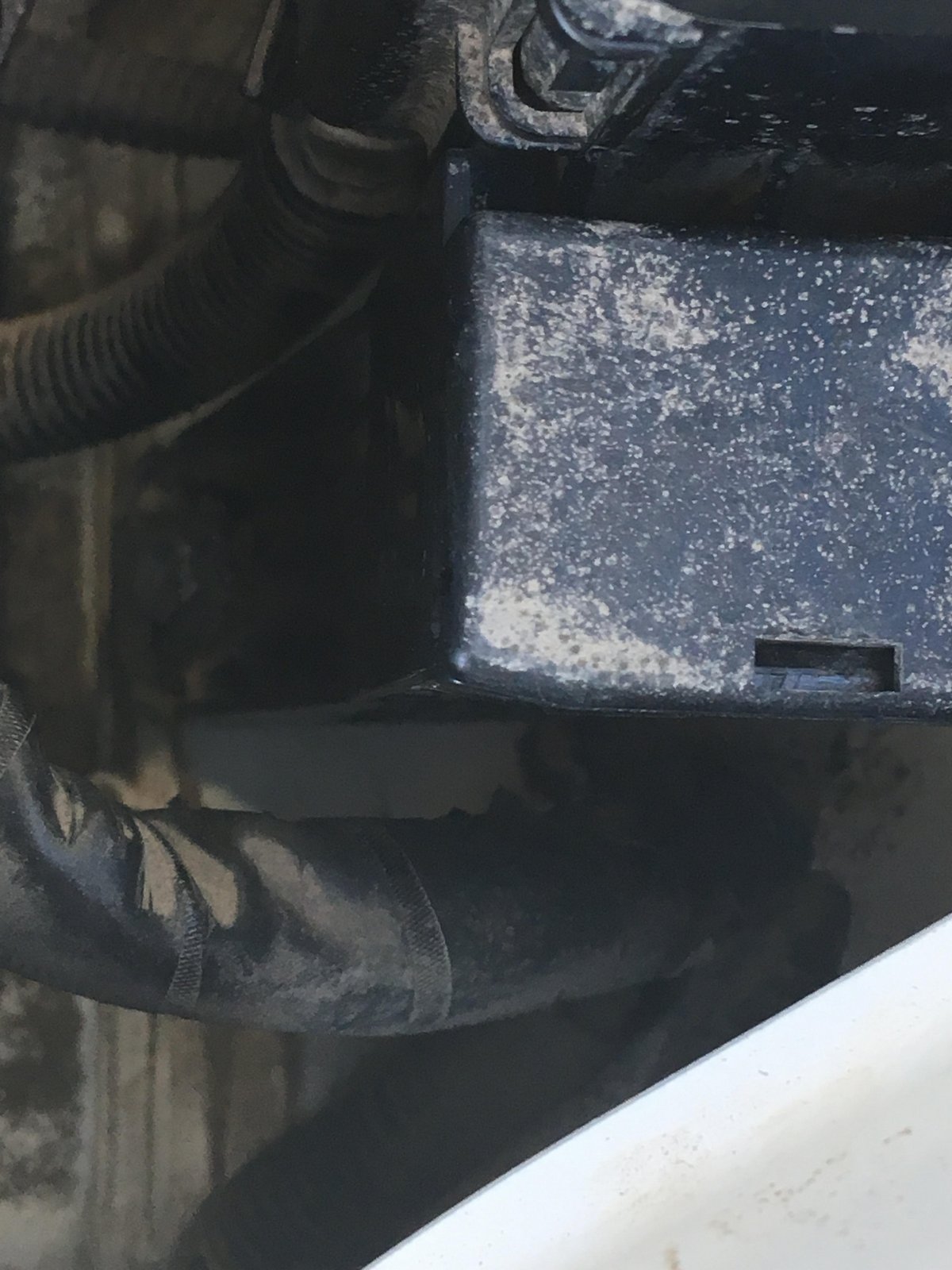

Well im afraid I dont have time to redo the process again, but here are some pictures of the parts refered to:
The wiring harnesses that need to be disconnected:
The top of the fusebox holding bracket. (Removing the small plastic cover exposes the top bolt)[below]
The bolt at the bottom of the fusebox holding bracket[below]
The actual installation of the bulbs are the same as all of the videos posted, except they are done with the headlight assembly still in place.
Hope this helps!
Cheers
Hope this helps!
Cheers
