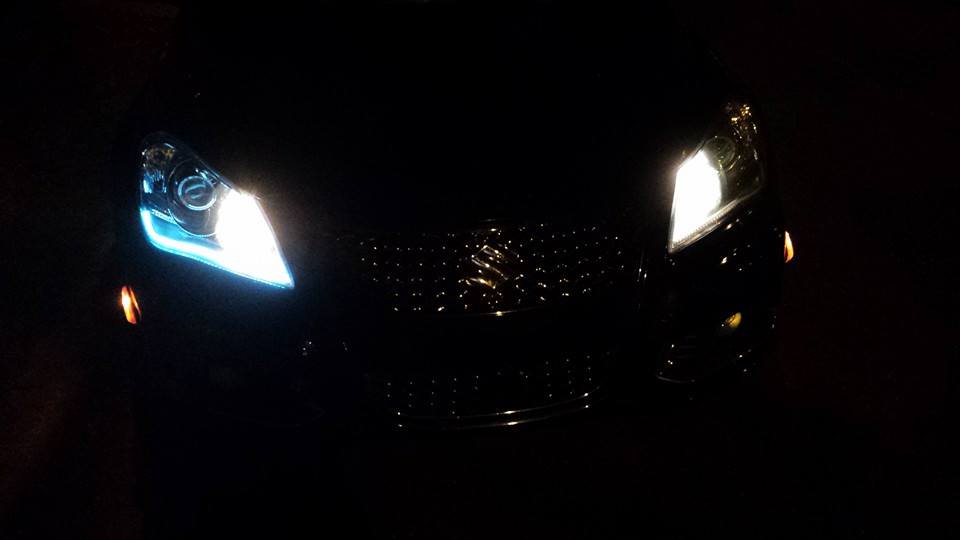

OK so I made a mistake but I think I can redeem myself. My lights did not operate the way I stated before. They actually work the same way that everybody do. So I apologize for that.
After looking over the wiring diagrams, I think I have a solution to disable the high beam bulb DRL function while keeping the high beam. I also have a way to keep my new LED strip illuminated at any time the car is turned on.
What other variations were people wondering about? I want to try to help with this.

The wiring mod I want to see is how to make the fog lights on all the time instead of only with the low beams.
I think I have the following figured out based on the wiring diagrams: Just need to do some testing to confirm and I will follow up.
- Run LED strip at all times the car is on.
- Run Fog lights at all times the car is on.
- Bypass DRL control module to eliminate DRL function ONLY.
I just dont like the look of my LED along with the DRL. Also, it is currently wired along with the DRL at the lower voltage so the LED is dimmer as well :( Going to change that. Also, I found out the voltage between the DRL and High beams is only a difference of 13.9V to 14.25V however, there must be more going on there because I'm pretty sure 1/3 of a Volt will not cause the light to be THAT much dimmer.
DRL bypass has been done but I'm interested to see how to do the first two
Oh, interesting. I thought I had read that they lost the function of the high beams as well.
I think it uses a switching power supply to VERY rapidly switch the current on and off instead of reducing the voltage. Most meters would still read this as full voltage.
I guess it depends on how you disable them. The DRL control module is just a glorified relay so anything is possible if rewiring!
