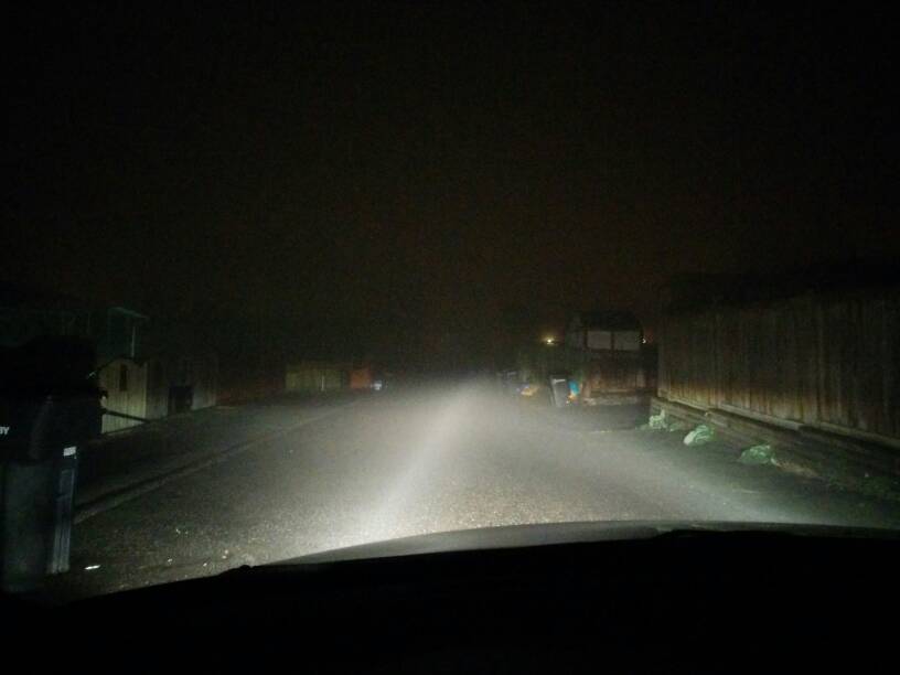

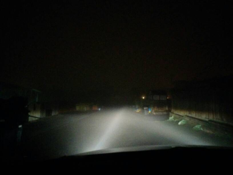

Drove in some dense fog today and took some pictures of the factory set up with stock aim and halogen bulbs.
First picture is low beams and fog lights. The fogs help a bit but I feel like they could be aimed higher up, as already discussed. Second picture is low beams only.
The fog lights definitely made a difference between the photos. While straight ahead may not look like much, see how the fog + low photo shows the road lines on the left side much better? That's pretty much the whole point of fog lights. They are to illuminate the front but more the sides of the car so you can better see the road lines and road reflectors.
