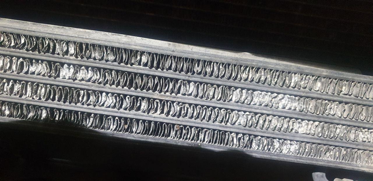

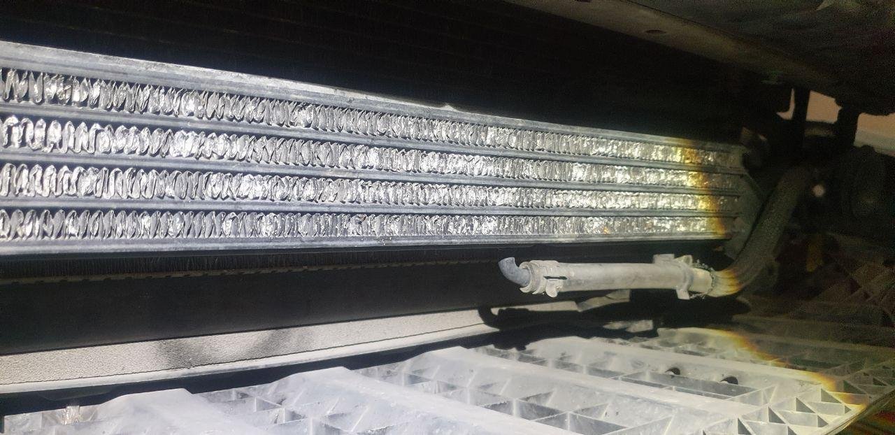

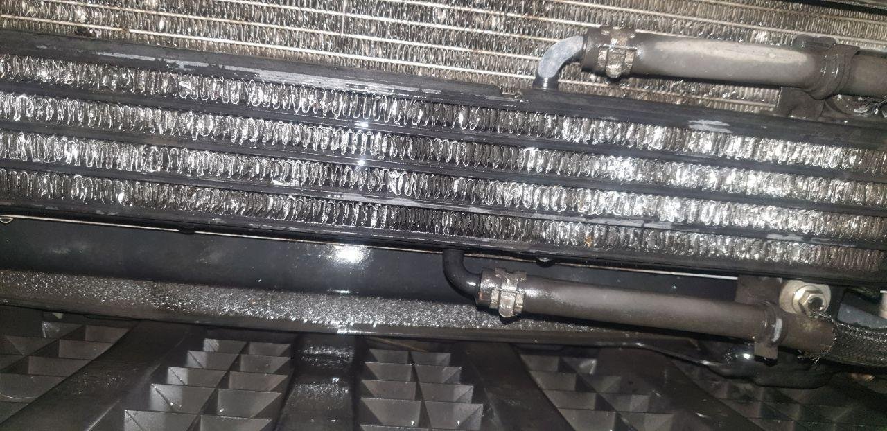

I noticed that the CVT oil radiator has a very thin radiator and if you use a pressure washer to clean it can easily bend and restrict airflow through the radiator and can cause overheating CVT oil.
Quimicax
Posts: 36
Location: Dominican Republic
I Put New One With Fan With Thermostat
I used to drive for a long time and the temperature almost reached 100c (212)
With New Oil Cooler And Fan With Thersmostate
Only Hit 75c(167f) ~ 80c(176f)
Fan Is Turn On when it approaches 85c (185f)
