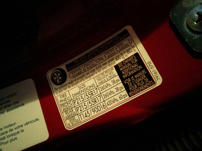

Just checked the sticker and it's 38PSI all around
[attachment=-1]uploadfromtaptalk1393602097677.jpg[/attachment]

bootymac wrote:Just checked the sticker and it's 38PSI all around
But this might vary for the various size wheels available for the car. Between the 16s on the S model and the 18s on the Sport GTS/SLS, I'm sure the pressure varies a bit. It can even vary when you replace a tire with a different load rating.
I always use the load rating and max cold inflation pressure as a place to start. If the load rating is 94 and recommended pressures are 40 and max 44, I assume a linear rate for load/psi and calculate the load being supported by the tires. I'll compare this to the GVWR of the car. Then I'll make sure whatever I replace the tires with will have a similar load rating. For our snow set of Altimax Arctics, that means a cold pressure of around the max of 44. It's been hovering around 42-43, so I'm okay with that. But the initial 35psi that the tire place put in didn't cut it at all and you could tell the tires were overloaded (I forgot to tell them the pressure I wanted).
