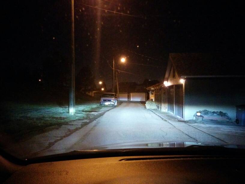

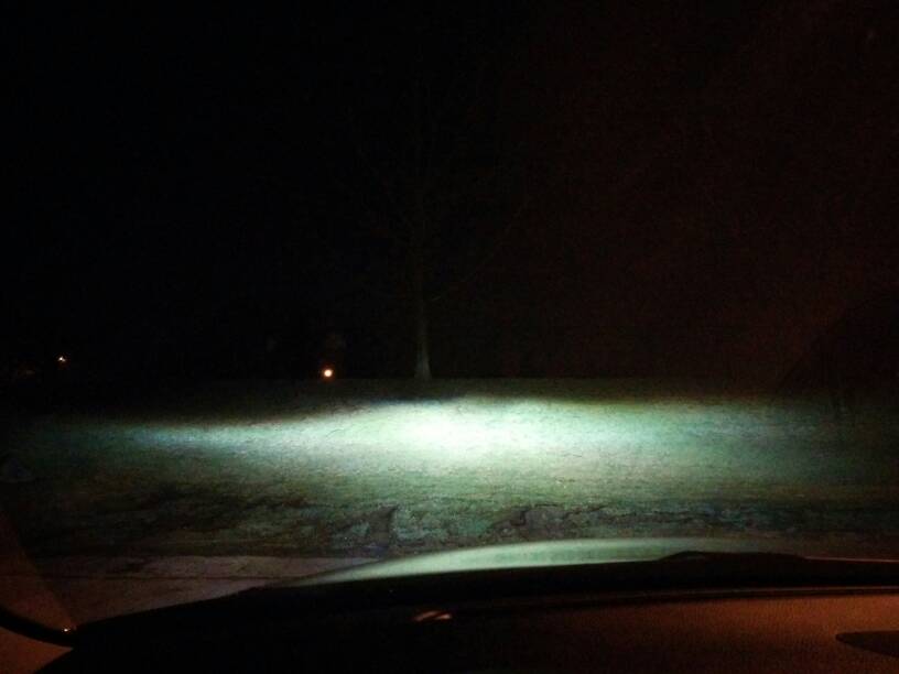

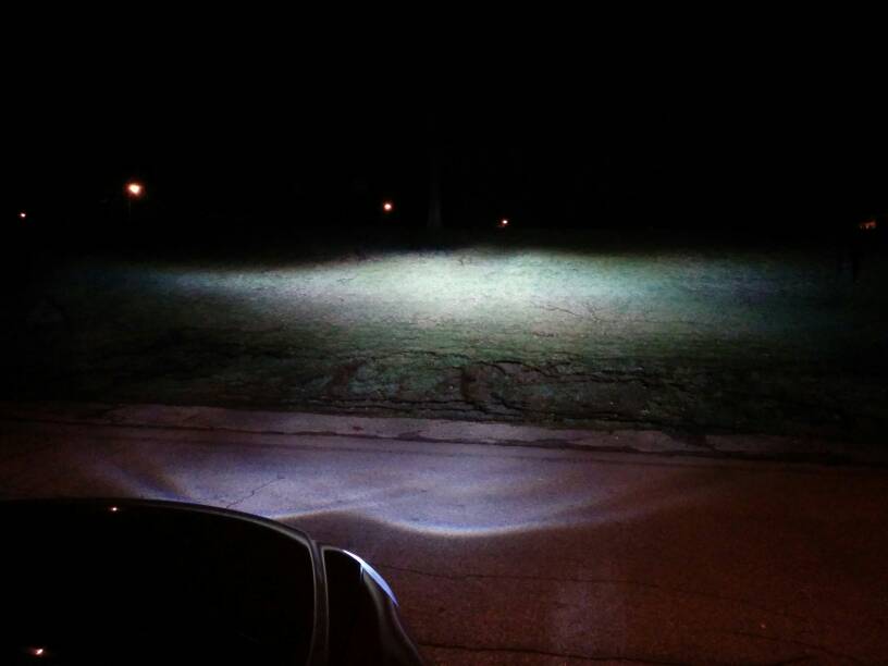

HIDs are in and I am VERY impressed.
I modified the bulb holders so that the return wires are facing down. The stock fitment positions the returns wires facing up, causing shadows in the beam.
I also popped the L-R adjuster covers (one which flew into the depths of my GTI's engine bay...) and adjusted the left headlight a bit left and up.
I managed to fit the ballasts within the housing so no drilling required.
The Philips Blue Vision bulbs are still too yellow compared to the HIDs.
I'm still tweaking the aim but here's how it looks so far. First picture is on flat ground. Second and third picture are on a sloped driveway facing a hill
