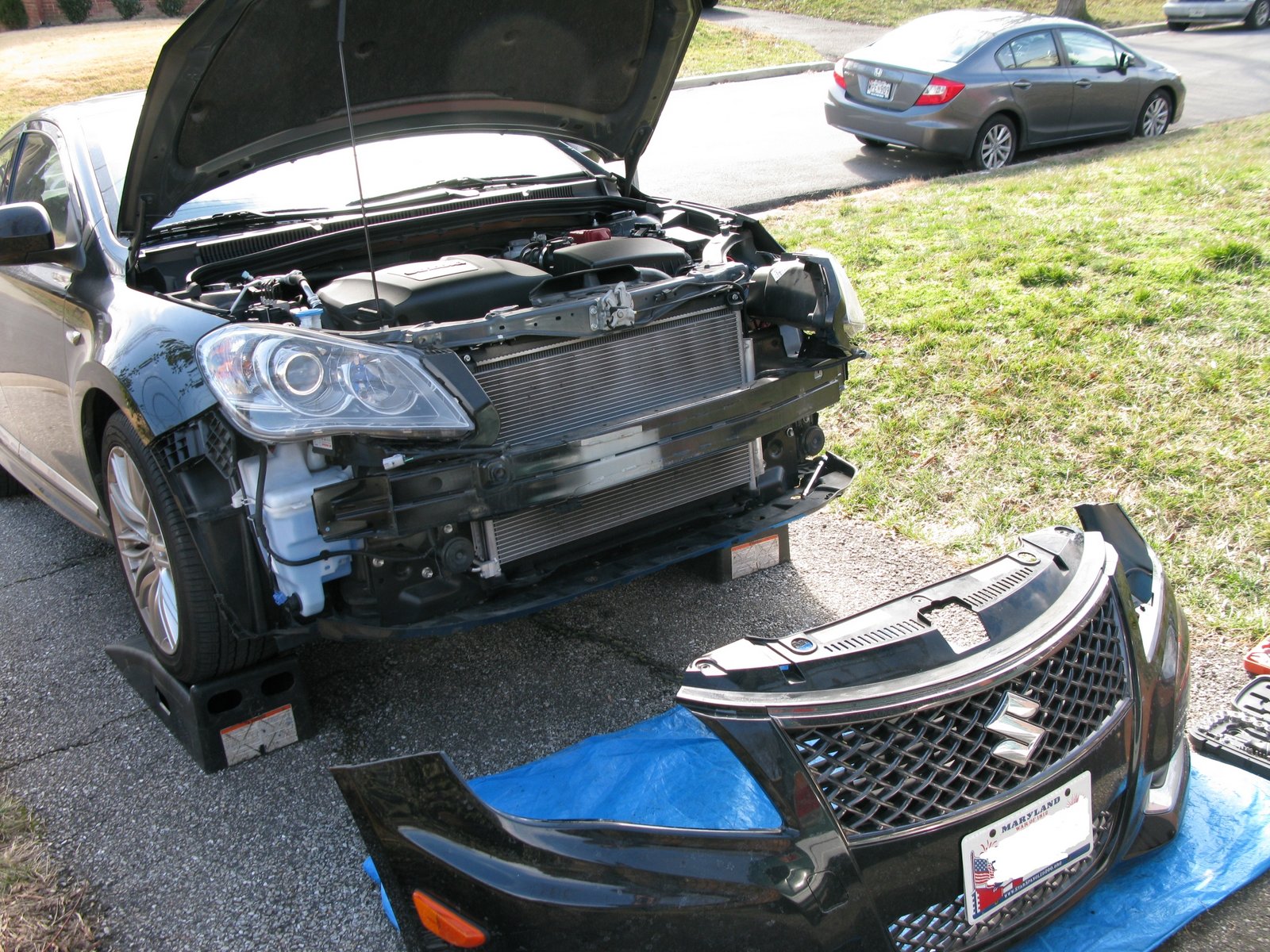

As many of you know, installation of just about any bulb in the headlight of the Kizashi requires the removal of the bumper and the headlight.
Here's a walk-through on the position bulb replacement.
1) Remove the bumper and headlights.

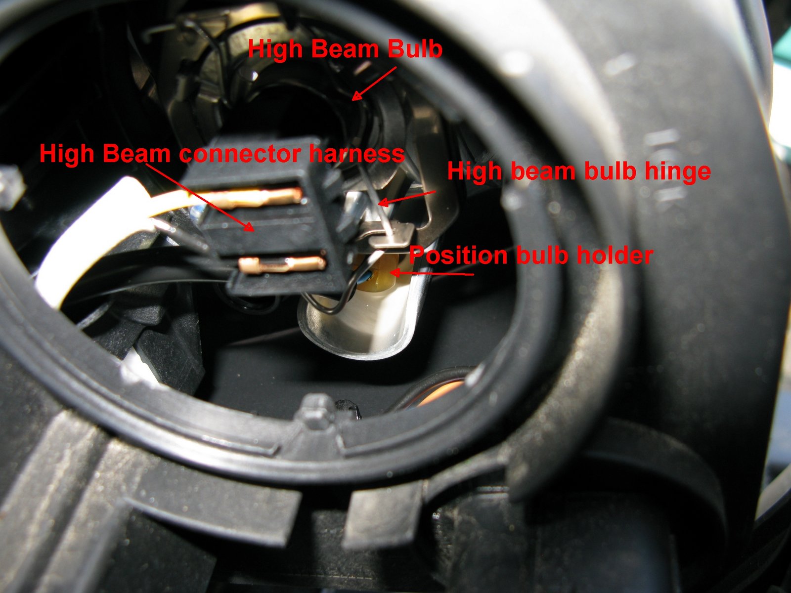

2) Remove the cover of high beam bulb housing. The position bulb is also accessed via the high beam housing as the position bulb is located directly under the high beam bulb.
3) Disconnect the high beam bulb harness.
4) Unhinge the bulb holder to remove the high beam bulb. The hinge is easily removed by squeezing the wire hinge, pushing forward, and then towards the opening.

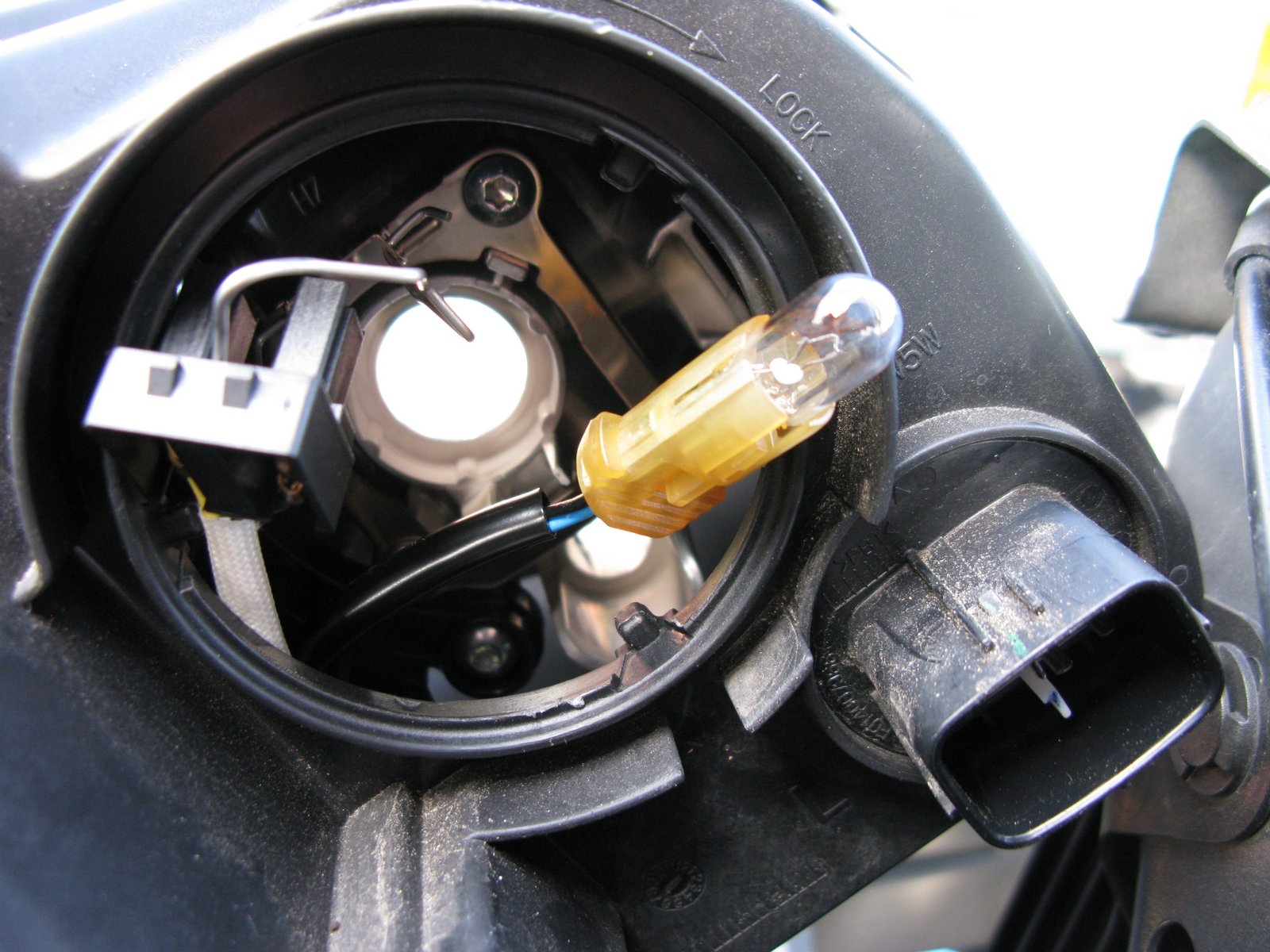

5) Once the high beam bulb is removed, you have access to the position bulb housing and holder. Using pliers, carefully pull the plastic holder of the position bulb. It comes out will little effort.
6) Pull off the position bulb.

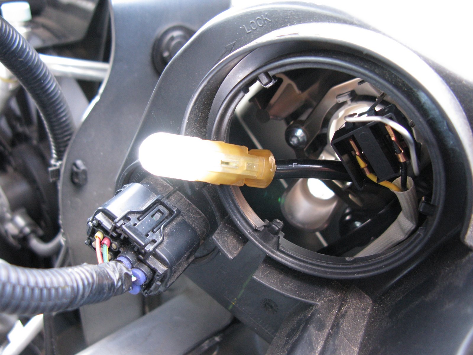

7) Push in the replacement bulb (LED in my case) into the holder, but NOT into the headlight housing yet.

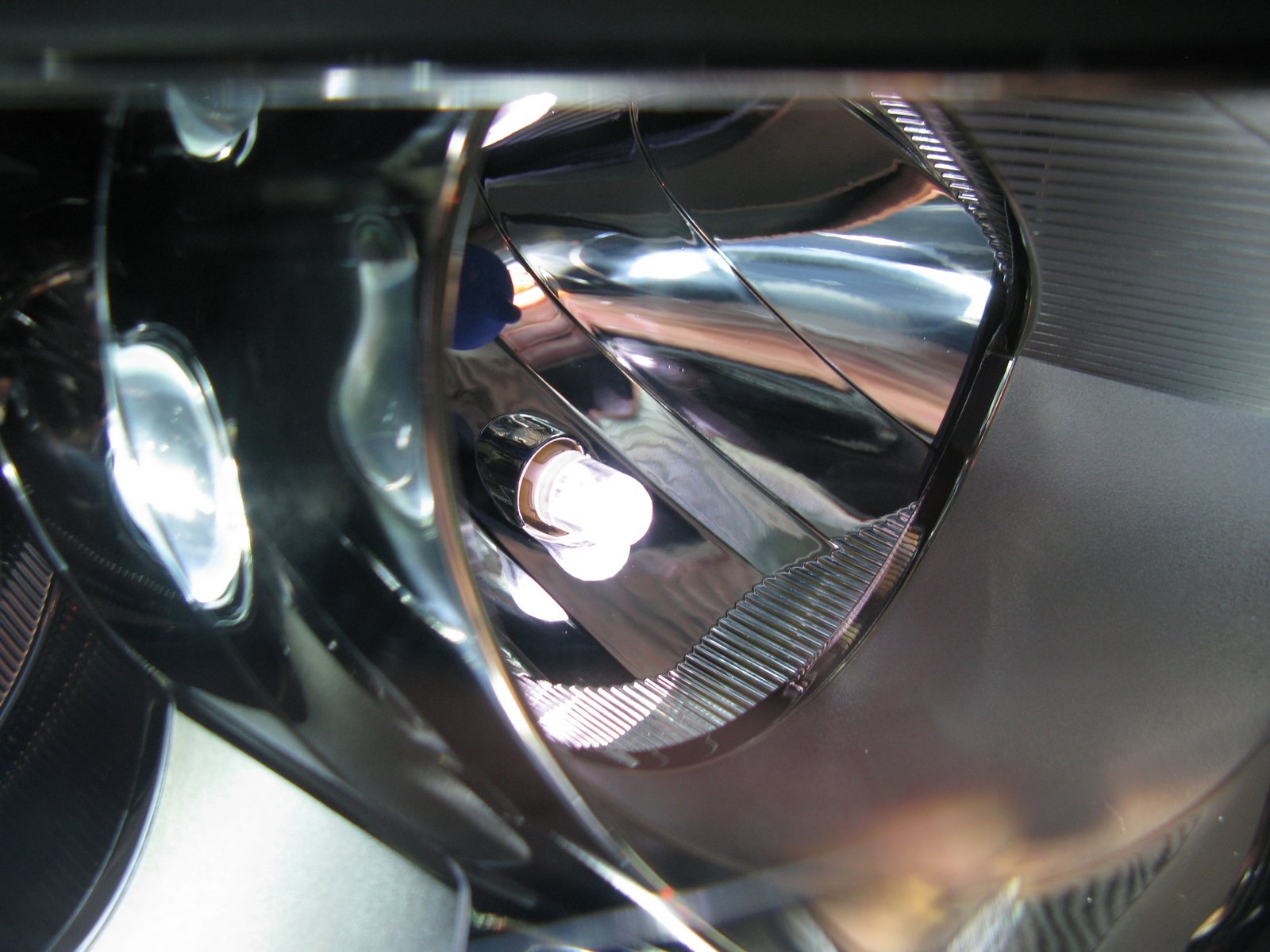

8) VERY IMPORTANT: Turn on the headlight to the middle (position light) position. Make sure the position bulb lights up. LED bulbs require the correct polarity to illuminate. If the bulb does not illuminate, pull it off and turn the bulb and re-insert so it is in reverse position. It should light up.
9) After the bulb illuminates, turn off the lights and insert the bulb into the headlight housing.

Remove the bumper and the headlights.
The high beam and position bulbs are installed. You must remove the high beam bulb to access the position bulb.
Position bulb in holder.

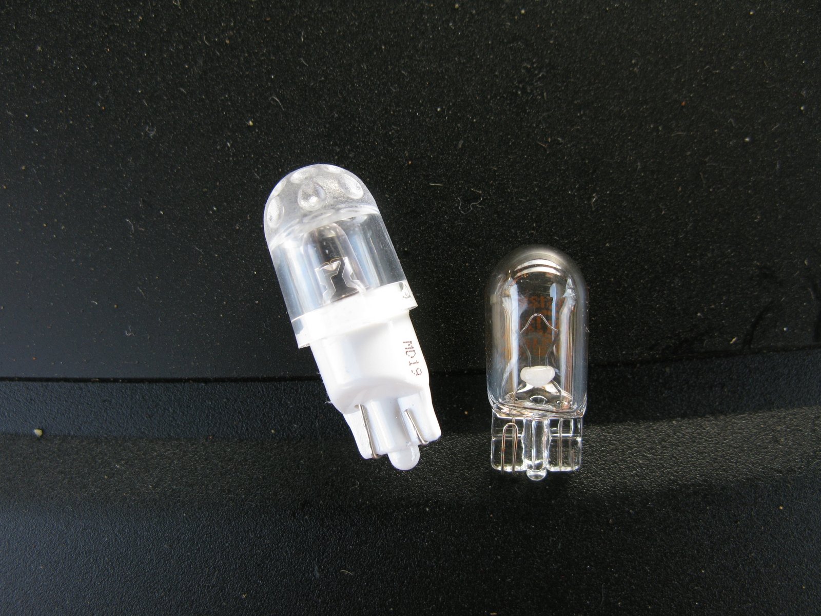

PIAA LED vs. OEM incandescent position bulb.
Make sure it lights up before placing it in the headlight housing.

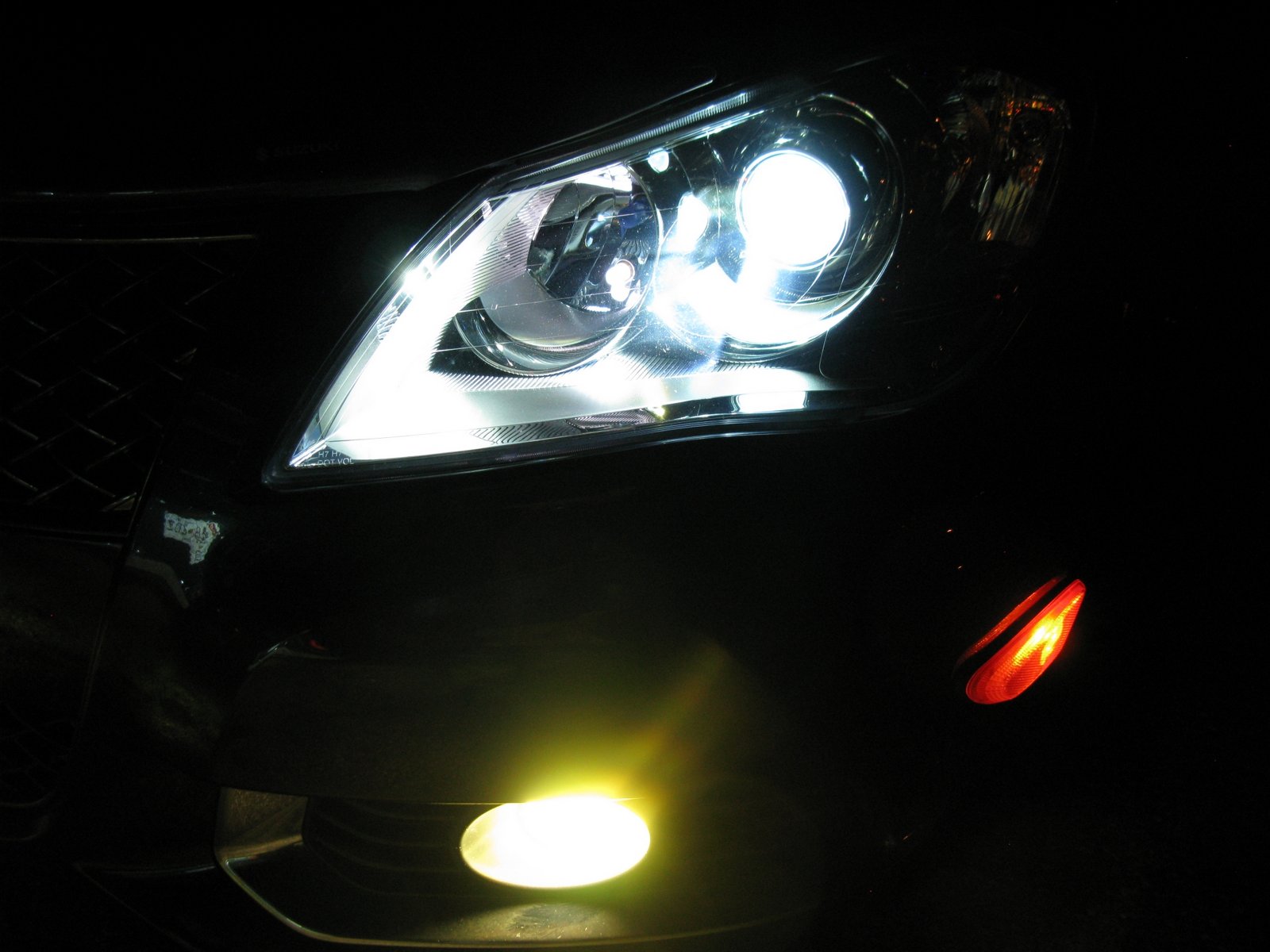

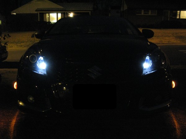

Kizashi with position lights only.

So, are these bulbs on all the time, or only when you're not in "auto" mode, stopped, with the ebrake on?
~tc~ wrote:So, are these bulbs on all the time, or only when you're not in "auto" mode, stopped, with the ebrake on?
I don't have the auto headlights as I have the GTS, not the SLS.
The positions bulbs are on whenever the low beams or position marker lights are on (basically anytime the headlight switch is in a position other than OFF).
If you drive with the headlights switch in "OFF", then ONLY the DRL (high beam bulbs at low wattage) is on.
If you drive with the midway, position marker light switched on, then BOTH the DRL AND the position bulb illuminate. If you were to pull the handbrake, then the DRL turns off, but the position bulbs remain on (pretty much the point of why they exist. Displayed in the last picture above). This way, you can be parked or idling somewhere with the lights on, but not the low beams.
When the headlight switch is turned on to low beams, BOTH the low beams AND the position bulbs illuminate, but not the DRL (also pictured above in a different photo). This is why some of us like me wanted the white LED position bulbs to match the white HIDs.

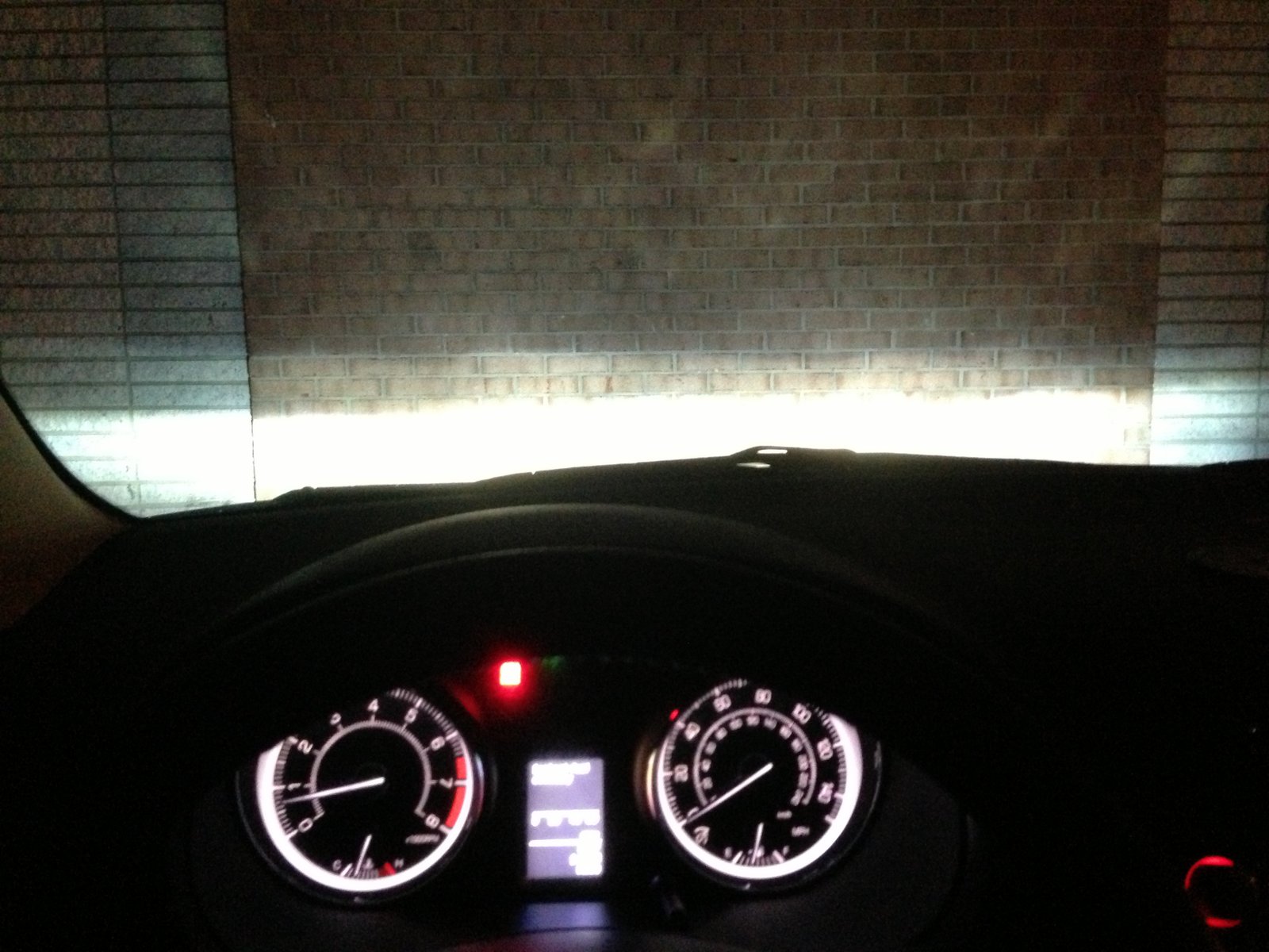

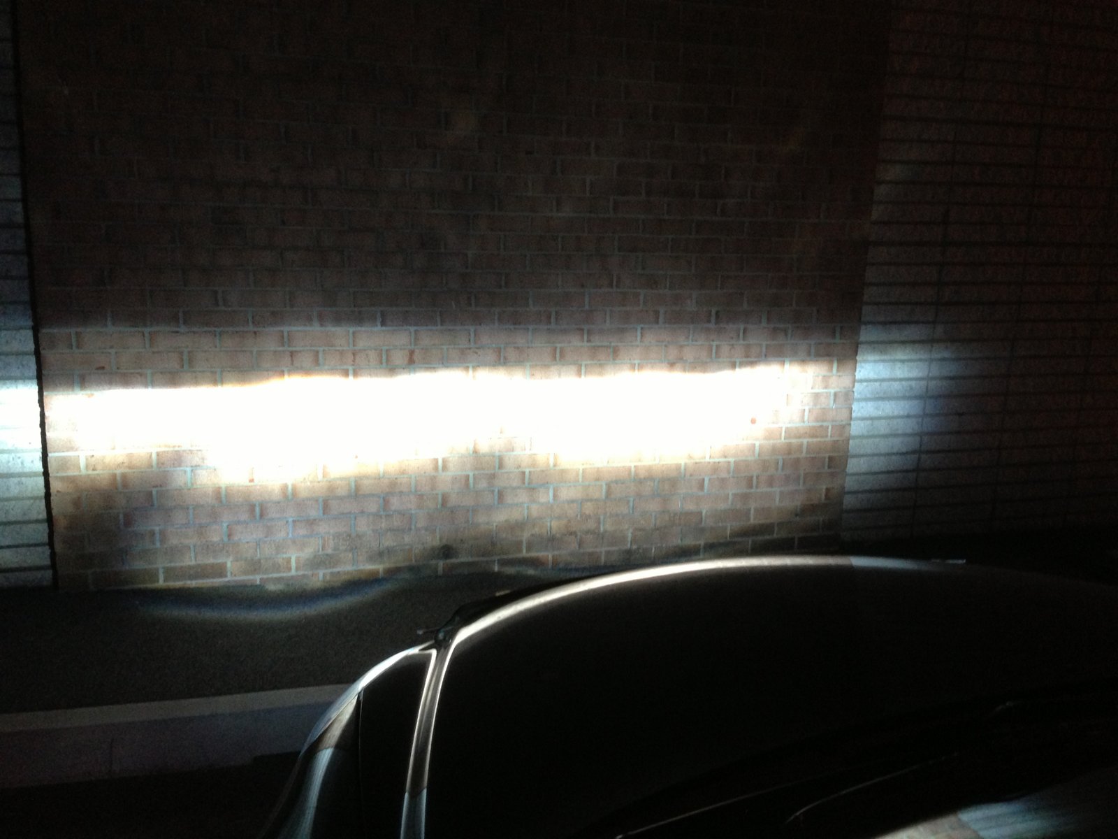

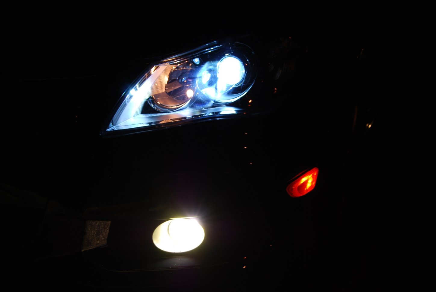

11zukizashi wrote:looks a lot better. Can you shine the hids against a wall and post pics of the headlight cutof?
Sorry it took so long.
The headlights appear much brighter in the photo than in reality in terms of glare. The color is the same whiteness, but with much less glare. Regardless, the photo shows the beam pattern.
