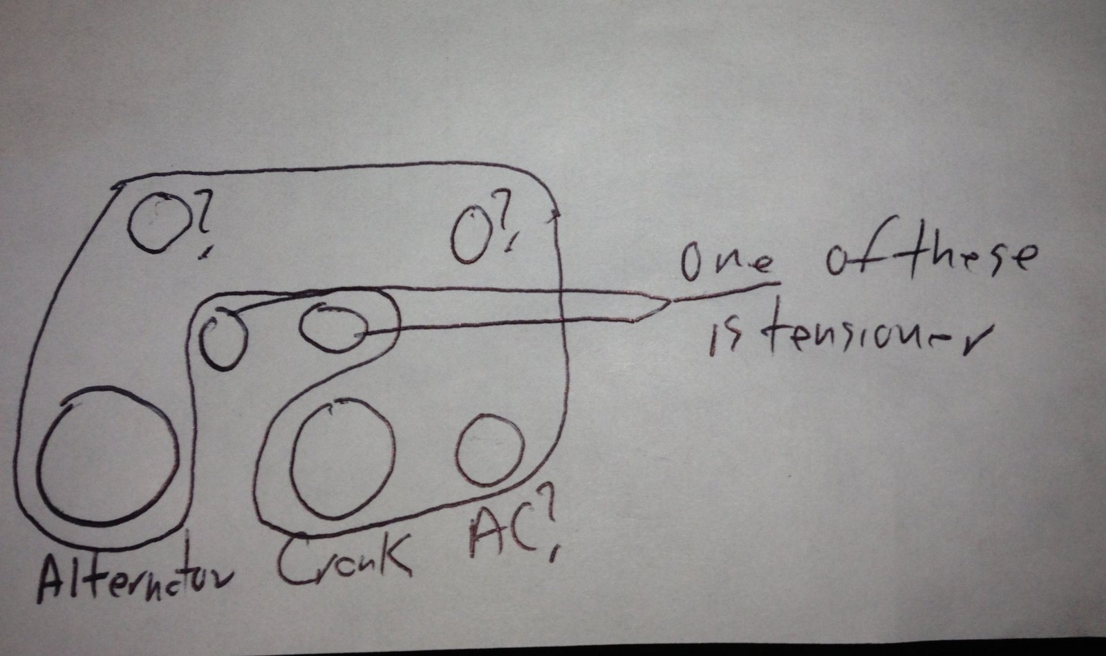

OK. Crude drawing below. (That was first thing I did) I'm not sure I labeled everything correctly but that is the layout. Not horrible but you do need to remove the right front tire and access through the splash guard. There are three press in clips you need to take out and then you can move it aside enough to get in there , or you can take the whole thing off with another couple screws. ( I laid on the ground) turn the the tensioner clockwise with 14 mm wrench to release the tension, then remove the belt. Off is pretty easy. On was a little more work. I got it all in place except for the crank pulley, then I released the tension on the tensioner by holding the rubber handle of a hammer against the wrench for leverage and finally manipulating the belt over. Initially it was off a little on a couple of the other pulleys but I then released the tension again and pushed it on with my hands. Double/triple check then fire her up and check again. Took me about 40 minutes once I got in there. The majority of it was trying to get the new one back on, while taking short sanity breaks and drinking coffee.
Also threw four plugs in. Car has 93,000 miles after 27 months of ownership.

Here's a pic of the Kizashi's J24B engine. Your pic was pretty accurate. I labeled the pulleys as I understand them to be. I am not 100% certain, however, I am quite sure I am correct. The engine does not feature a power steering pump pulley like most older cars because the Kizashi uses an electronic power steering. However, it includes the usuals: A/C, water, crank, alternator, and tensioner. I believe the other 2 are merely pulleys that have no effect other than to route the belt.
Cars these days usually only have one belt called a serpentine belt. In the past, many cars had 2 or 3 belts, mainly because some models of the car did not have A/C. For the models that did, they added the A/C compressor and an extra belt to power it.

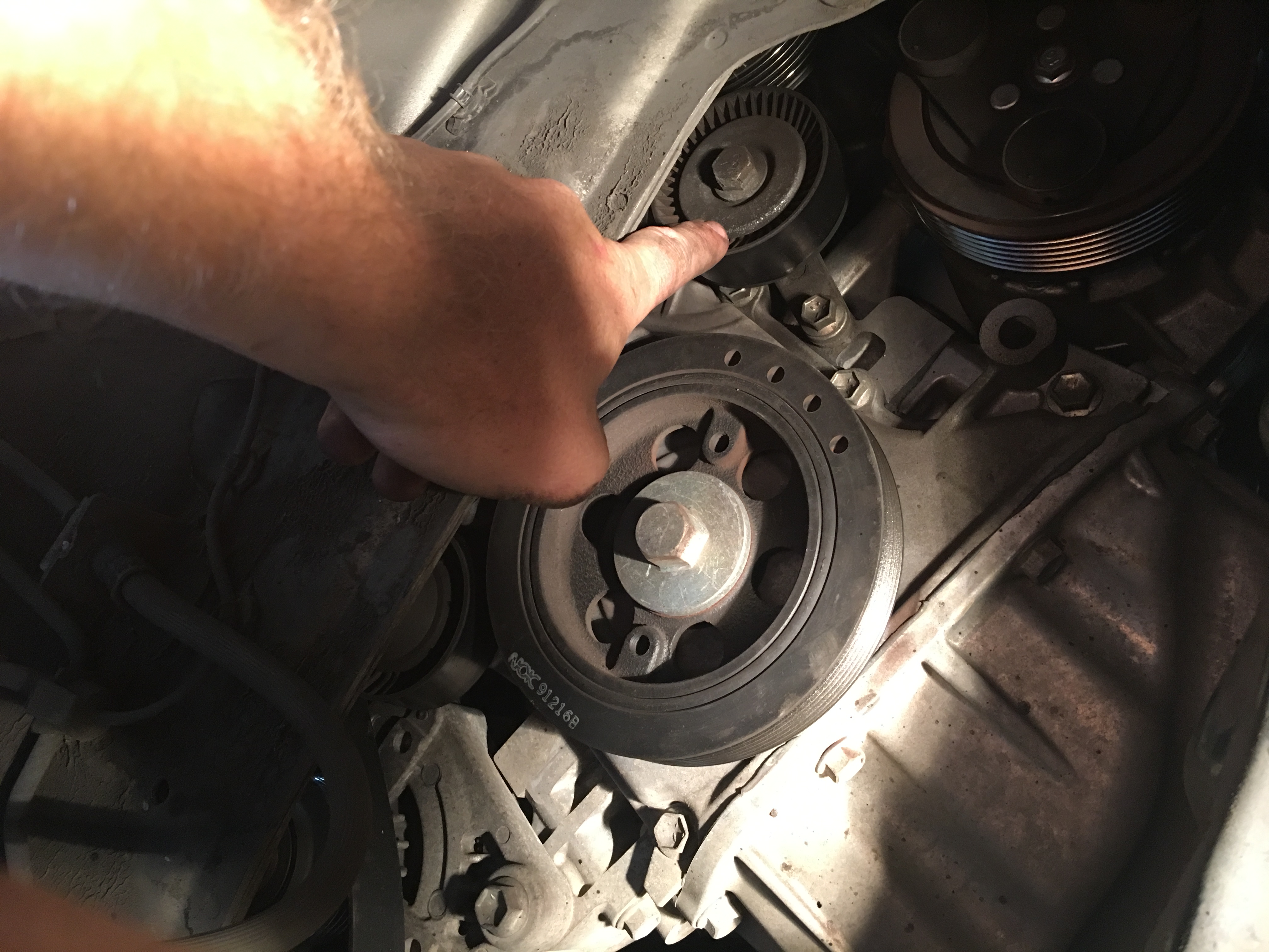

Kuro, your diagram needs an adjustment. The tensioner is actually the one at the just to the right of the crank pulley.
You're right. I was originally going by gmkizashi's diagram. I'll have to correct it a bit later.ProMarinero wrote:Kuro, your diagram needs an adjustment. The tensioner is actually the one at the just to the right of the crank pulley.
- Posts: 171

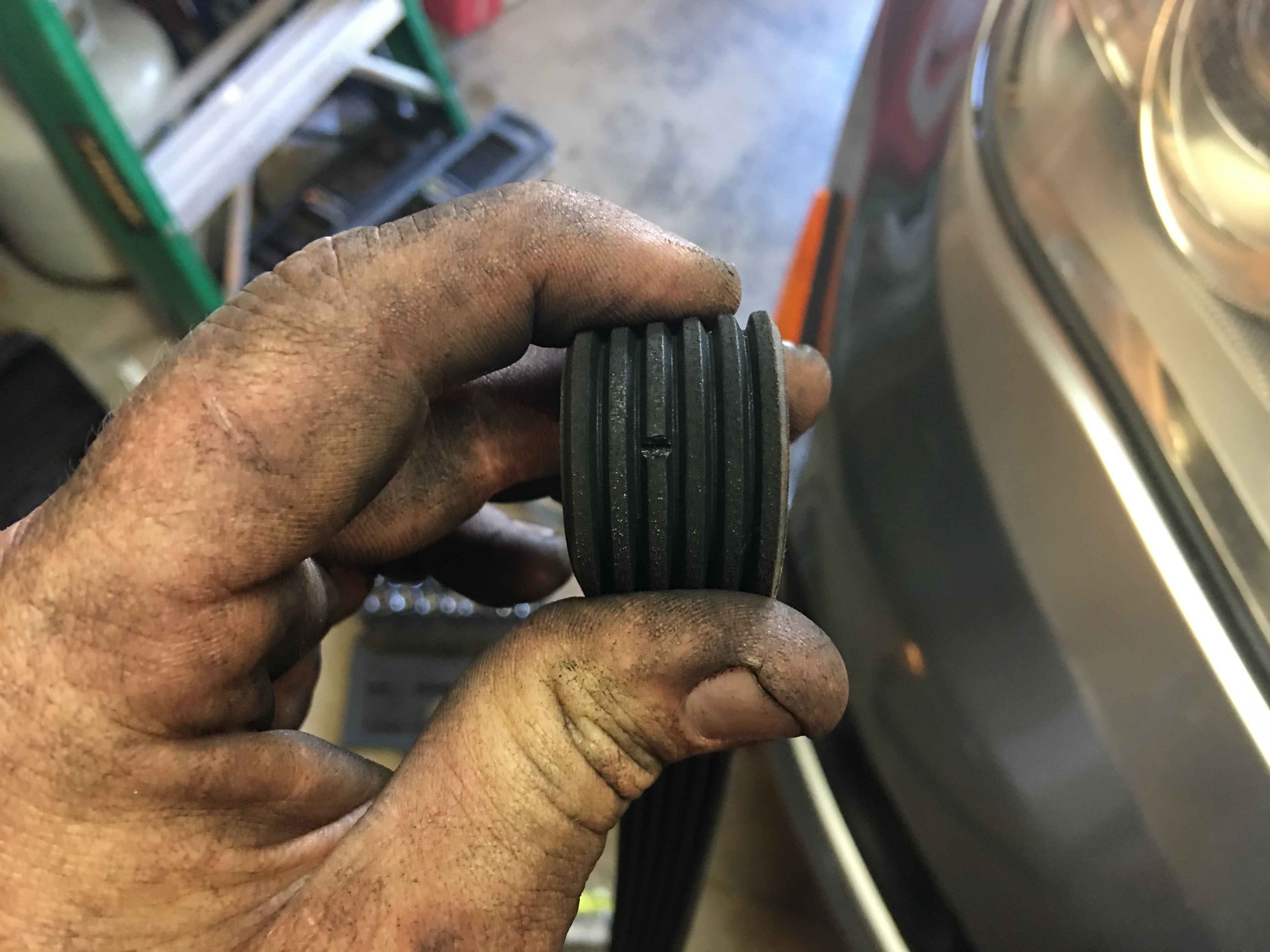

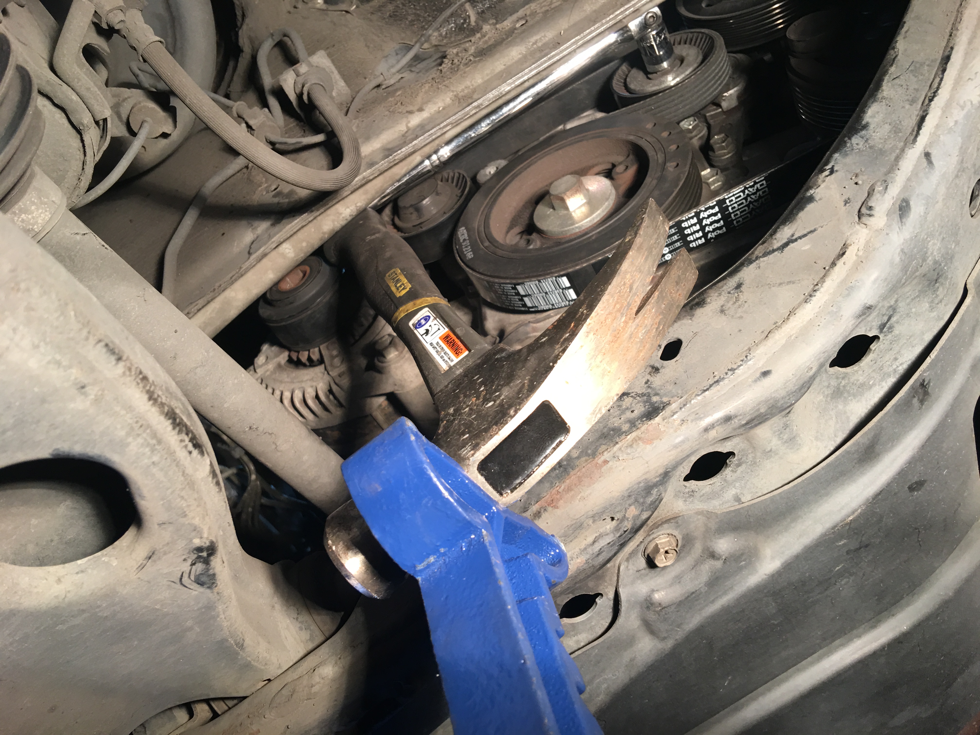

Did this today. It sucked. passenger front tire and wheel well splash guard both have to come off. Like the OP said off was easy. On....... not so much. What I ended up doing was pushing the tensioner all the way up with a hammer and using a jackstand to hold the hammer. Thus freeing up both hands to struggle with the belt on the crank pulley. I can confirm that the tensioner is the one directly above and to the right of the crank as you look at the engine from the passenger side wheel well. The one I'm pointing to in the picture.
I inspected the old on (121,800) miles and found only one crack. So I assume this belt would have been good for another 120K. But who knows and now it's done. Belt was $27 from Amazon.
