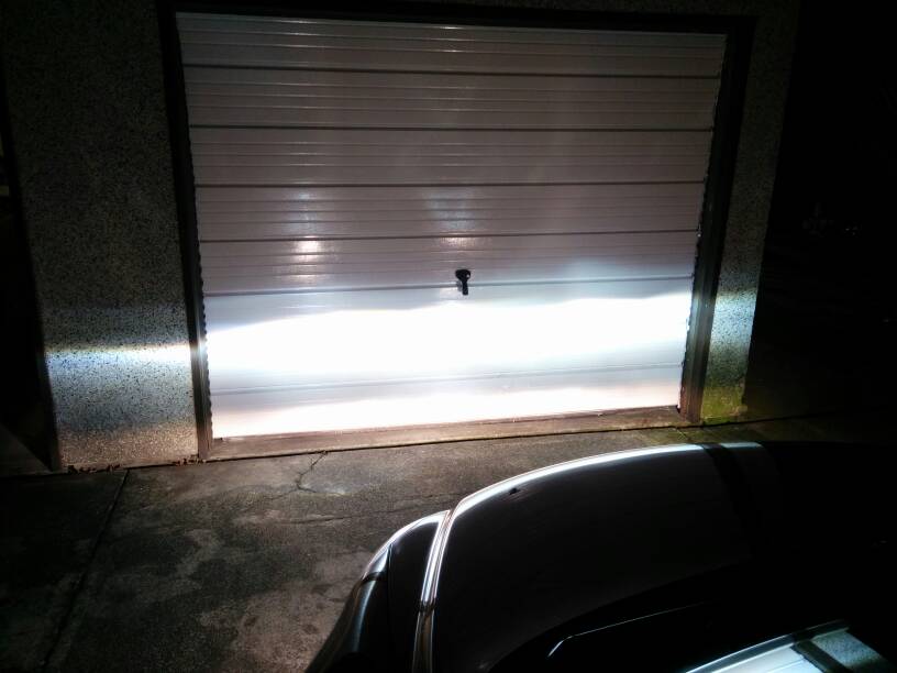

Looking closely, it appears like the H11 bulb is designed to not emit any light from the tip, whereas the H9 is all glass? That might result in oncoming driver's getting irate, but the bottom pic shows a clean cut off for the fog beam pattern. (Perhaps it doesn't affect the Audi due to the fog light lens/ reflector design?)
The Kizashi fog lamp design appears to possibly rely on that tip

Here's a photo of my Kizashi's beam pattern with the HIDs and fogs on. It has a distinct cut off so I believe the fog housing have something built in to deal with glare
[attachment=-1]uploadfromtaptalk1393749519127.jpg[/attachment]
