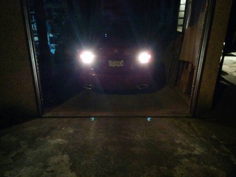

So I bought Sylvania 3497LLBP bulbs (long life) for $4.99/pair at Canadian Tire. They're rated at 565 lumens and 730 hours, making them 23% brighter than P21W bulbs.
I tested them out and the 3497s are marginally brighter. I've attached a picture comparing the two bulbs. The LHS is the 3497 and the RHS is P21W.

I wonder if eyes work like ears in that double the lumens won't be double the perceived brightness - that you need A LOT more lumens for it to actually look significantly brighter.
~tc~ wrote:I wonder if eyes work like ears in that double the lumens won't be double the perceived brightness - that you need A LOT more lumens for it to actually look significantly brighter.
I though about that as well. I figured that the 23% increase in lumens just isn't significant enough to make a difference in practice.
I may try comparing the 3497 bulb to a 1156. It's 41% brighter on paper
