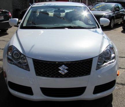

Step 1: Buy a Suzuki Kizashi (any color other then black will work):

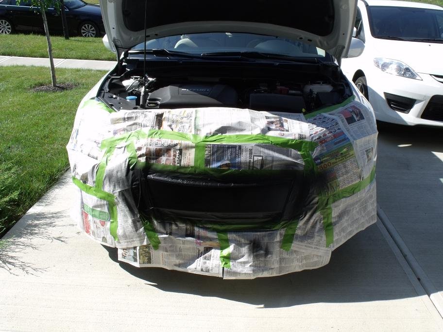

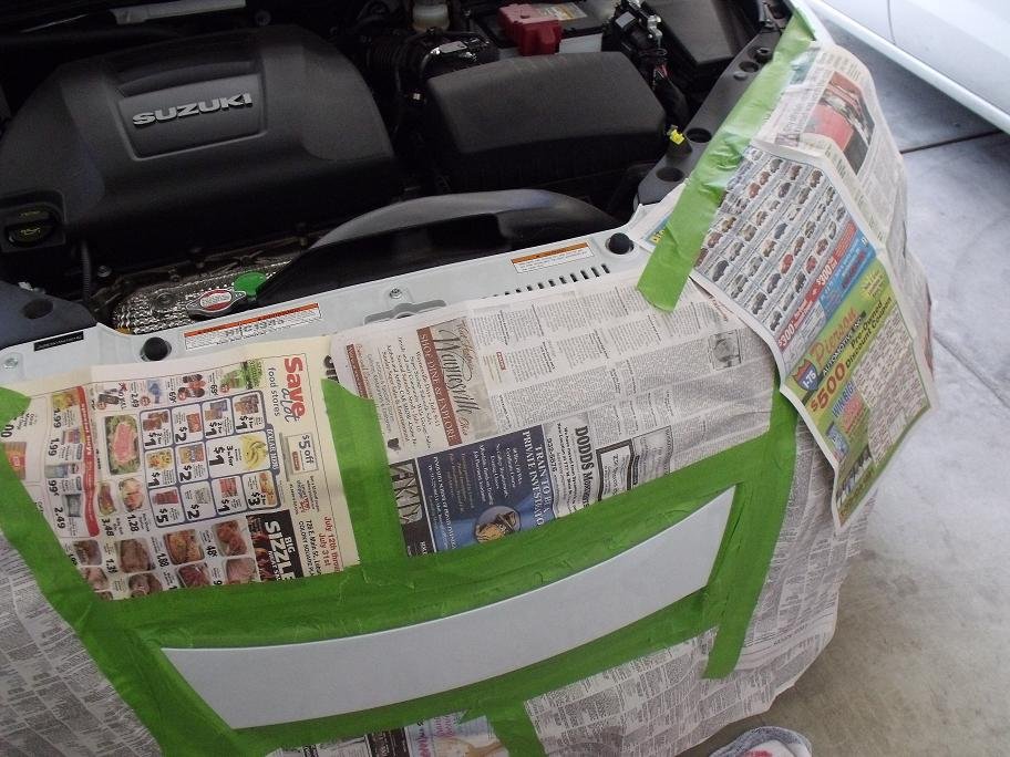

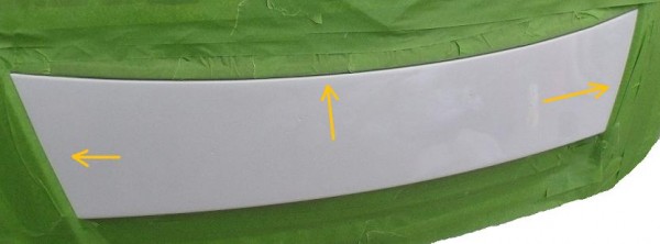

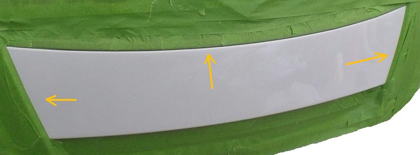

Step 3: Place painters tape on vehicle to create the line desired (tucking the tape under the grille is helpful for full coverage):
Make sure the tape is on completely to prevent the paint from bleeding. I used a credit card edge to push the tape down.

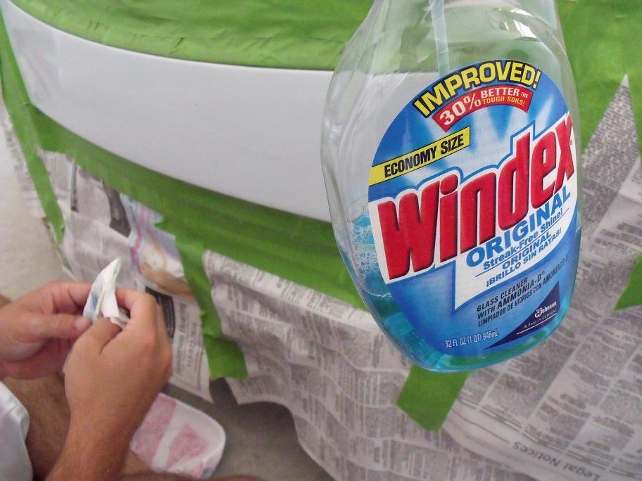

Step 4: Tape newspaper to exisitng tape and vehicle to account for overspray:
You now have an official Nascar with all those adds! You can never have too much coverage go overboard here.

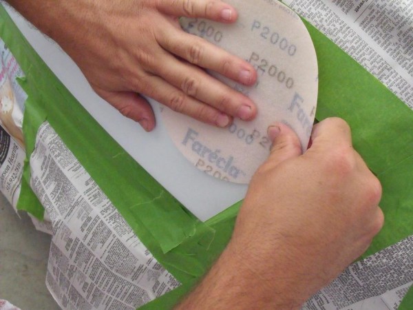

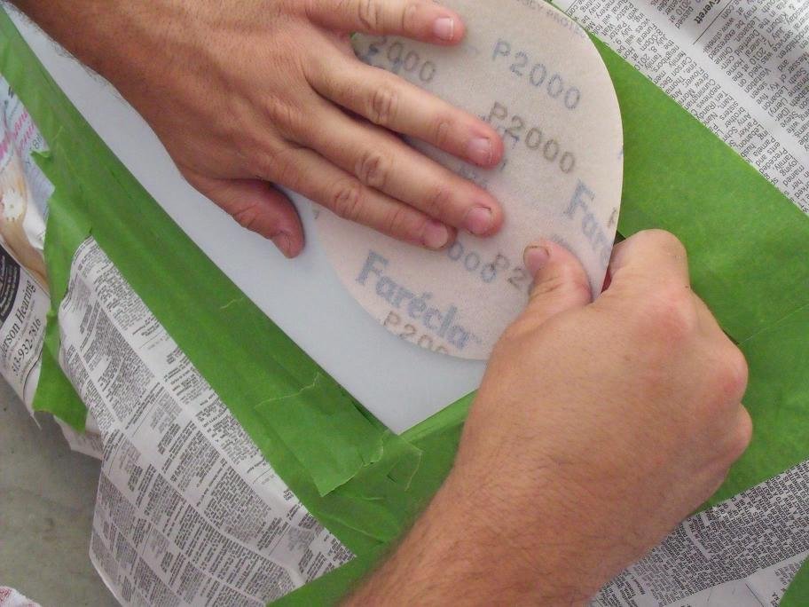

Step 5: Sand bumper lightly to remove any imperfections and to rough up the existing paint:
Step 6: Clean surface with window cleaner to remove any dust and remaining wax/cleaner:

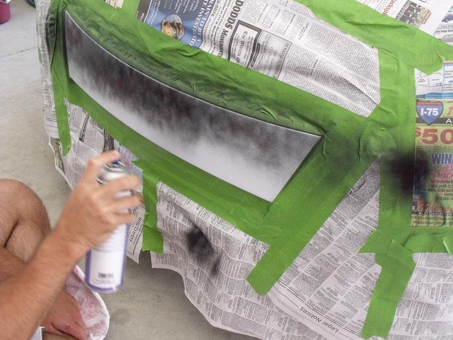

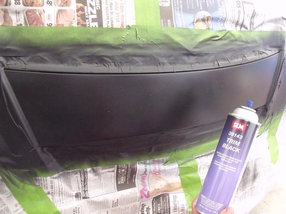

Step 7: Add paint (light passes to prevent dripping and for a more even coat):
It took roughly 9-10 passes to cover the bumper completely and have a consistent color over the entire surface.
Step 8: Move car into sun to allow to dry and to inspect for quality:
I made 2 of the passes with the paint once I had the car in the sun.
Step 9: Remove paper and tape, inspect work:
I felt the paint was dry enough after about 30 minutes to remove the tape. (Times may vary!)

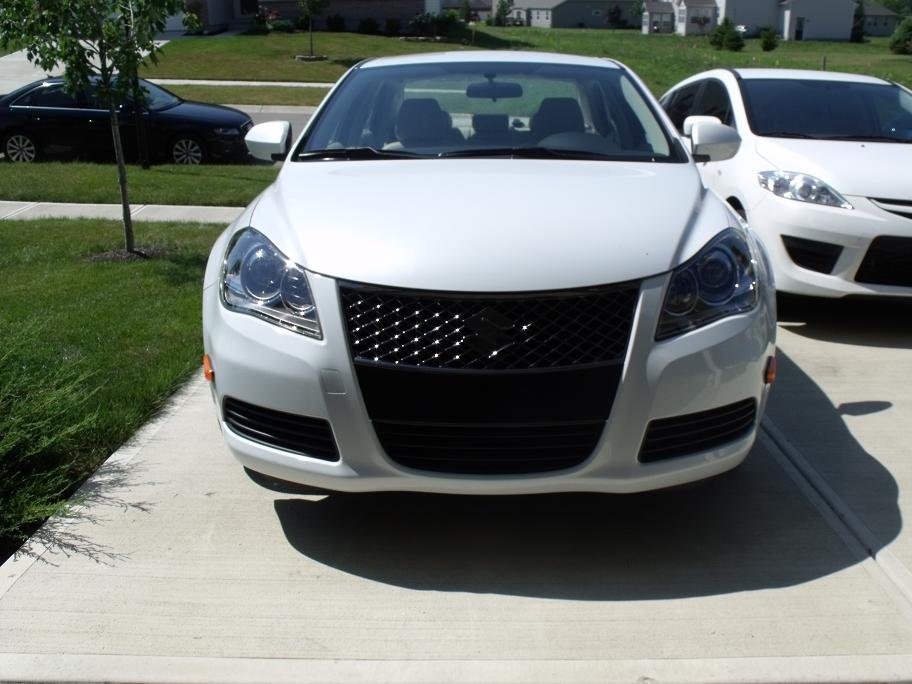

Post project thoughts:

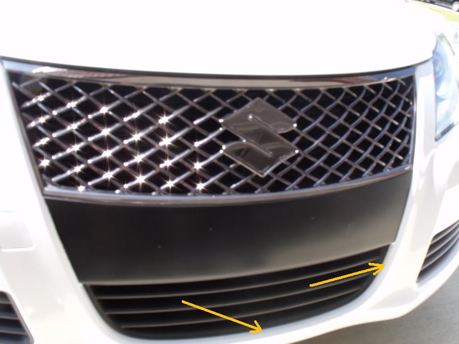

Now that I have completed the first pass of the front end modification I wish I would have also painted the inner lip surrounding the bottom trim piece. (See picture below) While this isn't required, and the finished product looks good without it, I feel it would really complete the look. I am also considering adding a pin-stripe around the entire grille. While I might use red, someone could use black to really sharpen up the edge (in the event the tape bled while painting.)

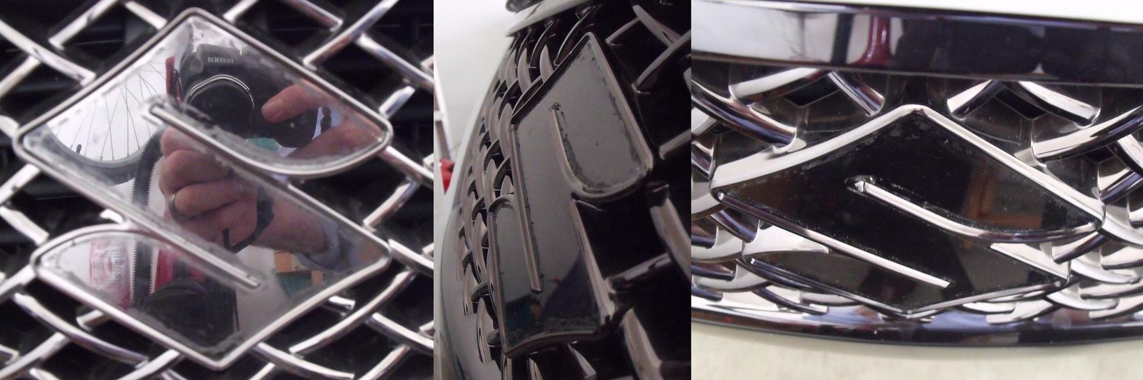

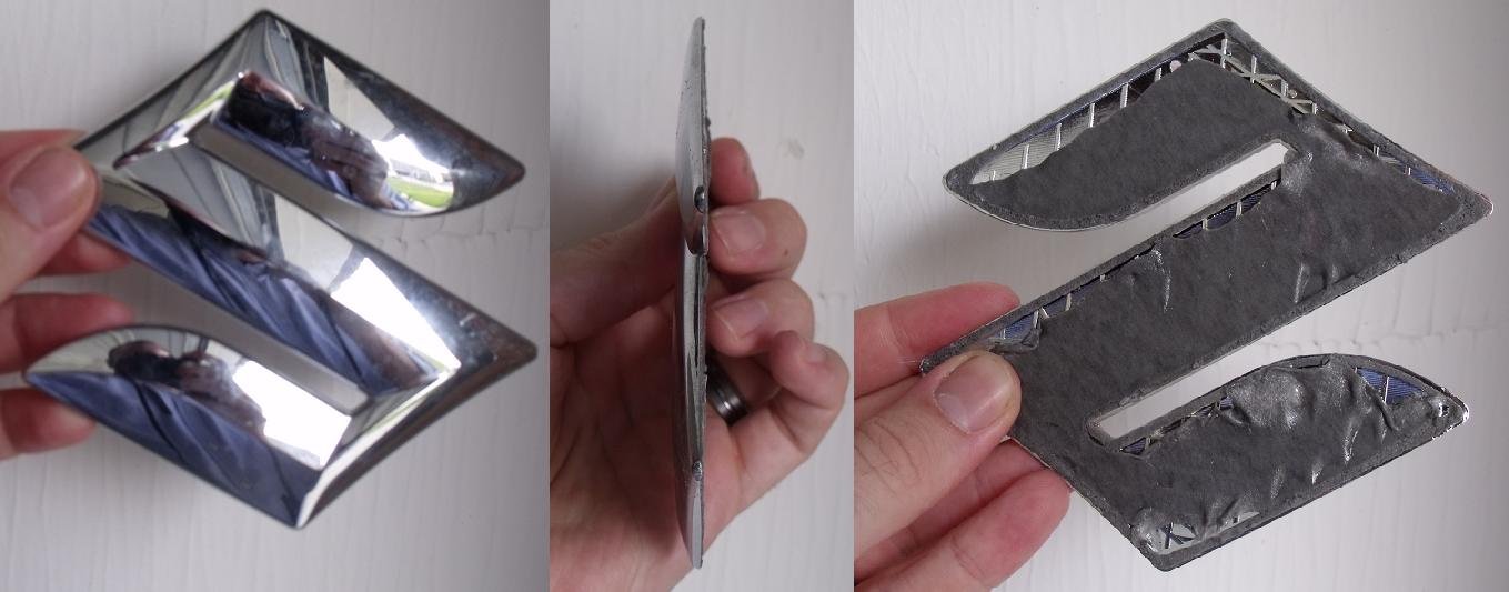

Kizzyohio, can you please post close up pictures (taken from an angle so I can see how deep the indent is) of the front badge? I want to remove the chrome S on mine but not sure yet if I'm gonna like the end result. Thanks in advance.

Sure thing! I'll take a few pics tomorrow and post them. You can see the goo I'm still rubbing off. Like I said it seems to be the hardest to remove (admitedly I haven't been trying really hard...). Look for pics tomorrow evening.

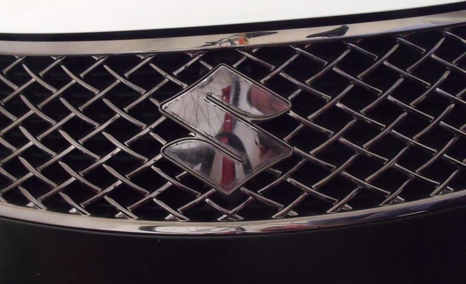

Here are some close up pics of the "S" and the front grille indentation. Be WARNED that there is still adhesive on the edges of the grille. I think I will spend some time removing it this weekend.
Close up of the removed "S":
Full grille:
Close up of the grille without the "S":
Click on any of the above images for a larger view. Hope this helps!!!

Thank you kizzyohio for posting pictures. I really looks nice .
