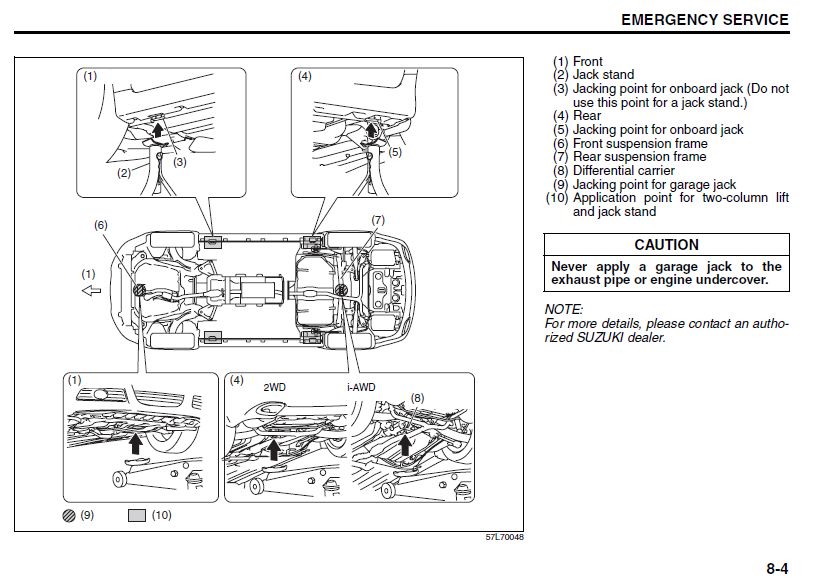

The jacking points on the Kizashi are also miserable. There is no space to jack the car on the boss and then also put a jack stand there. The central jacking point for the rear is so far up that you need a full size garage jack to use it. I had to use both the small hydraulic jack and the scissor jack diagonally on the bosses to put in a jack stand yet on another side. This was the only way I could get two diagonal wheels off the ground simultaneously.

I also want to note the owner's manual is very confusing. It says to not use the boss for the car's scissor jack with jack stands. However, in the graphic, that's where the jack stands are supposed to go. Huh?
See below (taken straight from the owner's manual):
