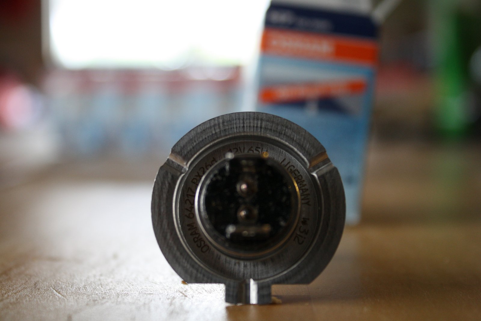

I purchased a pack of 10 bulbs off eBay for $50 USD + shipping. As far as I can tell, these are authentic and made in Germany. The packaging matches the what is shown on Osram's website with all of the correct labels. The labels on the bulb itself are accurate and consistent with the markings on the standard Osram bulb that I have.
Bulb labels
Bulb labels

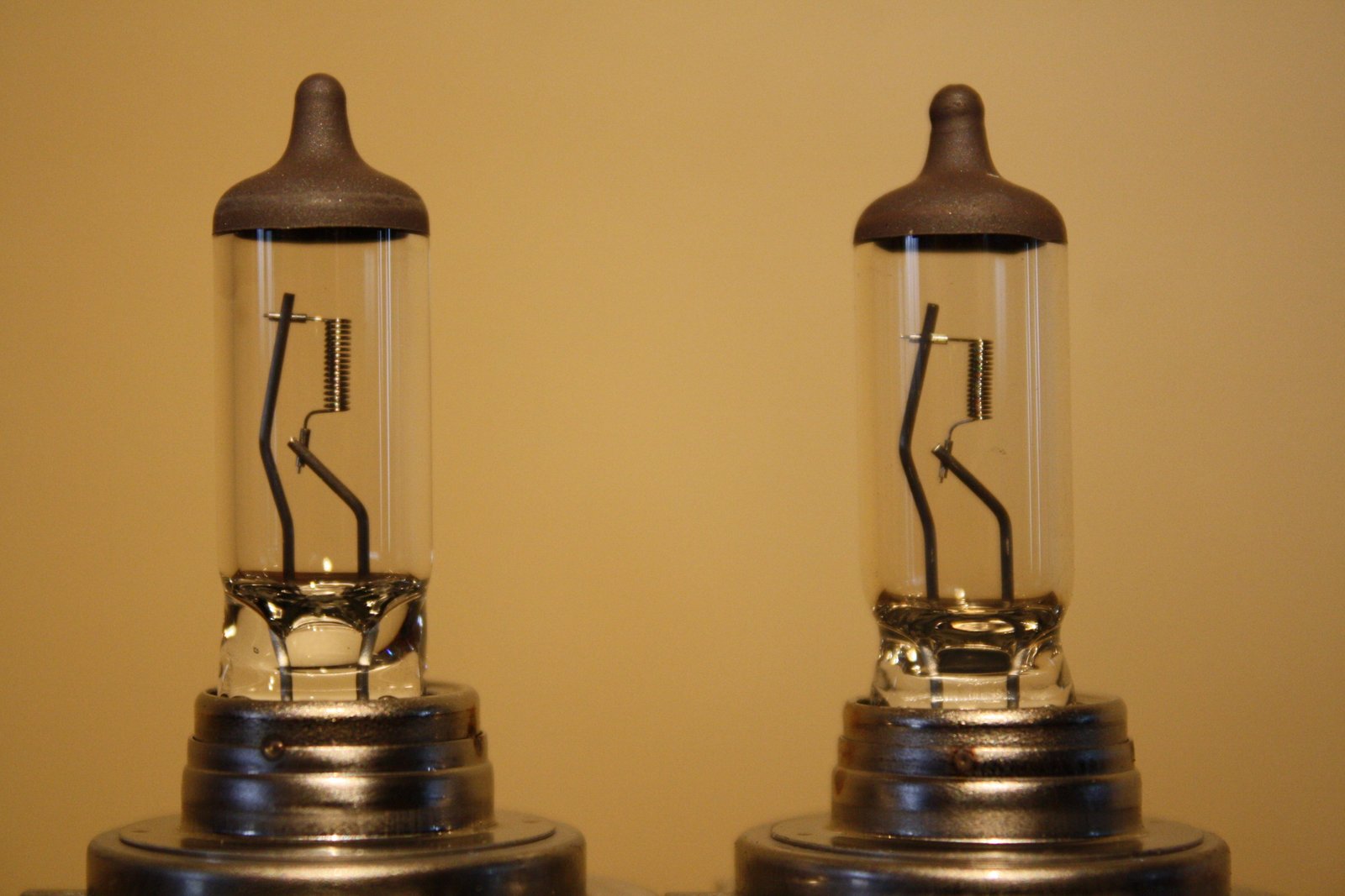

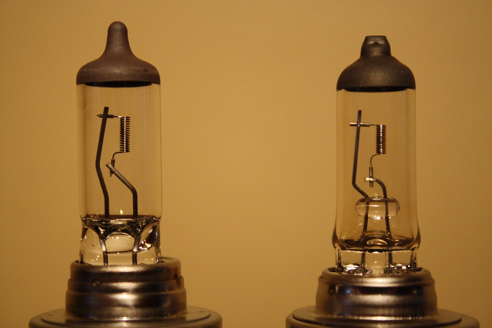

Osram Offroad vs. Philips LongLife
Osram Offroad vs. Osram Standard

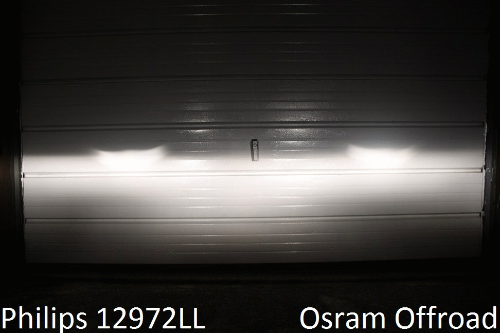

Here are some comparison photos of the bulbs on my GTI. All pictures were taken with the same settings (1/15, F4.5, ISO100, 3200K white balance).
Phillips LongLife vs. Osram Offroad
Philips LongLife Osram Offroad.gif (82.08 KiB) Viewed 17063 times

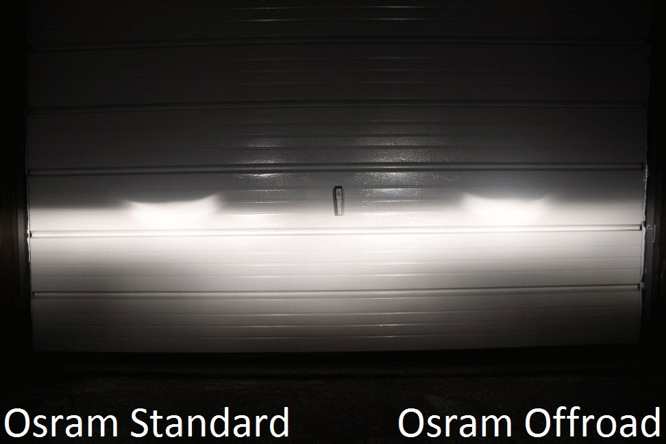

Osram Standard Osram Offroad.gif (79.29 KiB) Viewed 17063 times

It's interesting the Philips long life has the glass bead part way up the filament support - I wonder if that is to reduce the effects of vibration?
I've updated my previous post with another comparison GIF. This time I compared two Philips LongLife bulbs to two Osram Offroad bulbs using the same camera settings as before. The new GIF better captures the improvement

I got a chance to try them out at night and they're a big improvement, even in the city. I wasn't expecting much but there's a lot more light on the road and no glare issues. I'm very happy with the results. I'll post back when the bulbs die
