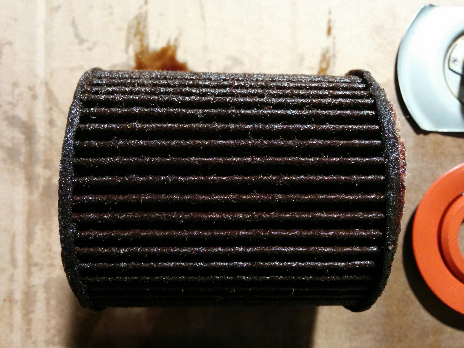

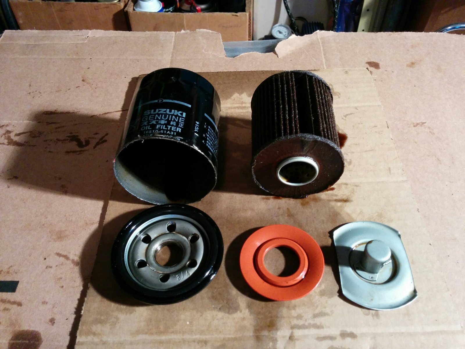

I took a hacksaw to the OEM filter on my Kizashi (PN 16510-61A31, made in Japan) and wanted to share my findings. This filter was installed by the dealer and has ~6,500 km (or ~4,000 miles) with 5w30 synthetic oil.
Here is everything laid out:
The filter case measures 72mm in diameter (base) and 85mm in height.

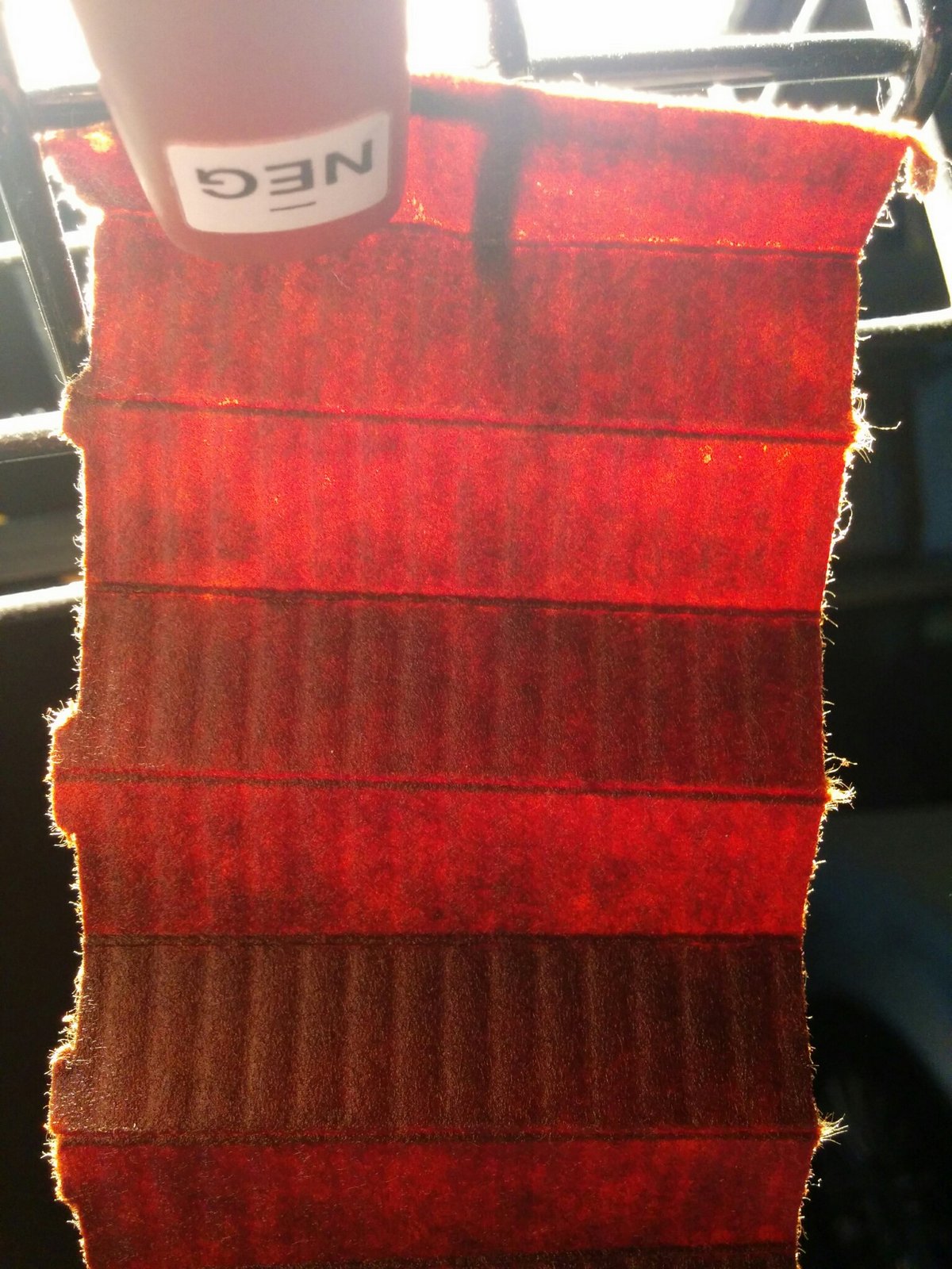

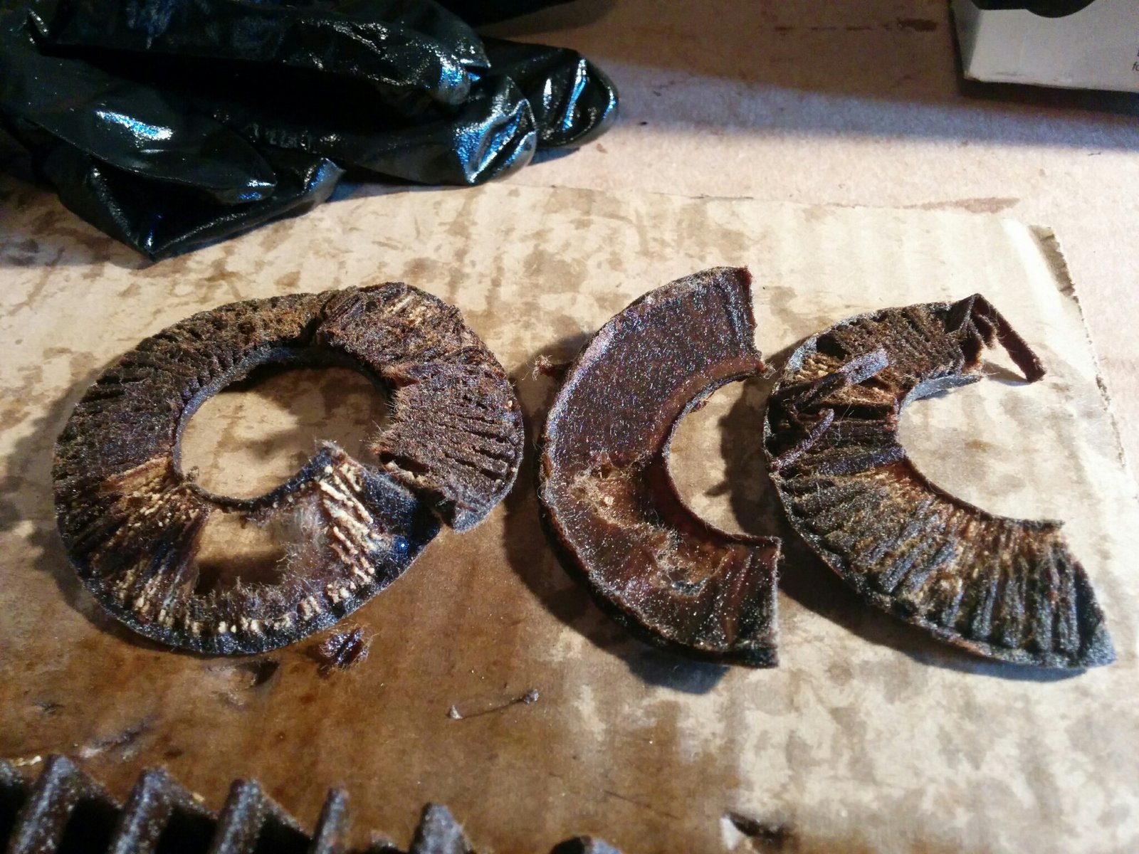

The filter end caps are made of a thin, pourous fiber material. The filter media was securely glued onto the end caps.
Here are the measurements of the filter media:
  • Pleat depth: 1.5cm (0.59")
    Media height: 6.5cm (2.56")
    Media length: 152.4cm (60")
    Media area: 990.6cm^2 (1536 sq-in, 10.7 sq-ft)

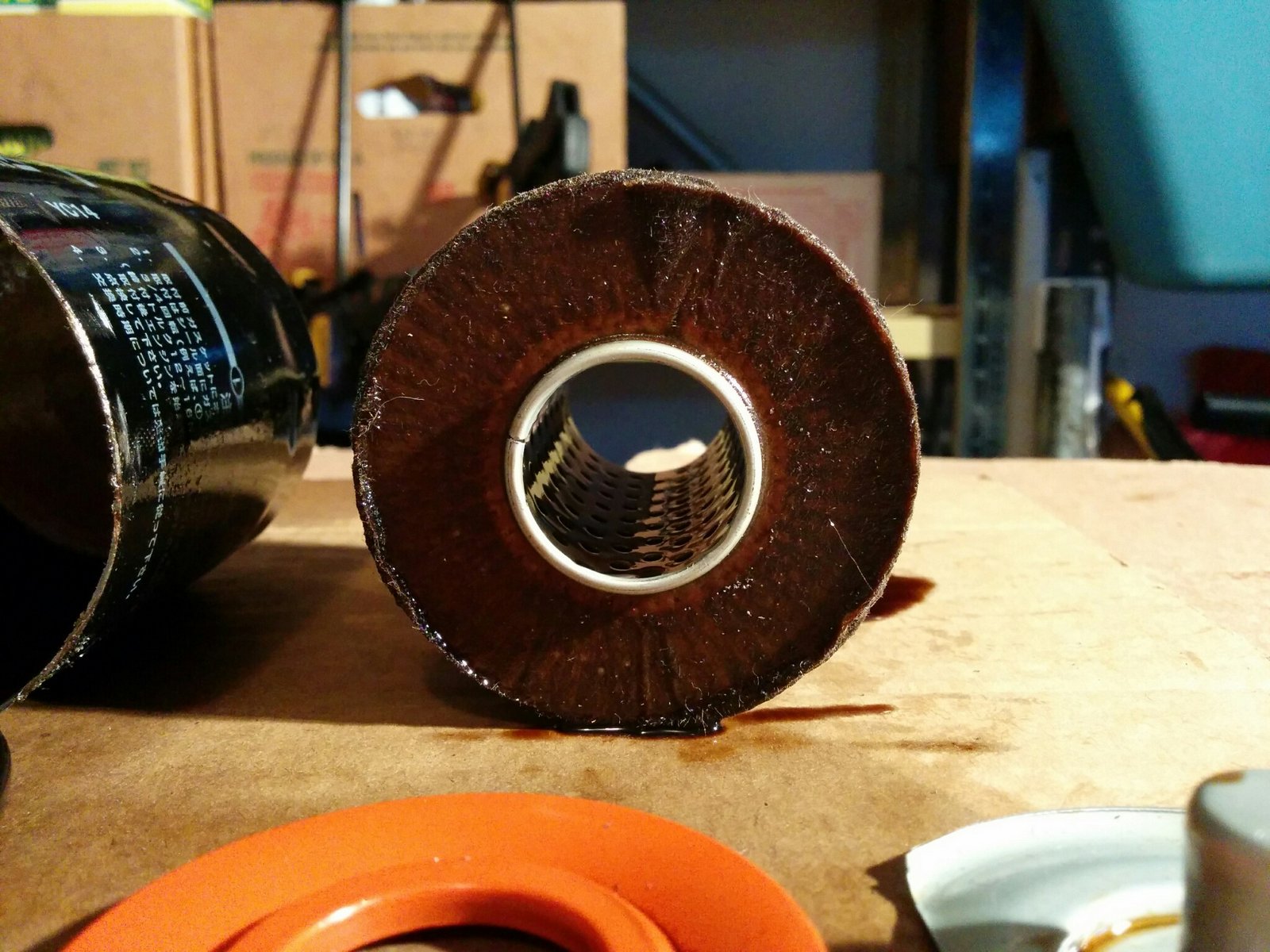

Metal center tube:

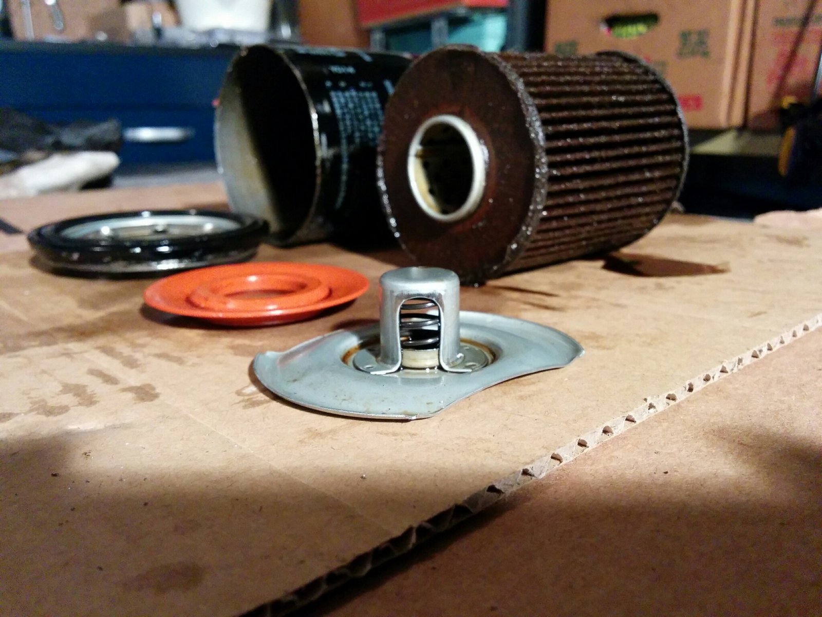

The bypass valve uses a coil spring design that is still functional. The anti-drainback valve is made of silicon and is very pliable. The exterior o-ring is made of nitrile.
Hope this was informative!

Those end caps don't appear to be paper. Looks more like filter media of some sort to me. Cut open a cheapo Fram and you will see paper ends (that collapse).

I did some more dissecting and took a closer look at the filter media and the end caps. The end caps appear to be a pourous fiber material (not paper). The filter media was securely glued onto the end caps.
I also took some more photos. I'll update the first post with the new information.
