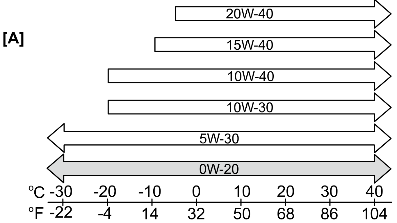

From an online version of the Service Manual:
You're opening a can of worms with that question! The bottom line is, if you stick to the oil specs within the owner's manual you can't really go wrong. You can spend more and get a warm fuzzy feeling.
Use only engine oil of SG, SH, SJ, SL or SM grade.
Select the appropriate oil viscosity according to the chart [A].
SAE 0W-20 oil is the best choice for good fuel economy and good starting in cold weather.

- Kizashi oil viscosity chart (Medium).png (93.92 KiB) Viewed 20921 times
Interesting how the service manual recommends 0W-20. The USDM owner's manual and the engine hood/bonnet placard both recommend 5W-30.
I personally would not use 0W-20 unless the car was driven in subfreezing temperatures most of the time. 5W-30 is also more readily available than 0W-20 so it will not only offer better protection in higher temperatures, but also be easier (and cheaper) to obtain.
