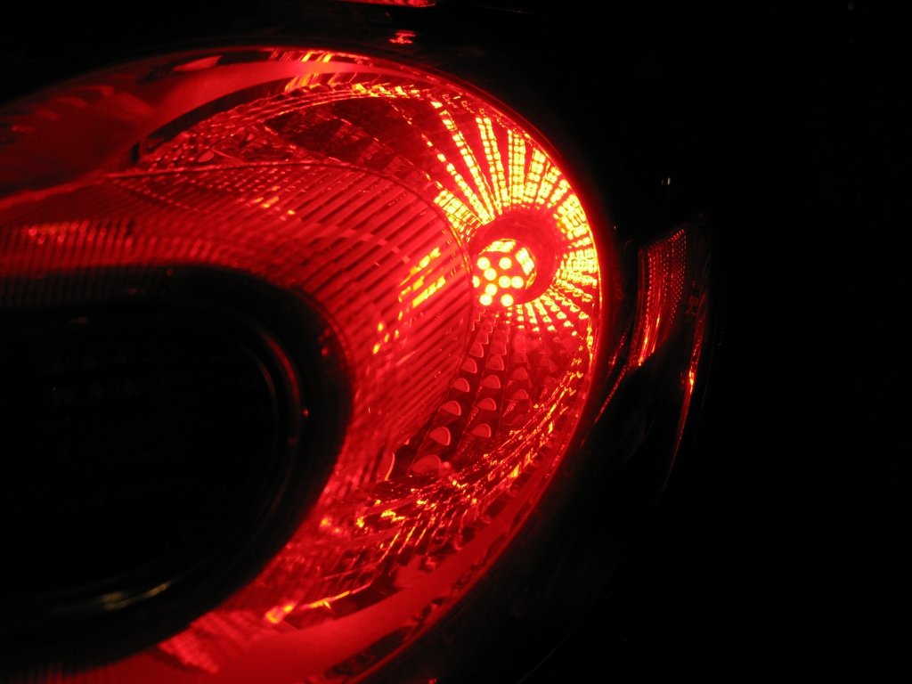

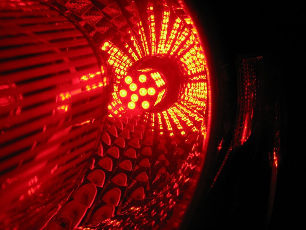

The photos don't really depict it too well, but you can sort of see how the LED bulb illuminates the reflector better than the standard incandescent bulb. The left side (standard incandescent) has dark spots in the reflector while the right side (LED) doesn't.

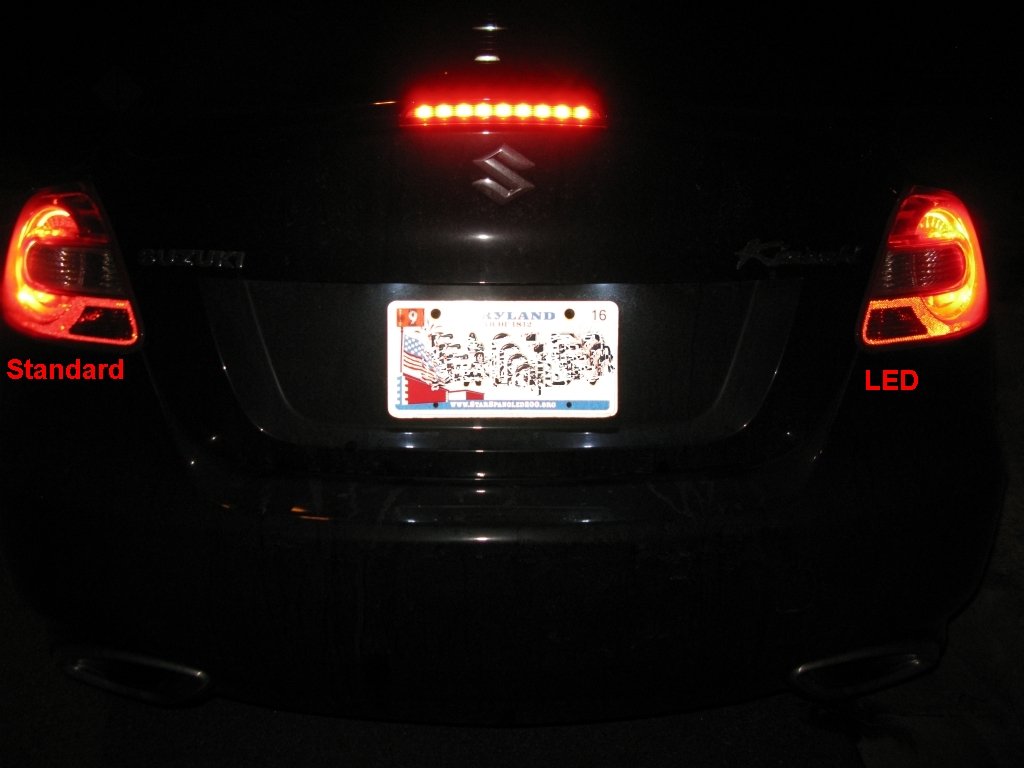

Tail lights (No flash). Notice that the right side has less dark spots or shadows.

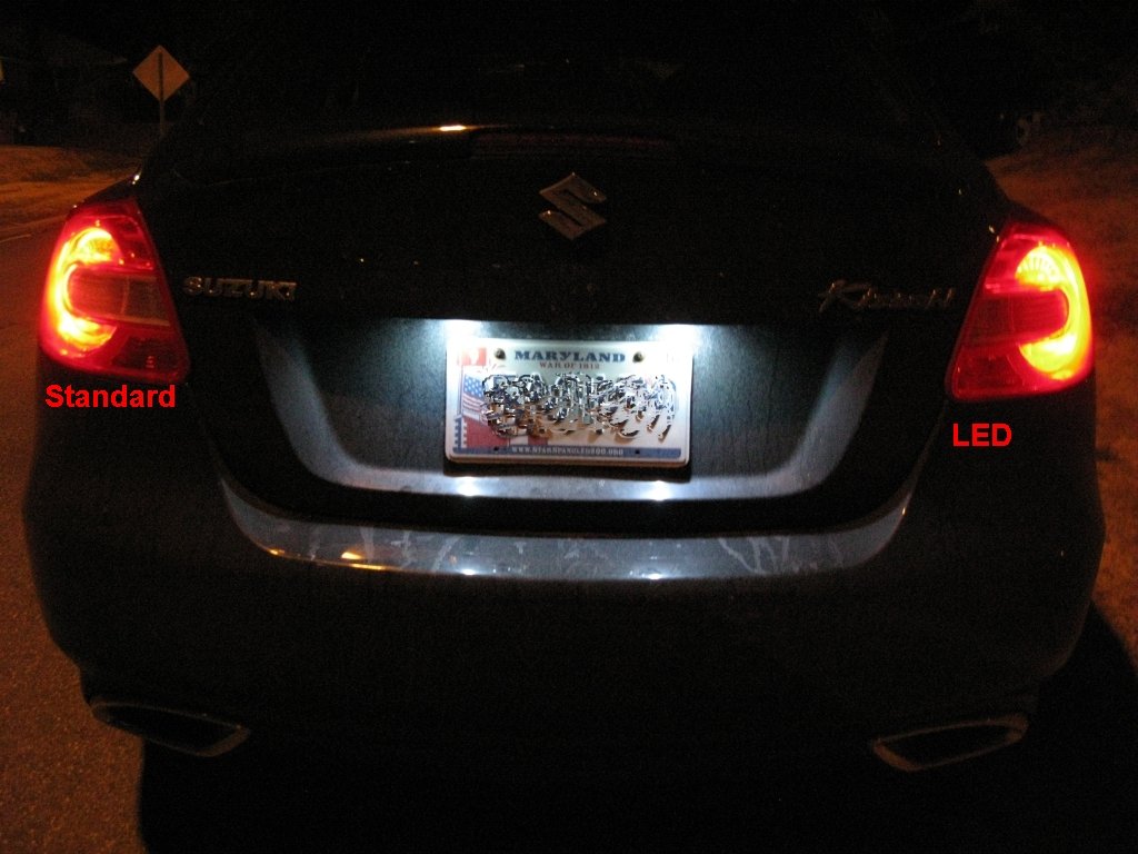

Brake lights (Flash). The difference in the dark spots/shadows is even more noticeable.
rear LED.jpg (93.81 KiB) Viewed 16434 times
rear LED close.jpg (127.75 KiB) Viewed 16434 times

Lumen ratings aside, these LED bulbs look brighter, but not by much. I'd say like 30% brighter but they definitely work to better illuminate the reflector more completely. The tail/brake lights look brighter because of it. That's what I was trying to show in the photos.
