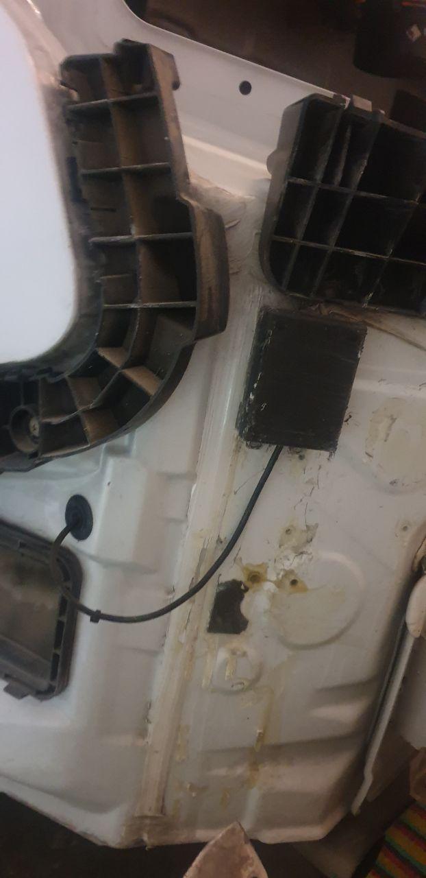

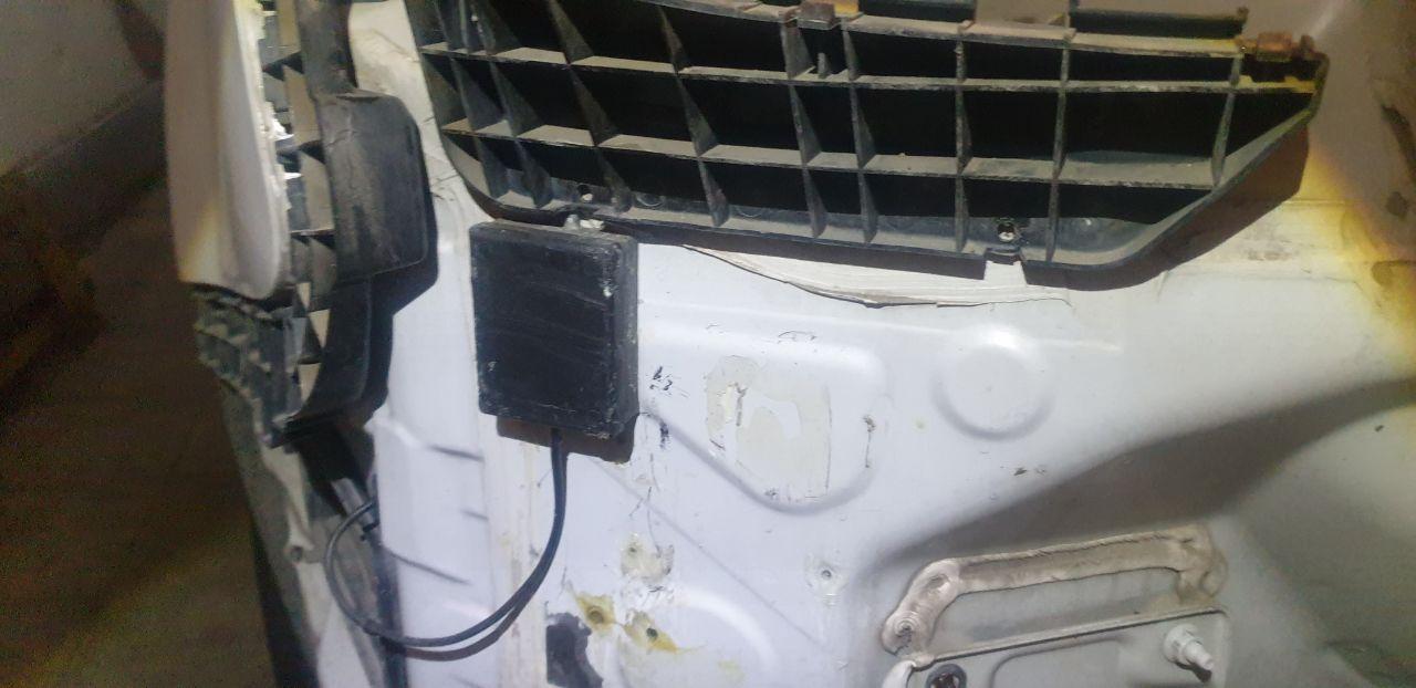

microwave has these pros:
- long-range
- no need to drilling rear bumper to install sensors. microwave signals can pass plastic.
- can work well in fog and rain situation.

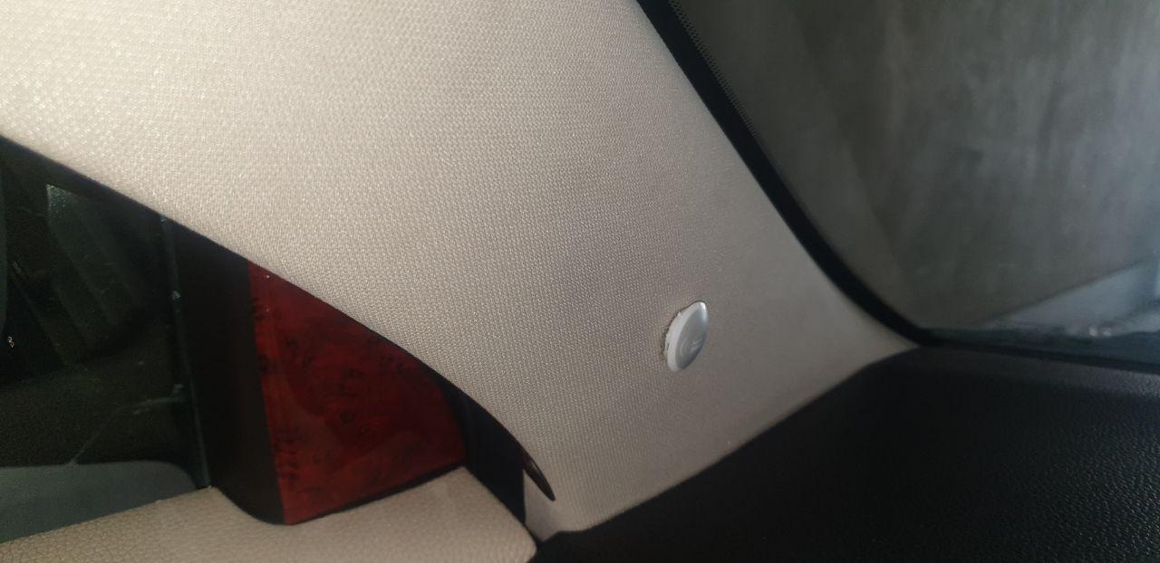

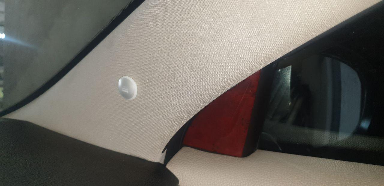

In order to install the unit, you have to remove the rear bumper and install sensors as shown in pictures

Curious how this worked out for you? How does the blindspot monitoring alert work? Does it beep? is there some kind of visual feedback you have if someone is in your blindspot?

johnhenrydale wrote:Curious how this worked out for you? How does the blindspot monitoring alert work? Does it beep? is there some kind of visual feedback you have if someone is in your blindspot?
same as other microwave BSD systems, yes when speed above a specified threshold and system detects an object with a higher speed approaching your car led turn ON on that side of the car and if you press turn the switch on that side too, led flashes and beep generated by the system to alarm you.
this product does not have a side mirror led but others have this led too.
