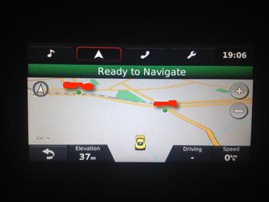

Hey guys,

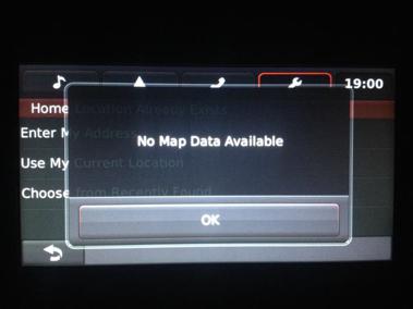

Thought I share a problem (and solution!) I unexpectedly encountered today .. when I started the car for a work lunch break, the Garmin unit surprisingly reset itself - it was almost as if someone had disconnected the battery. The only thing that automatically updated in a minute, was the time, presumably via the GPS signal. I had to reprogram the radio stations, sound settings, bluetooth etc.
But the biggest problem was the Garmin had "lost" its maps ... the Nav simply wouldn't fire up ...
... so don't bother even trying to re-enter the Home Address ...

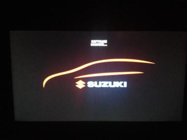

Anyway I rang Suzuki Australia's help line and left a message, not expecting much, but to my pleasant surprise they rang back within the hour ... they were a bit perplexed by the problem, and suggested I reinstall the software update via the Suzuki Garmin website (I had done the SD card procedure thing previously and successfully).
Just to tell you that did the trick ... so in future if you come across this problem, just update the software. To make things easy, I've left the SD card (preloaded with the software update) in the car with a printout of the instructions from Suzuki Garmin website, so there's an immediate fix by sticking the SD back in the unit if this problem happens again (I hope it doesn't!!!).

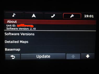

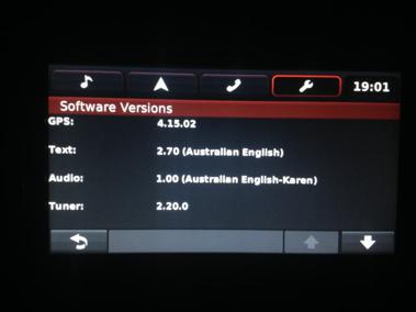

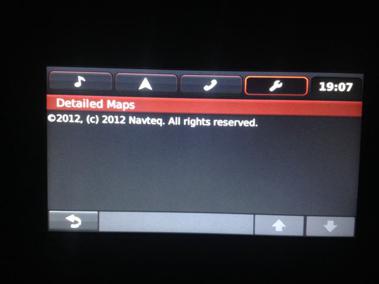

The interesting thing was prior to the SD card update again, I noticed the version of the software had reset itself back to v2.7, when the latest software was 3.9:

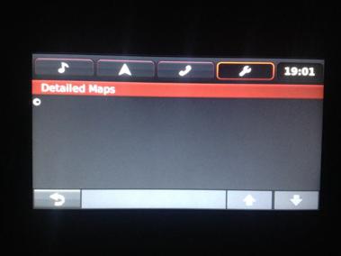

No maps were available at that stage before the update:

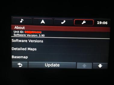

And after the update .....
... to version 3.9, the maps thankfully returned:
Finally, in case you're wondering why I haven't updated the 2012 maps, the local Suzuki dealer actually recommended not to waste money on the update until the maps were at least 5 years old because at most a few streets have been added since ... well that's a nice change of honesty from a dealership!
