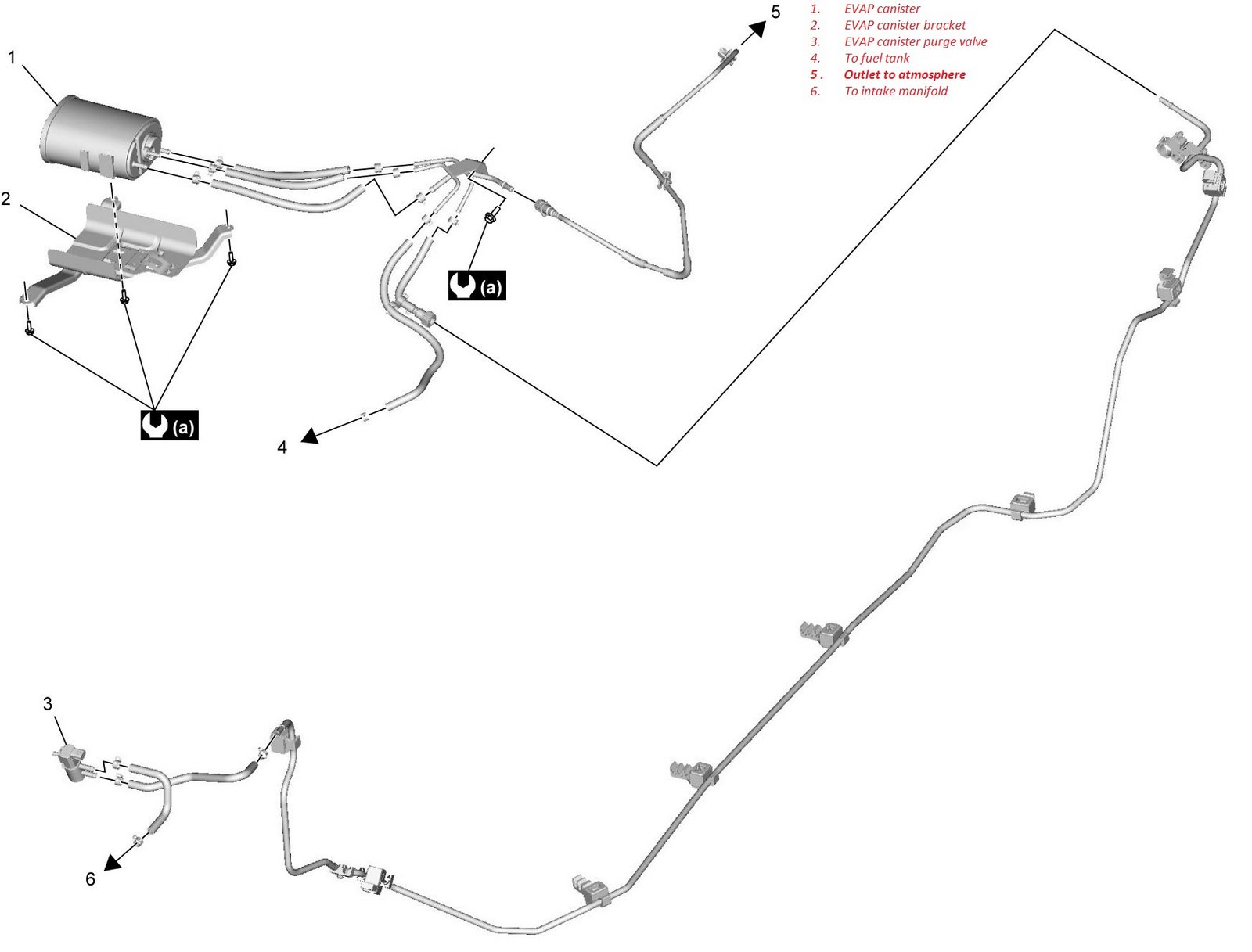

Hmmm, I wonder if my 2013 (tagged 08/12) already has this filter from the factory, or if it is immune due to some other design change?
A pic of the evap canister plumbing. It's located above the rear diff on AWD models (or where the diff should be on FWD models ;) )
I'm not sure exactly where the outlet (5) is located on the vehicle? Has anyone found it?
Evap system.jpg (104.96 KiB) Viewed 8277 times
