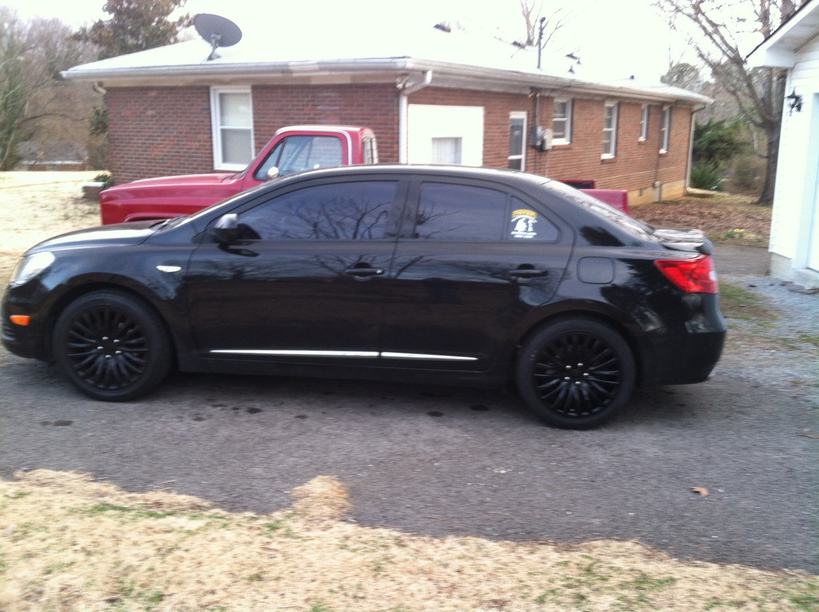

A few years ago I decided to try and darken my wheels with the Dupli-color black chrome kit. Needless to say that didn't work, so I decided to take them all the way down and shot them with a coat of black sand-able primer. Hit them with 800 grit sandpaper, to make sure they were all smooth. Then I hit them with another coat and used 1800 grit. Next I hit it with three coats of the color from the kit, and two coats of the clear. I like the stock wheels have a totally different look. All in all, about $50 to do all four wheels. After two years, the only scuffs are from sliding into a curb while ice was on the road. It has stood up to tire changes and rotations.
Black Wheels.JPG (342.92 KiB) Viewed 17982 times
