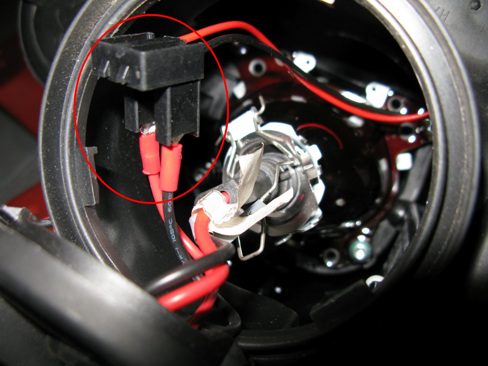

Ok. So I'm stuck. Everything is mounted but I can't figure out where this plugs into from the HD harness and relays? Anyone?
DeL
Posts: 5275
delusional29 wrote:Ok. So I'm stuck. Everything is mounted but I can't figure out where this plugs into from the HD harness and relays? Anyone?
DeL

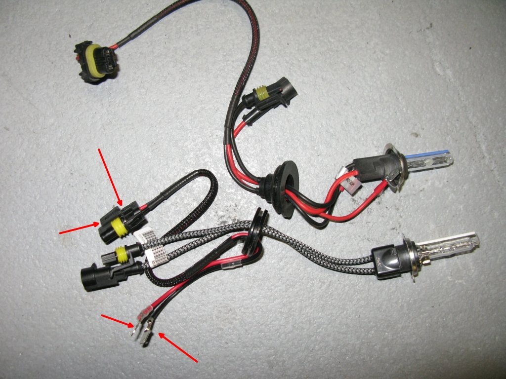

As the tag states, that's for the OEM Input meaning the headlight control. It needs an adapter that plugs into one of the car's headlight harnesses that the H7 bulb would otherwise connect to. Because the Morimoto kit uses an HD Relay harness to power the kit, you don't need to connect the ballasts to each of the car's headlight harnesses for power. However, you still need to connect to at least one of the harnesses to control the kit's function (to turn on and off the headlights). There should be only one of those OEM Input harnesses and there should be a separate adapter that connects to it that fits into a female H7 harness inside the headlight. Going back through my many installation photos from my kit, I found a picture of the adapter I'm talking about. You need to plug the labeled adapter (pictured below) into the harness you photographed and then connect the small red and black blades into one of the headlight's female H7 harnesses.
input harness.jpg (163.46 KiB) Viewed 37457 times
input harness connected.JPG (233.83 KiB) Viewed 37457 times

Thanks. I ended up figuring it out but your new photos confirm that I did it right. I actually looked up how to install on YouTube and they all said to connect to only one headlight out put so that the relay can get the signal to activate.
Turned out, I removed the adapter in BOTH grommets. Snip, snip! I misunderstood your instructions that you didn't need that part. Turns out it was only the right side you didn't need.
Luckily when I snipped it I saved the parts so I crimped it back together. (I have the proper tools and connectors so it was easy).

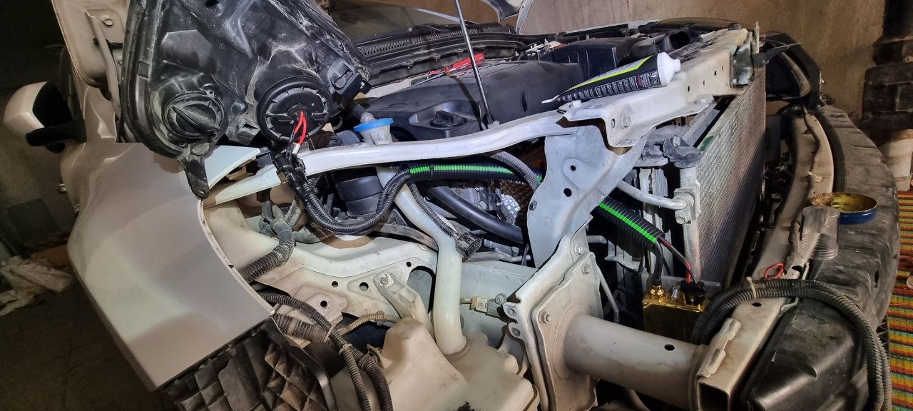

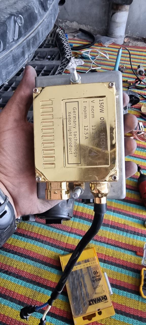

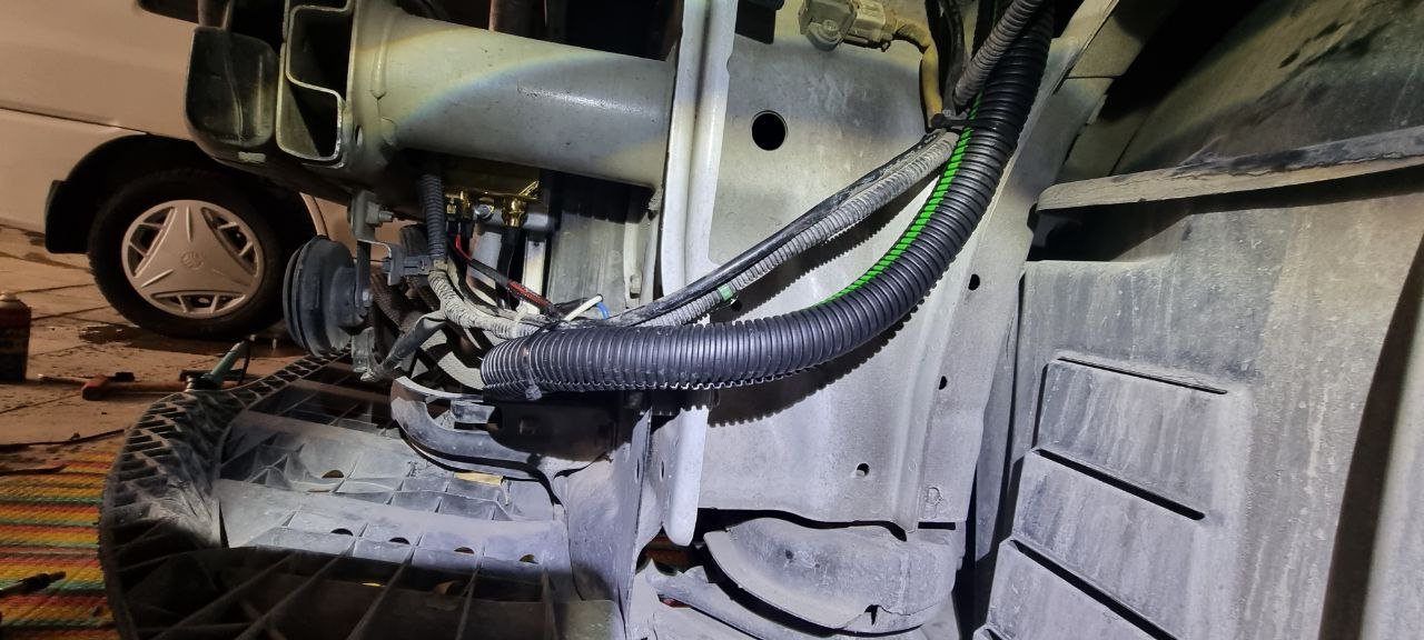

theoretically, we do not need RELAY and separate power from the battery we can use power from inside of the headlight because the car can drive up to 15A for each headlight. (according to the service manual) still, I think it is better to use separate ground connected to chase and directly connected to Blast to be on the safe side. that's what I did for the past 5 years no problem so far.
finding a good place to mount Blast is challenging for me until I found this bracket in front of the AC radiator.
