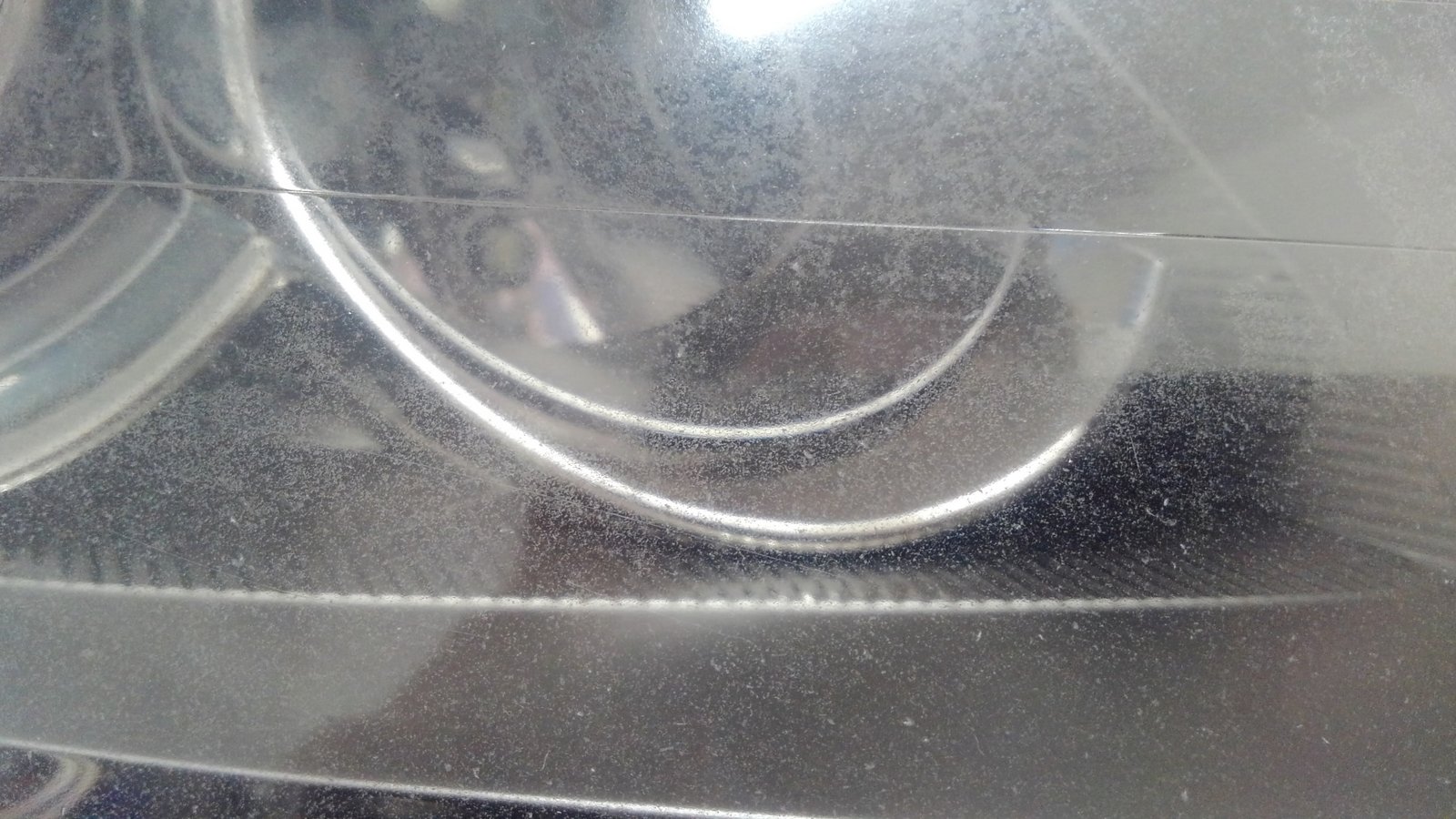

Recently, I had to revisit headlight polishing as the UV damage got worse on my headlights. It's an inevitable aspect of plastic headlights on cars that are often parked outdoors during the daytime. It just happens with time. While my headlights never got too bad (due to regular light polishing at car washes), the damage seemed to get worse between the treatments given the age of the vehicle and constant exposure to the California sun as my vehicle is now always parked outdoors with little or no shade.
Below is a picture of the headlight prior to any treatment.

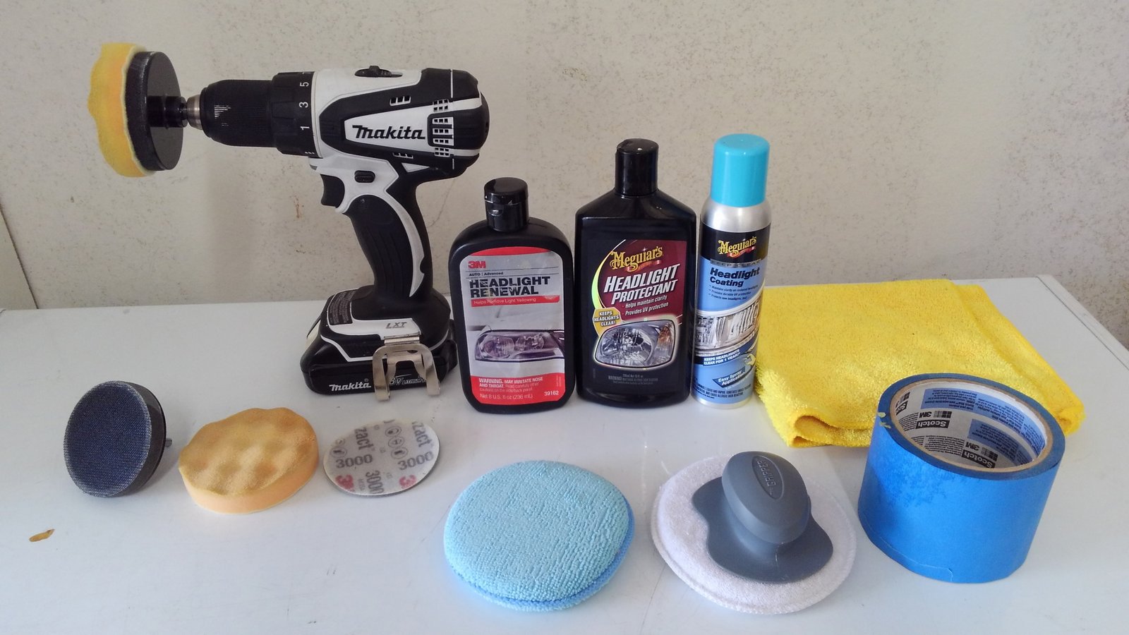

I decided to do a combination of procedures utilizing products from both Meguair's and 3M. Some of the materials were sourced from kits I've used on other cars while others were separately purchased products.
Below are all the materials I used.
- A cordless drill
- A velcro drill adapter to mount pads and discs (included in a 3M headlight polishing kit)
- A foam polishing pad (included in a 3M headlight polishing kit)
- A 3M Trizact 3000 grit sanding disc (included in a 3M headlight polishing kit)
- 3M's Headlight Renewal polish
- Meguiar's Headlight Protectant
- Meguiar's Headlight Coating spray
- Microfiber polishing pad
- Terry cloth polishing pad
- Microfiber towels (for wiping off all products after each application)
- Masking tape

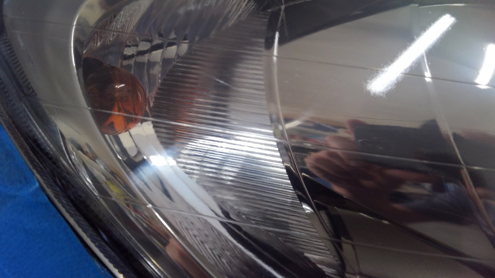

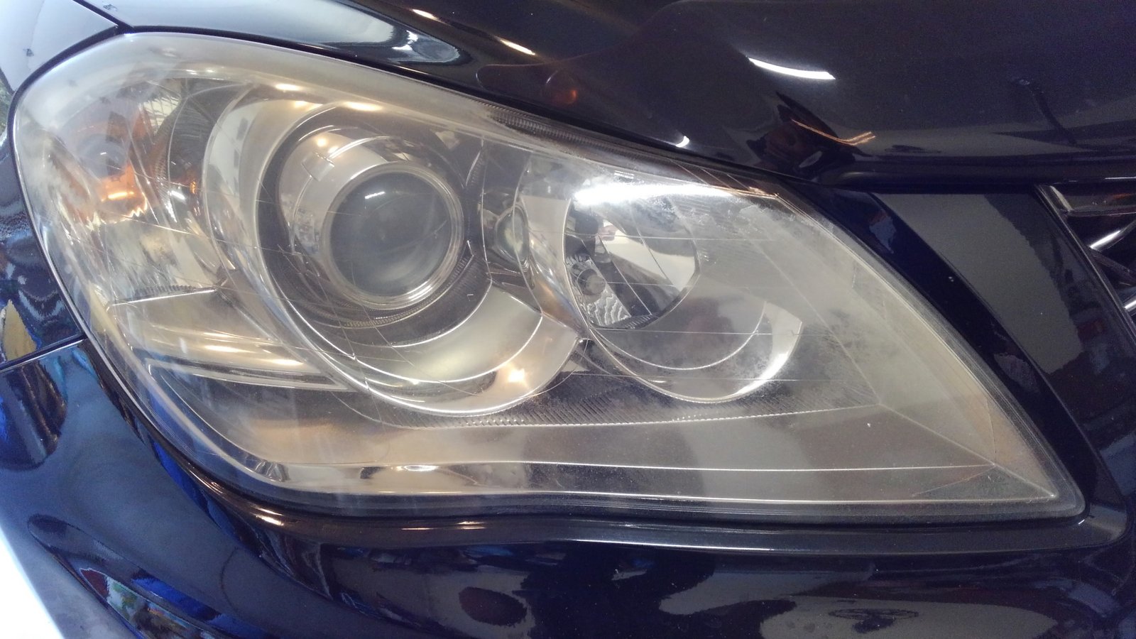

Now some before and after photos:
Before:
After:
Nice write-up Kuro. That last pic really shows the improvement clearly. Is that a final pic, or had you not applied the last step in your process? My lights aren't as bad as yours are, however, they are deteriorating rather quickly. Noticed a drastic change through-out this past summer.
Posts: 5275
Ronzuki wrote:Nice write-up Kuro. That last pic really shows the improvement clearly. Is that a final pic, or had you not applied the last step in your process? My lights aren't as bad as yours are, however, they are deteriorating rather quickly. Noticed a drastic change through-out this past summer.
The "After" pictures (including the last one) were taken after the complete process including the 3rd spray of the Headlight Coating. As you can see, the polishing had great effect and the Headlight Coating improved the clarity. It really made minor imperfections just disappear with the spray much like what the others reported. It's just that the 3rd coating made the headlights a bit greasy-looking compared to the impressive clarity of the 2nd coating. I wanted to relay this finding so people don't make the mistake I did.
From this experience and that of previous ones too, I'm no longer worried about getting deteriorating headlights back to great condition as I think I got that process down. It's now more about what's going to make the clarity last. I'll update this thread over time with photos but I'm optimistic about Meguair's Headlight Coating.
