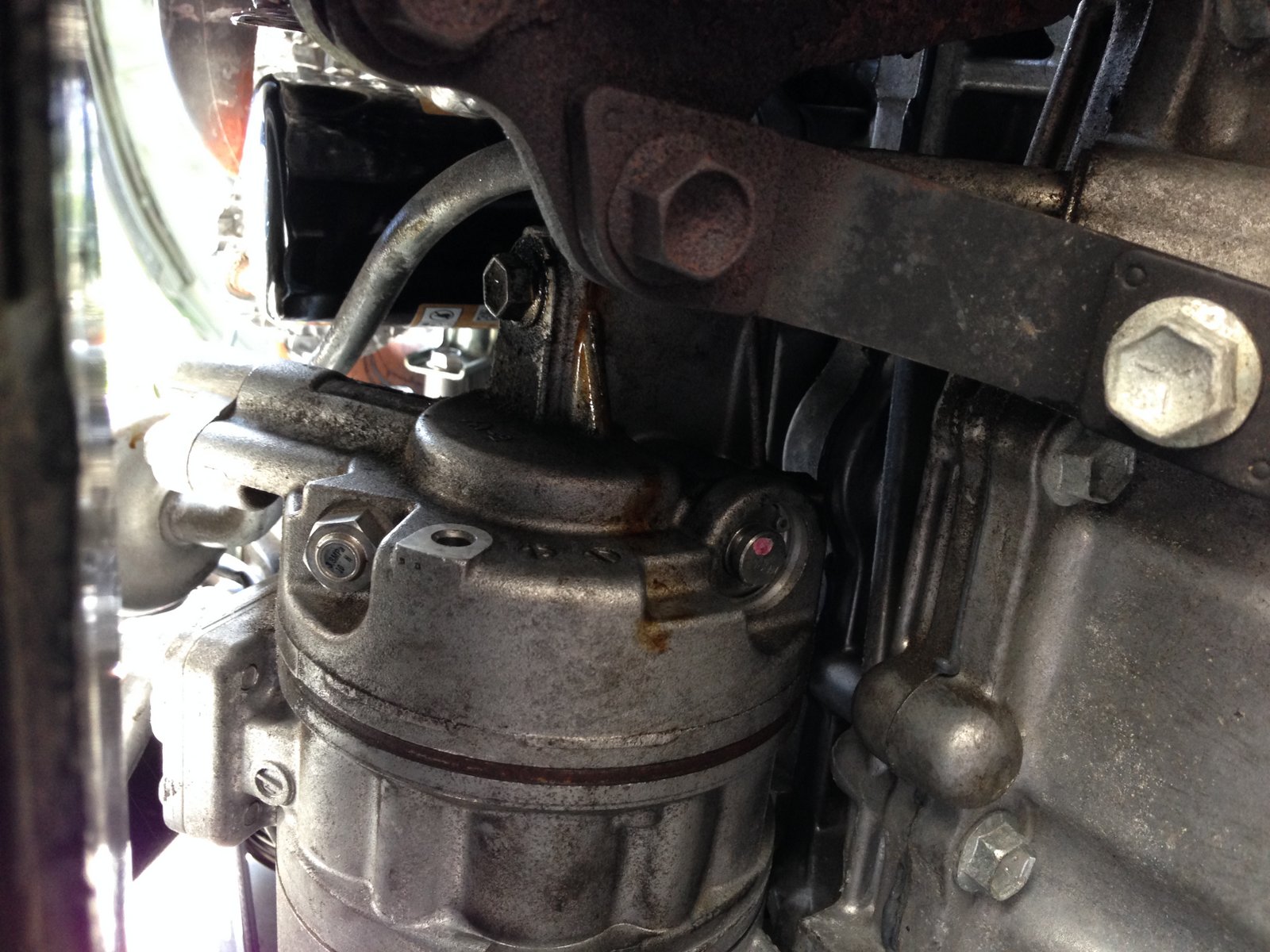

A few tips on the oil filter having changed the oil today:
- For removing the oil filter, use a cap wrench adapter, but use one that has a deeper cup and a wrench attachment area that does not have the wrench adapter or extension bar protrude to the cap area. I bought a cap wrench that was too shallow and also allowed the wrench's extension bar to protrude into the cap area. This caused the cap wrench to slip off the filter easily when turned. I had to use oil filter pliers instead which was a pain because of the minimal clearance. I then bought better cap wrenches tonight which had both a deeper cup and a raised area for the wrench adapter/extension bar. I got a whole set of these better designed ones at Harbor Freight Tools. The one for the Kizashi's filter is the smallest one on the left and is much better designed than the one I got from an auto parts store a while ago.
- The A/C compressor is located directly under the oil filter so the oil will dribble down the A/C compressor when the filter is removed. However, there is not much oil spilling out. I removed the filter with the opening up to minimize the oil spilled from the filter. Just wipe up the A/C compressor after the filter is removed.

In reality, the filter will be on way too tight to remove by hand. Also, there is really not much clearance nor grip area to remove by hand. It's really only finger space. If you can get it off by hand, you get my props, but it's also a sign that the filter was probably not on tight enough. I can't even tighten the filter on the Kizashi well enough by hand because of its position so removal is impossible for me.
Also, I change the oil when the oil is still hot/warm to maximize flow. Removal by hand would risk burns from the hot filter, not to mention the exhaust manifold that surrounds it.
I really think you will need a cap wrench which is the best tool for the Kizashi's oil filter placement. I just placed my new HFT cap wrench on the filter. A perfect fit.
The cap wrench is 65mm~68mm as most are fluted. Get a cap wrench of this size and you will be set.
