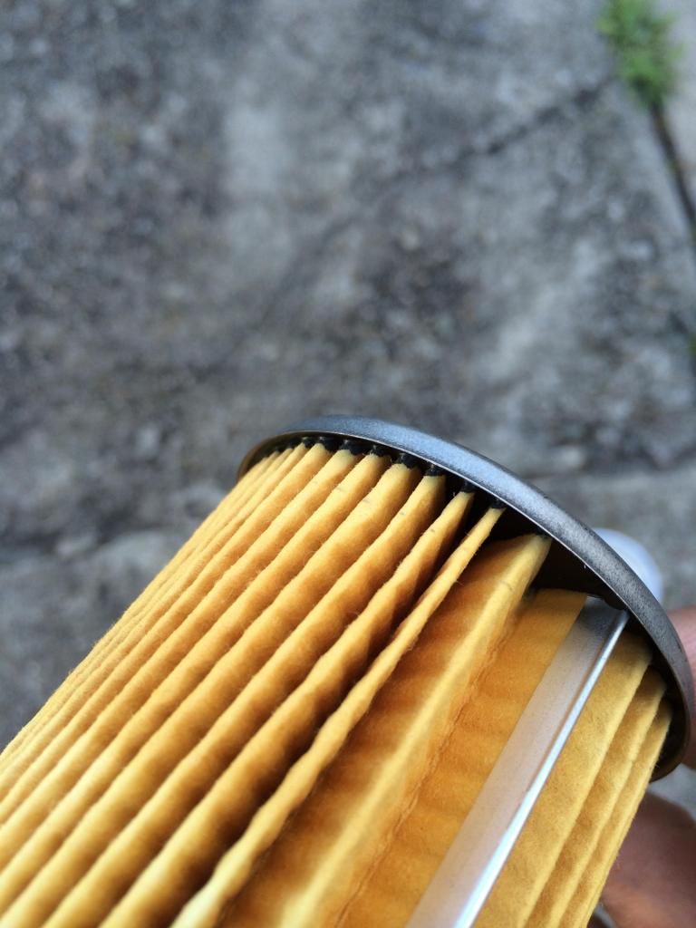

This picture shows where filters are commonly opened. The cut isn't close to the filter media:
If you see the rips on the Purolator filters, you'd see how it's unlikely that they were torn during opening. They're all ripping in the same spot where the pleats next to the spine are not reinforced and they're widely spaced apart. The filter media itself is thin and weak compared to other filters.
This brand new Purolator was hacked apart with pliers. No rips as it hasn't been used but it shows the design flaw of the pleats by the spine:
Here are some pictures of torn Classic and PureOne filters:

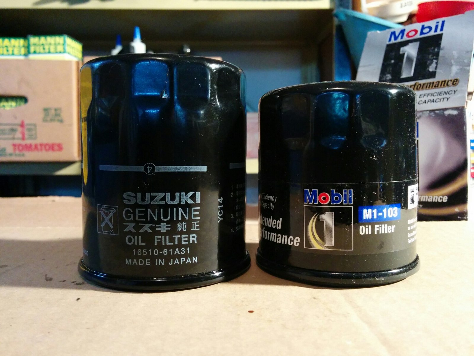

I finally did the oil change today. It was very straightforward and there was less spillage than I expected. I managed to remove the OEM filter by hand (filter cap wouldn't fit, read below) and I drained exactly 4.5L of oil. I used Pennzoil Platinum and a Mobil 1 filter.
Something I noted was that the Mobil 1 filter is smaller than the OEM filter. The Mobil 1 is 65.5mm in diameter and 75mm tall, while the OEM filter is 68mm and 85.3mm. The difference in diameter meant I couldn't use my filter cap on the OEM filter.

bootymac wrote:I finally did the oil change today. It was very straightforward and there was less spillage than I expected. I managed to remove the OEM filter by hand (filter cap wouldn't fit, read below) and I drained exactly 4.5L of oil. I used Pennzoil Platinum and a Mobil 1 filter.

I am very surprised that you could remove it by hand. It makes me think that it was rather loosely installed. Generally, oil filters can be applied by hand, but usually can't be removed by hand. That's been my experience.
The Mobil 1 filter is definitely smaller, but I thought only in height. I wasn't aware that it was a different diameter though all my cap wrenches are fluted so they fit a range of 65mm to 68mm. Sounds like yours was not.
Agreed. I usually have to bust out channel locks to remove filters that I tighten by hand. The OEM filter was torqued "enough" as it still took a bit of effort to remove, but the replacement filter is much tighter. I'm not too concerned about over-torquing as I'll have the cap tool to remove it.KuroNekko wrote:I am very surprised that you could remove it by hand. It makes me think that it was rather loosely installed. Generally, oil filters can be applied by hand, but usually can't be removed by hand. That's been my experience.
So I did some research into the Mobil 1 M1-103 filter and found that it is shorter than most of the OEM filters it replaces. I'm sure it's fine but ideally I'd prefer a filter that is either the same size or larger than the OEM filter, especially if they cost the same. Some people are using larger filters that have the same 3/4"-16 thread pitch and similar gasket diameters.
If the gasket seals against the block, then there shouldn't be any issues running larger filters. Just ensure that the filter has an anti-drainback and bypass valve and that it actually fits.
Here is a list of filter dimensions and some possible oversized alternatives.

Something interesting: Mobil recommends the M1-103 which is 68x74. This filter is the same size as the Purolator 14476; however, Purolator recommends 14477 instead, which is 68x89 and closer to the OEM filter size.
