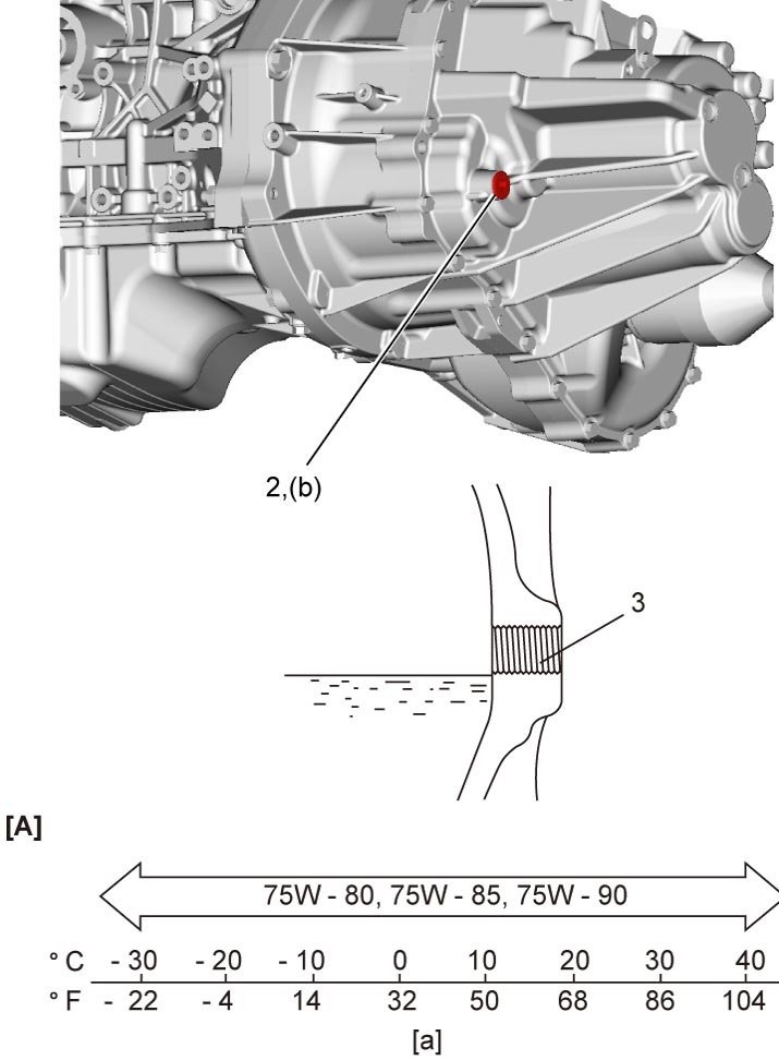

I was looking into the manual trans oil and found this on the factory service manual:
NOTE:
It is highly recommended to use “SUZUKI GEAR OIL 75W-80”.
Transaxle oil specification
: SUZUKI GEAR OIL 99000–22B21–036
: API GL-4 (For SAE classification, refer to viscosity chart [A] in figure.)
The viscosity chart is below:
Kizashi viscosity chart.jpg (83.21 KiB) Viewed 9622 times
It shows 75W80, 75W85 and 75W90 all as suitable across the entire temperature range. I'm guessing they "highly recommend" their own 75W80 for $$$ in their pocket and also 75W80 should give better fuel economy over 75W90 (more vehicles sales at the expense of long term protection?)
I was wondering how the people who have switched to 75W90 are finding the gear changes (2nd gear in particular) in the cold climates?
PS: I tried finding further info (ie. synthetic or mineral based) on the recommended Suzuki "GEAR OIL 99000–22B21–036" but could find zilch.
