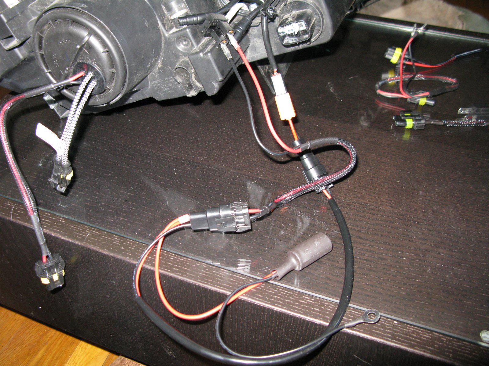

Here are some photos of the inline capacitor harness installation:

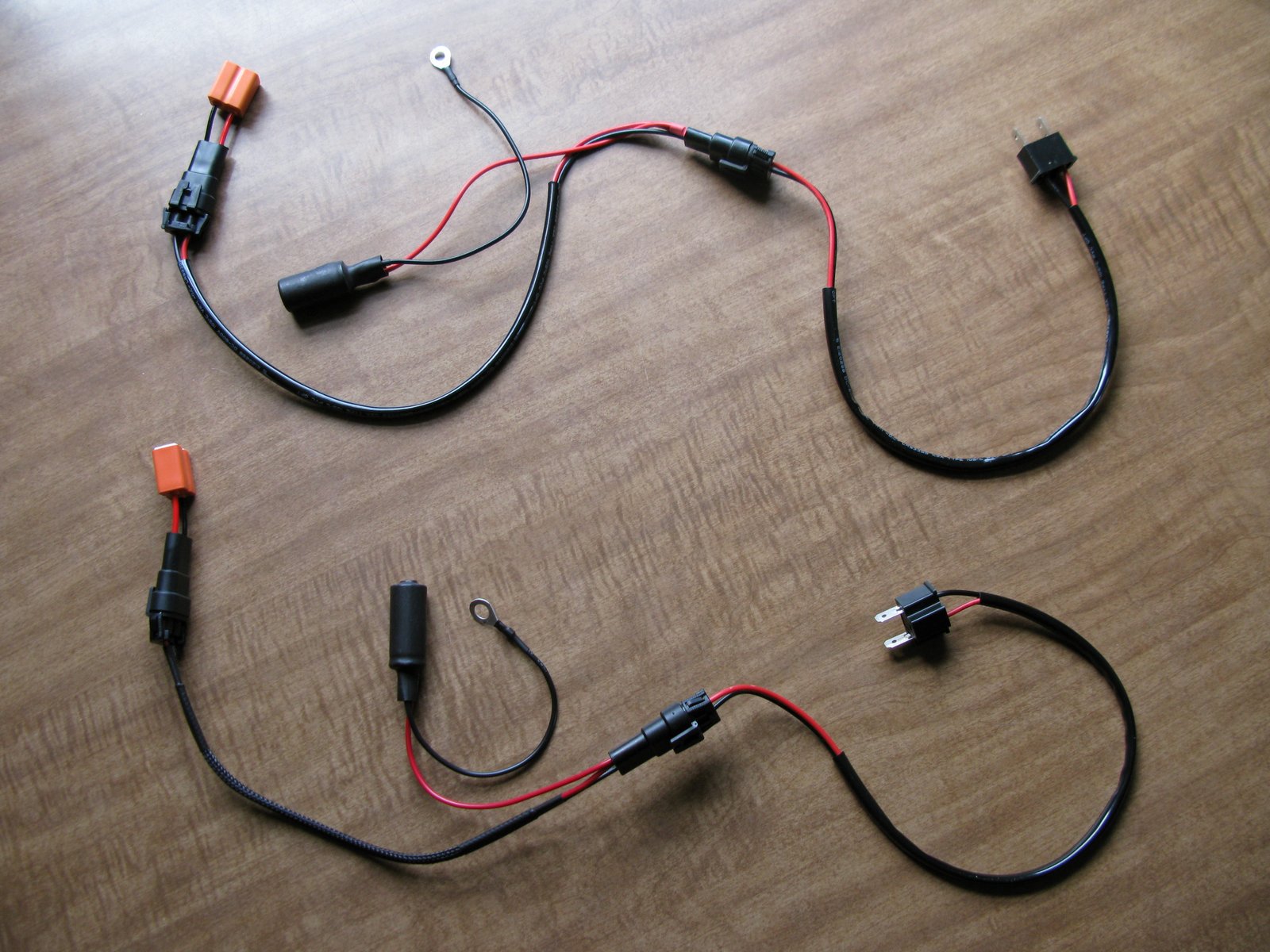

Here, you can see that the harness has a bigger connector than a H7. H7 is top. Bottom is what was on the inline capacitor harness.
The solution was to swap out the harness at the connector and install H7 blade connectors I had laying around from decommissioned HID kits. So glad I did not toss them.
This is the inline capacitor harness. I taped up the blade connectors with electrical tape and grounded the ground wire before I stuffed everything inside of the headlight.

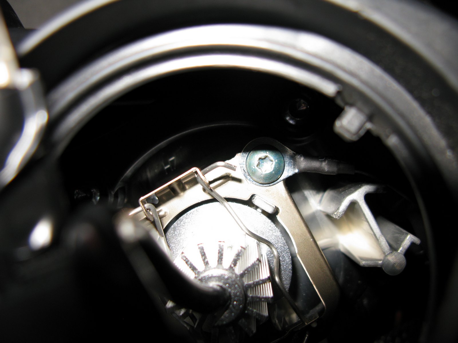

I grounded the capacitor's ground here given it was the only metal place I could. It appears to have worked.
Everything fit inside the headlight and appears to be working properly. I will post an update in a week or so in regards to whether the capacitor harnesses eliminated the flickering.
