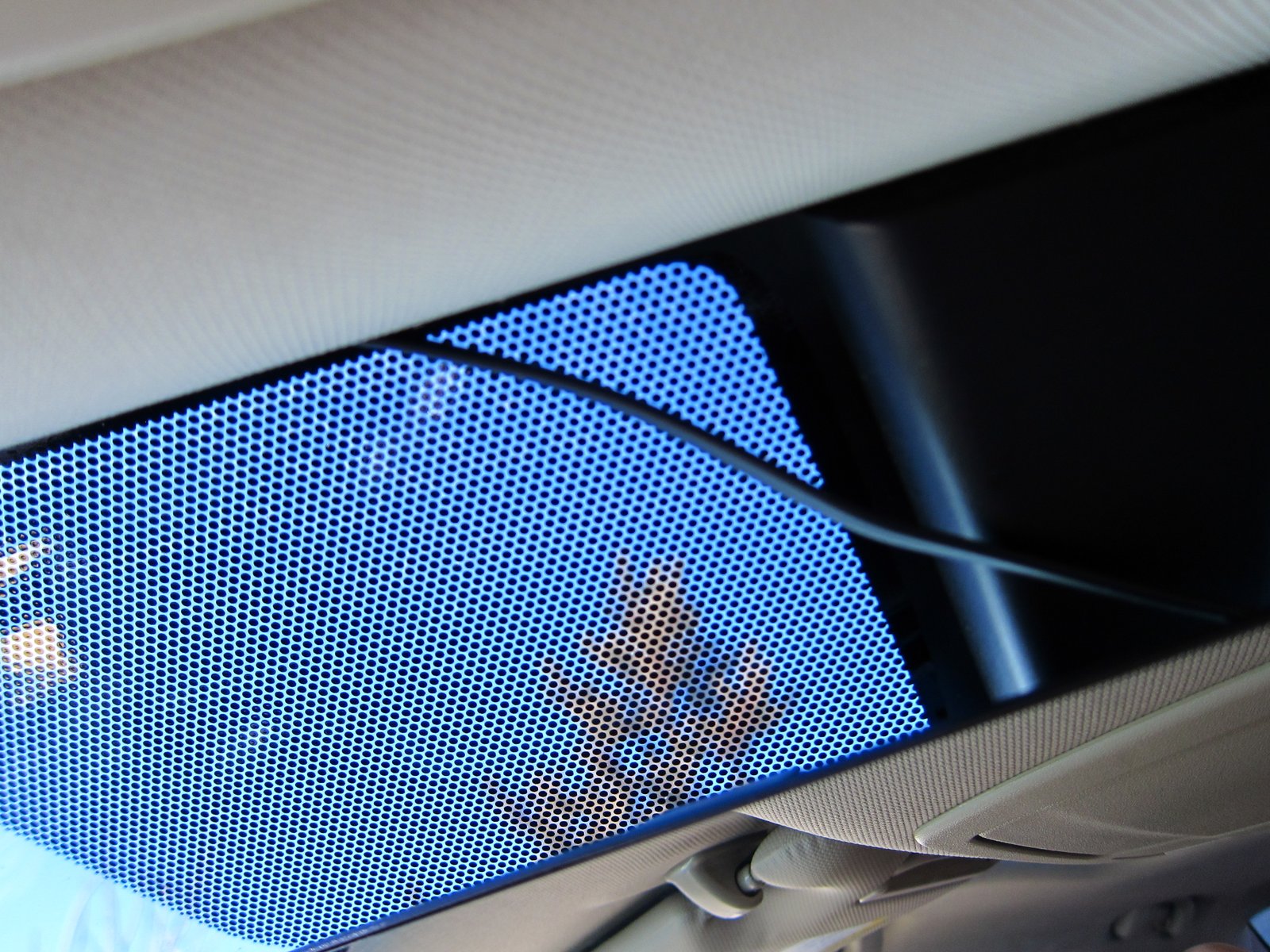

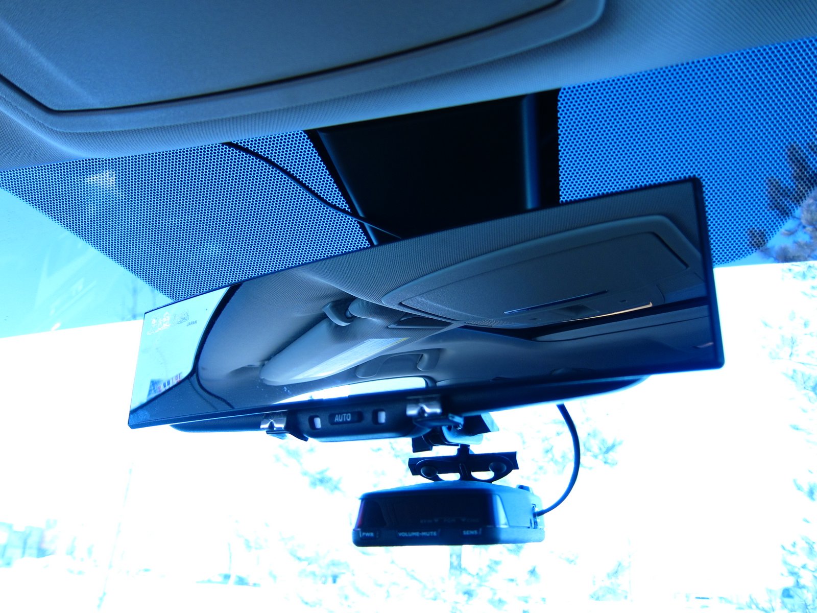

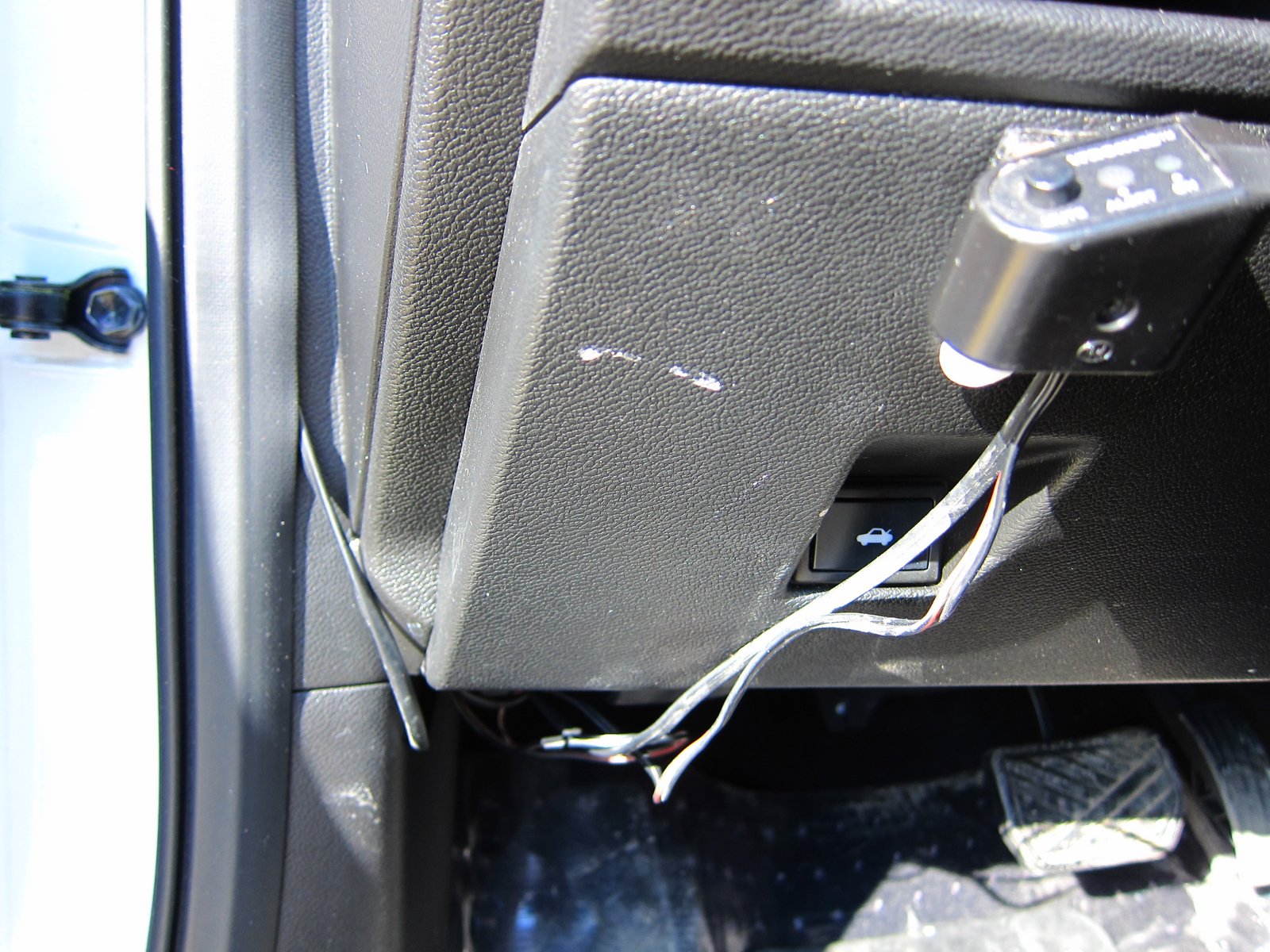

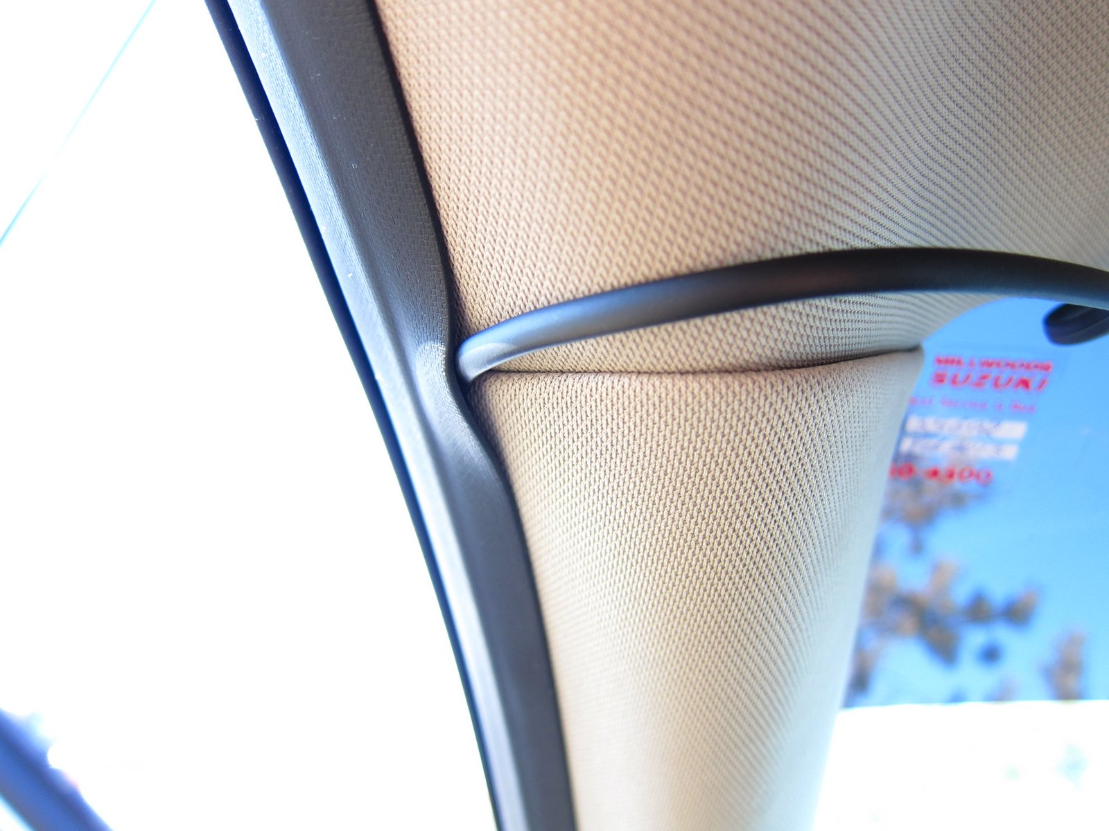

Was busy for the last couple of days so didn't get around taking pics
So here's basically how I run my wire
Let me know if you have any questions~~

Thank you. Tis is very helpful. So ou didn't even take the rubber flap off, instead you just tucked the wire in? I assume the wire will be squished when the door closes upon the rubber flap, but I guess that'd still work
2011 Kizash SLS AWD
Northernstar
Posts: 590
Location: Surrey Canada
yup, just tuck the wire in. I have had this setup for quite a few years now so I assume the wire didn't get squished by the door lol.
