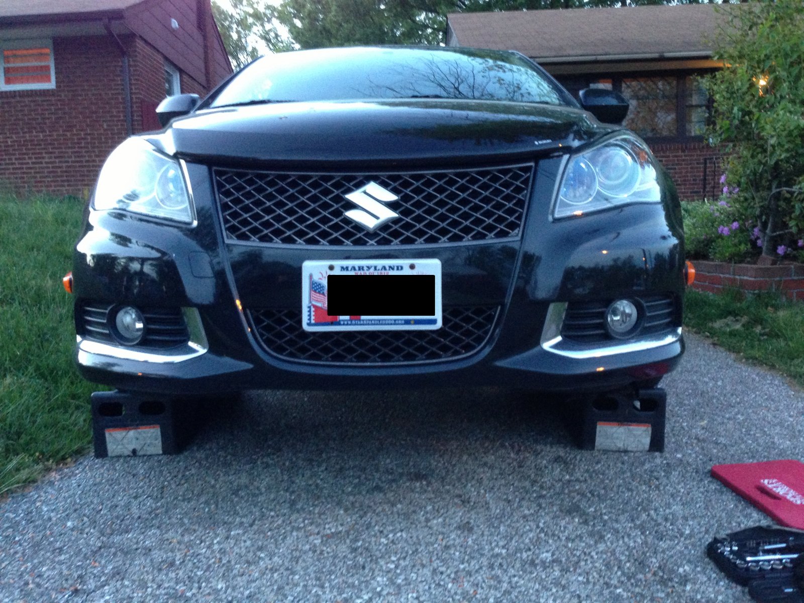

Raise the car up. I prefer ramps as shown.

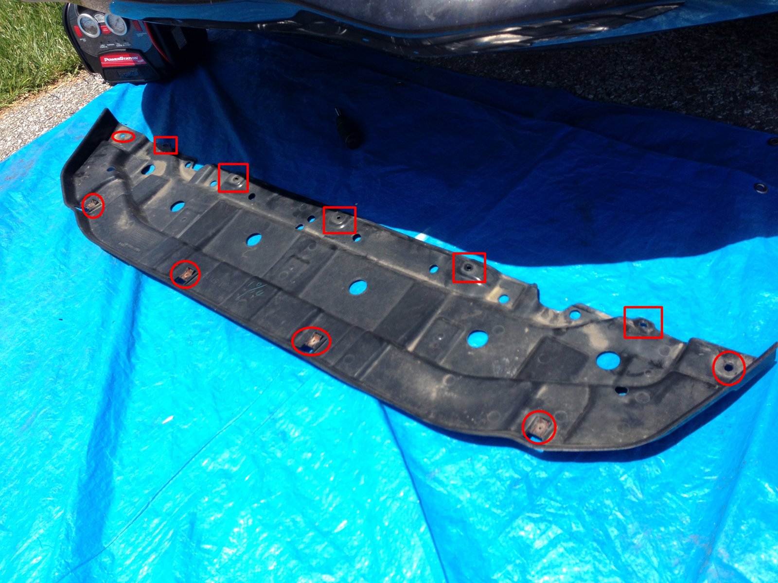

Splash cover removed. The circles are where the screws were. The squares are where the bolts were.

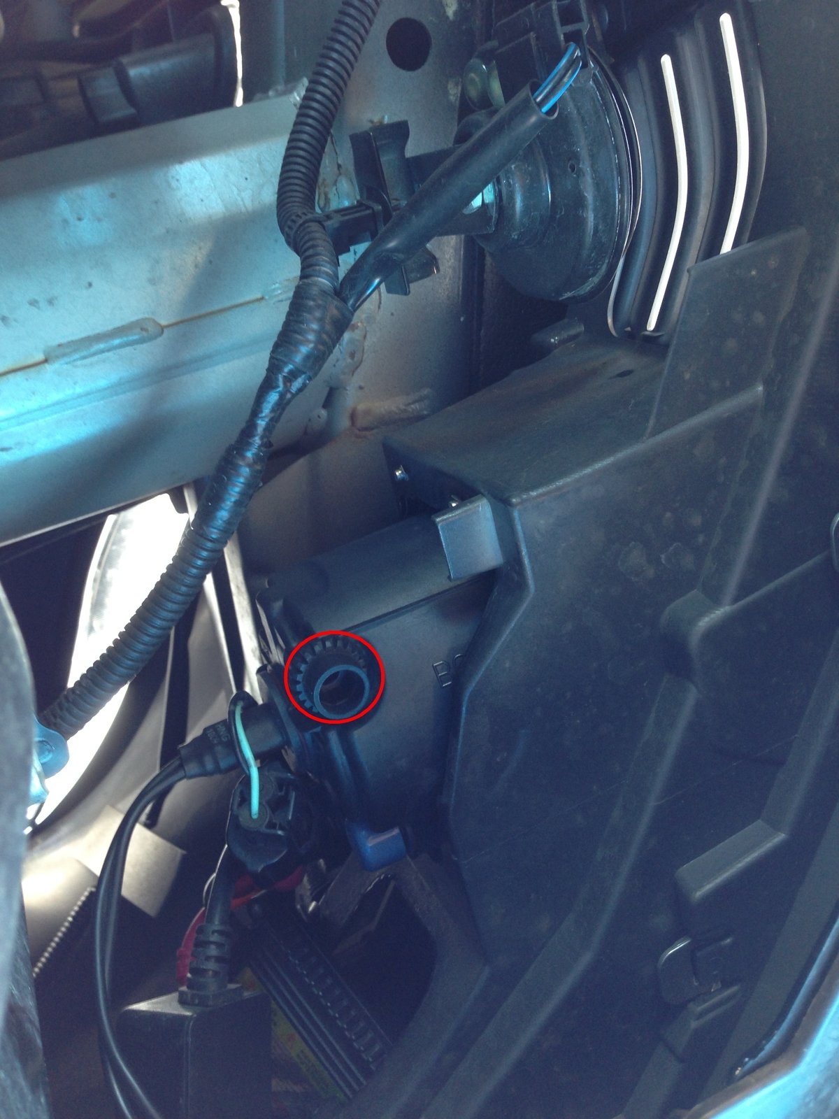

Driver side fog light. Adjuster is circled. You can also see the horn in the picture. The car has two, one on each side.

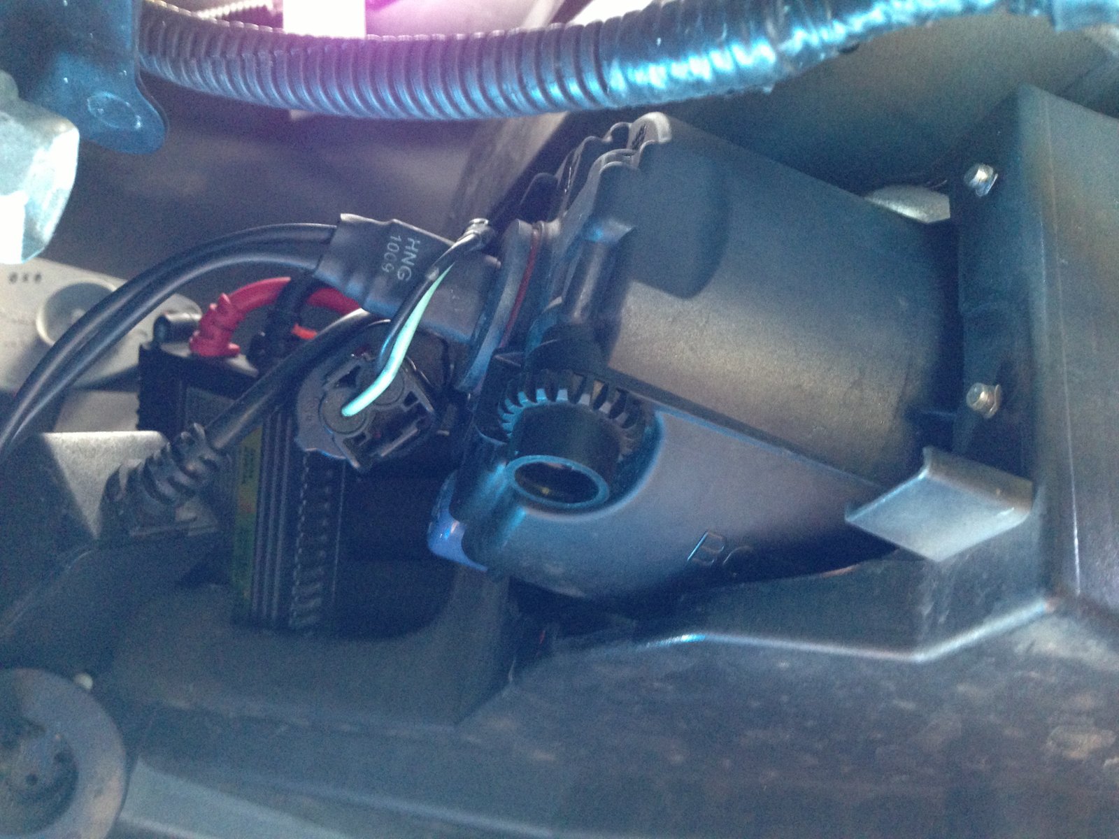

Close up of the driver side fog light housing. My fog bulbs are HID therefore you can see the ballast and igniter in the left side of the photo.

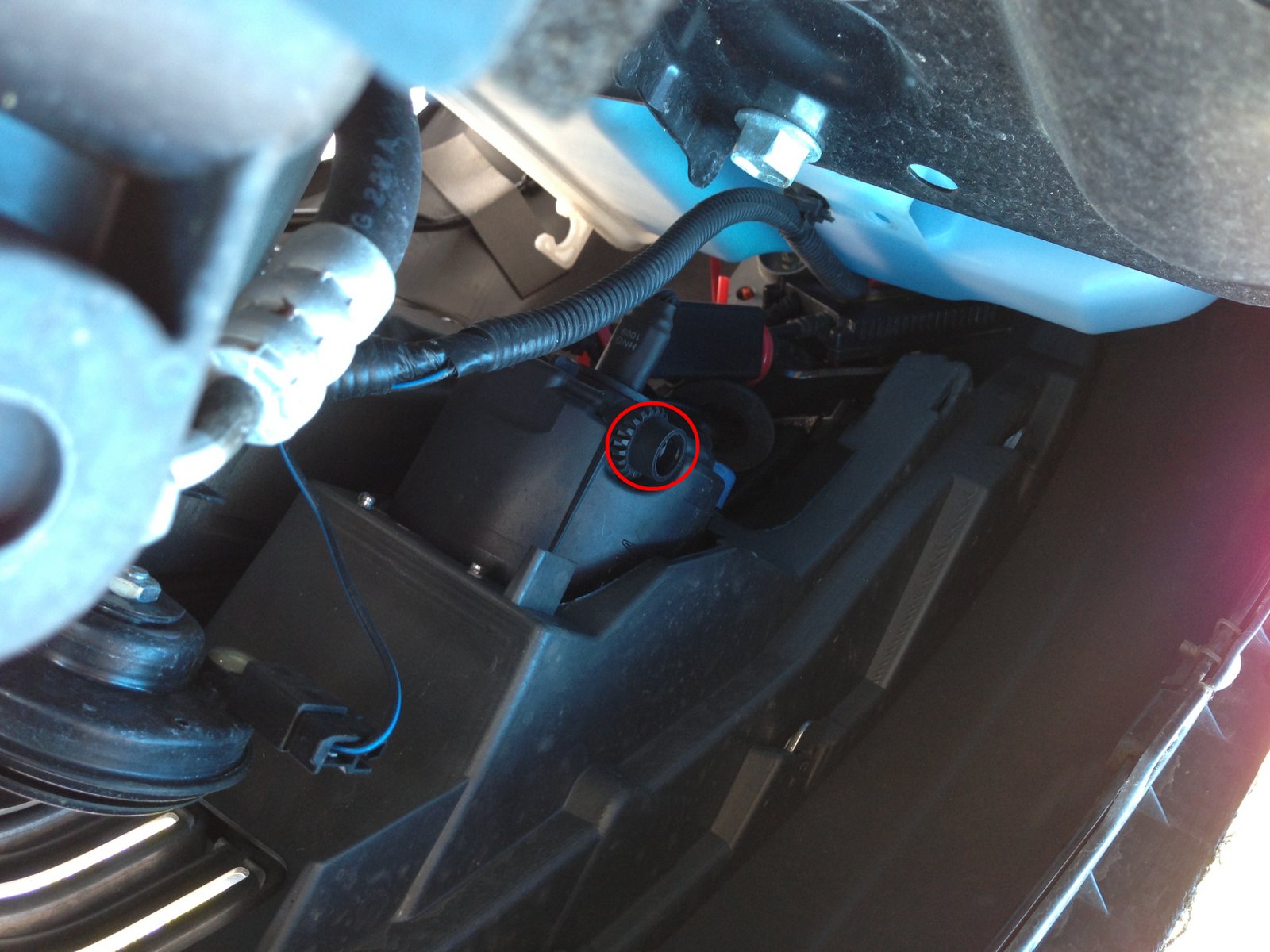

Passenger side fog light. The adjuster is circled.
