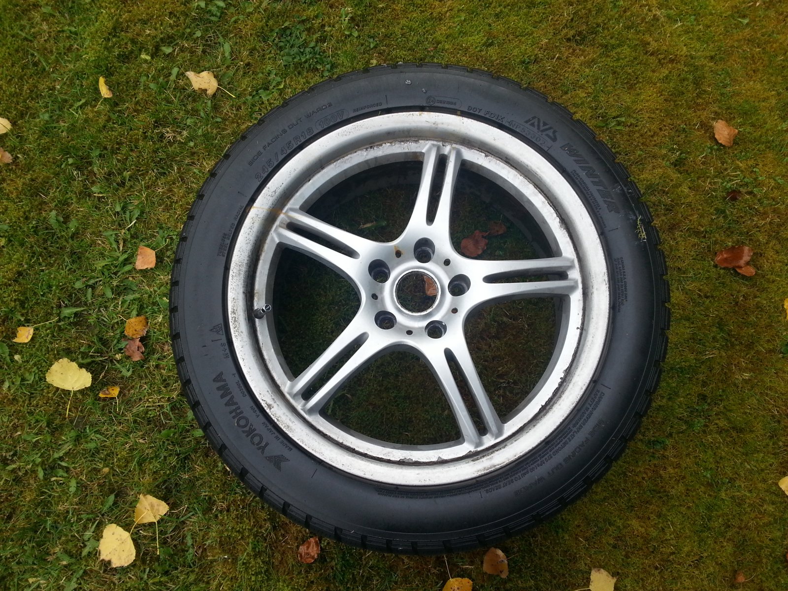

This is the original looking

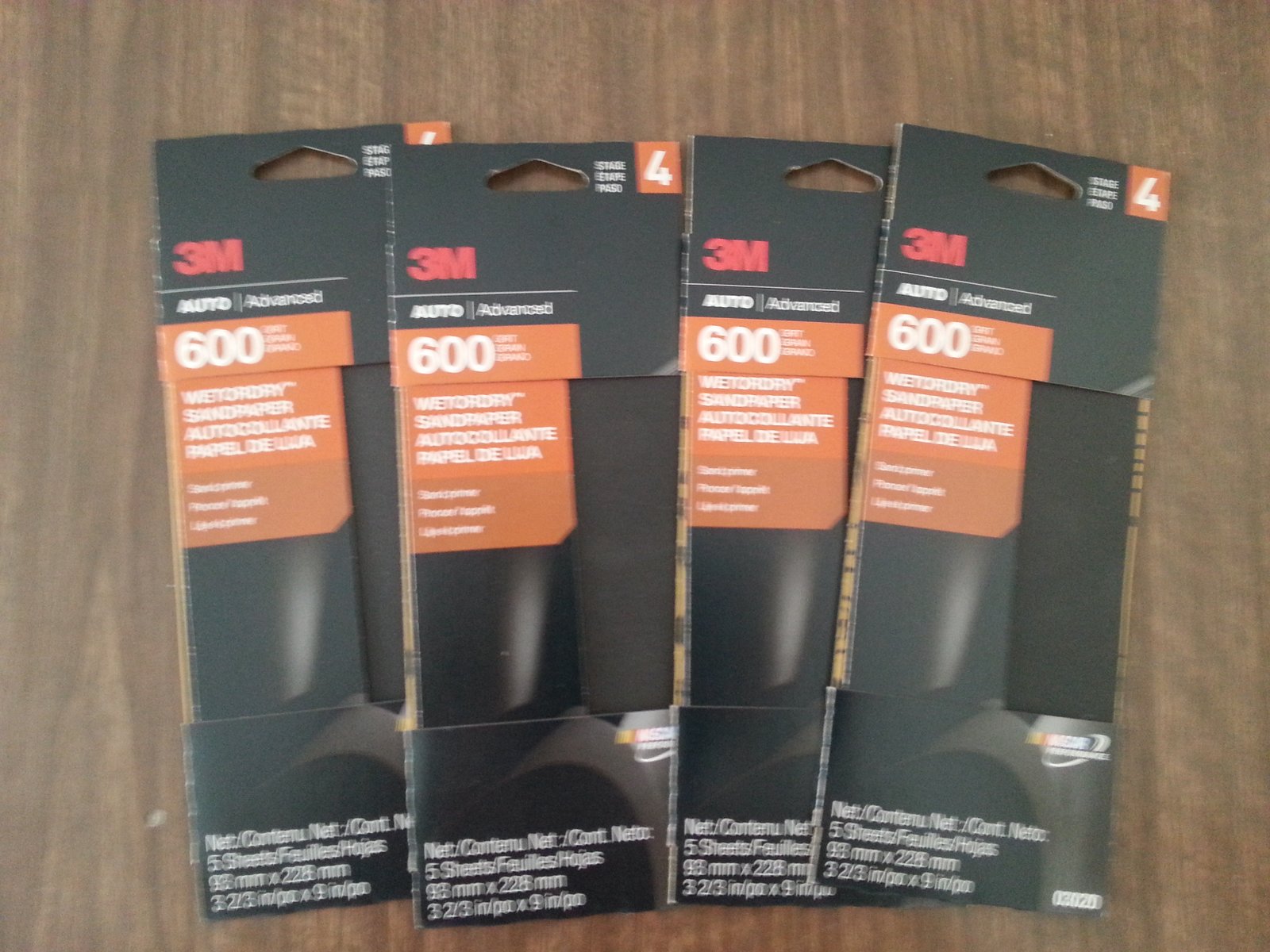

P600 sand paper
P600 sand paper

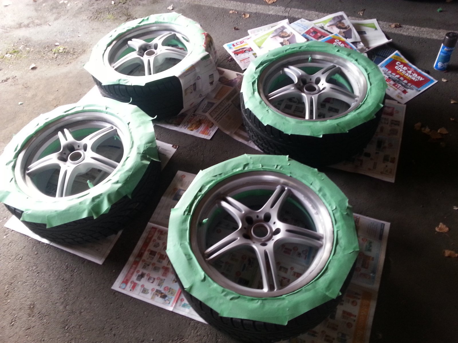

Wrap the tires
Wrap the tires

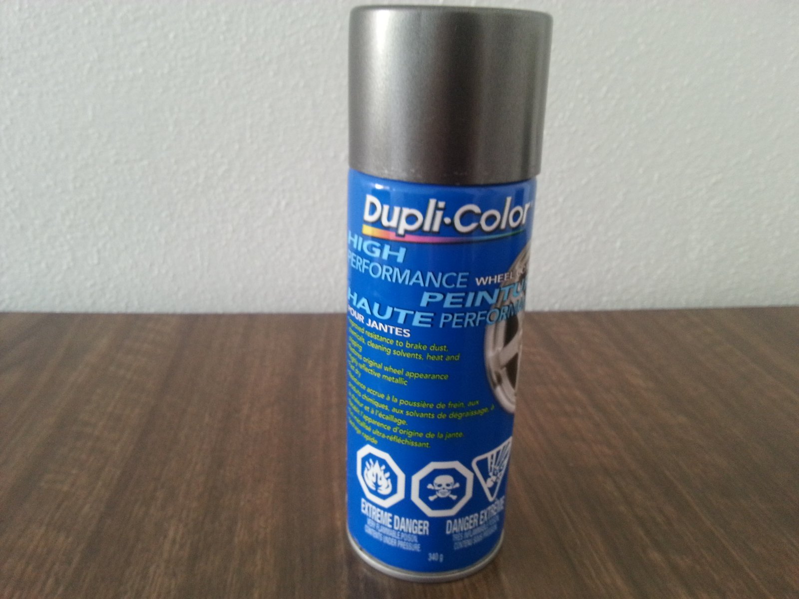

dupli-color
dupli-color

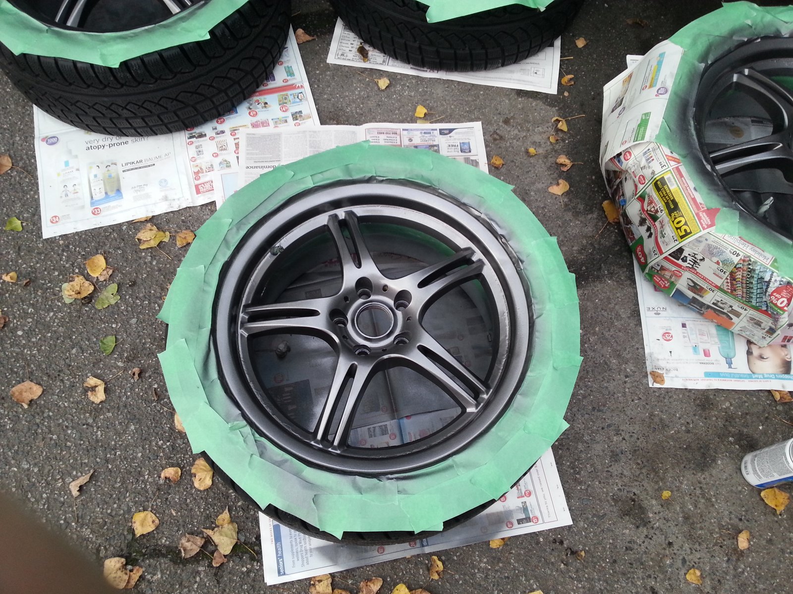

After 4 coats of dupli-color

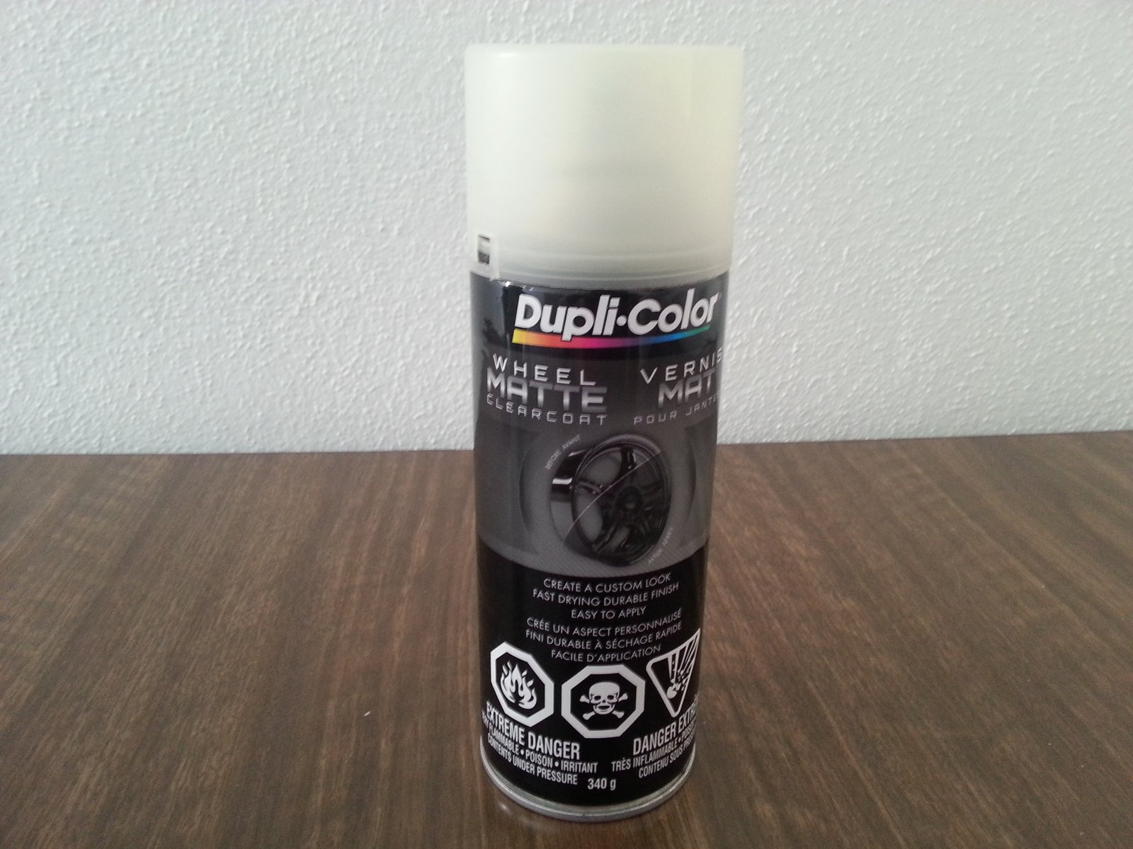

Clear-coat
Clear-coat
After 3 coats of clear-coat

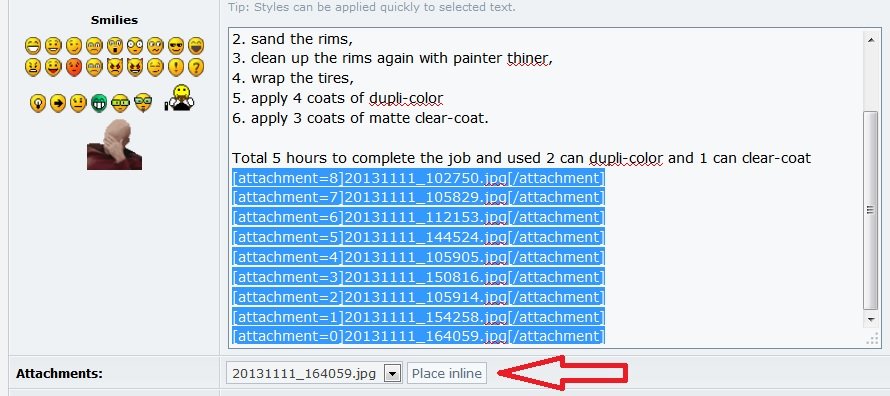

honsonwong wrote:Edit: Sorry that the picture sequence is backwards.
Yeah, this is something that requires getting used to. When I upload photos for write-ups, I deliberately upload them in reverse order. Last photo in sequence is first to get uploaded as they stack in queue.
Never fear admin boy is here...
Once you have the files uploaded(attached) you use the "place inline" button to add the image you want in whatever sequence you want. By by default the pictures will display in the reverse order you upload them at the bottom of the post.
If you are trying to explain something complicated this is the way to go.
If you have a ton of image files you may want to host images externally and use the
Code: Select all
[img]http://website/imagename.jpg[/img]
tags
Geeks - Alternatively you could use the following code in this case.
Code: Select all
[attachment=9]20131111_102750.jpg[/attachment]
[attachment=8]20131111_105829.jpg[/attachment]
[attachment=7]20131111_112153.jpg[/attachment]
[attachment=6]20131111_144524.jpg[/attachment]
[attachment=5]20131111_105905.jpg[/attachment]
[attachment=4]20131111_150816.jpg[/attachment]
[attachment=3]20131111_105914.jpg[/attachment]
[attachment=2]20131111_154258.jpg[/attachment]
[attachment=1]20131111_164059.jpg[/attachment]

Moto, Thanks for your instruction, I have edited the post and the pics is in sequence now.

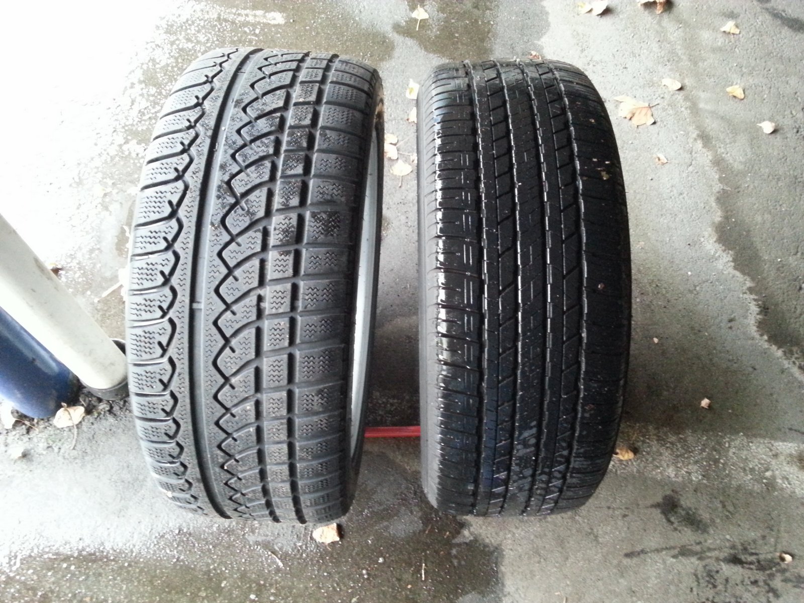

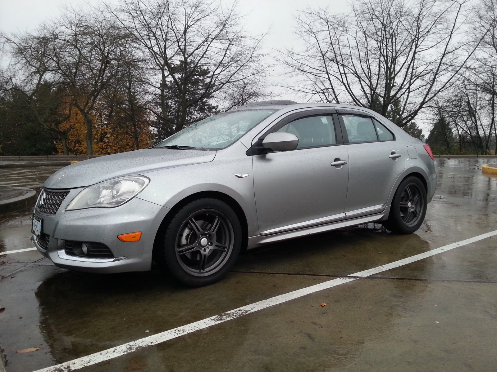

Weather report said the first snow of the year may happen this weekend in Vancouver, so I mounted the winter tires on my kizzy. Some pics to share.
difference between the 245/45R18 on the left and the original 235/45R18 on the right.

Looking good.
I noticed that you have the window visors and the moonroof deflector. I recently installed the window visors on my car as well.
In your opinion, is the moonroof deflector worth it? Does it really reduce the wind noise?
honsonwong
Posts: 201
Location: B.C. Canada
KuroNekko wrote:Looking good.
TBH, I have never tried to open the moonroof just a little, usually, I tilt up the moonroof or totally slide open. However, the window visors are very helpful, especially in the rainy days, it keeps the fresh air circulate, but I don't feel it reduce the wind noise.
