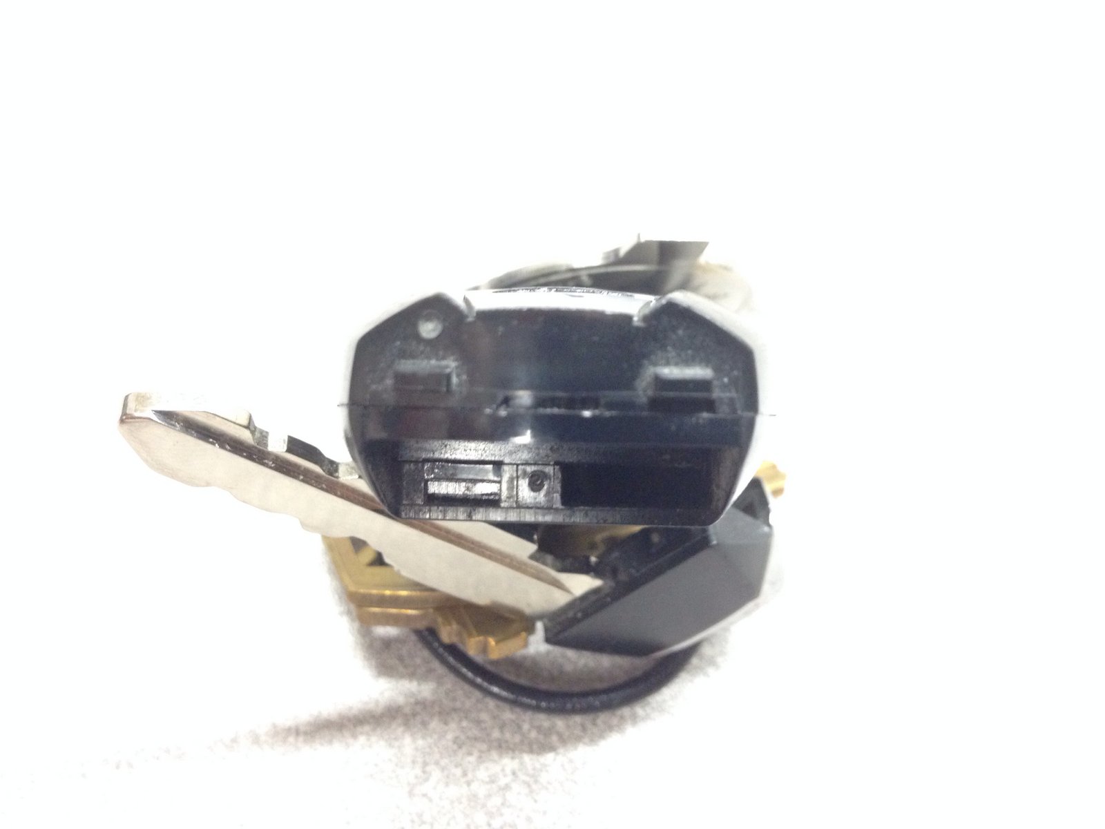

Kuro can you specify which is the "bottom" of the fob. I am having a hard time removing the cover as I am worried of damaging it. Owner manual say from the slot where the physican key exposes
2011 Kizash SLS AWD
Posts: 5277
ipaqxman wrote:Kuro can you specify which is the "bottom" of the fob. I am having a hard time removing the cover as I am worried of damaging it. Owner manual say from the slot where the physican key exposes
Here:
ipaqxman
Posts: 257
Location: NYC, NY
Thanks!
