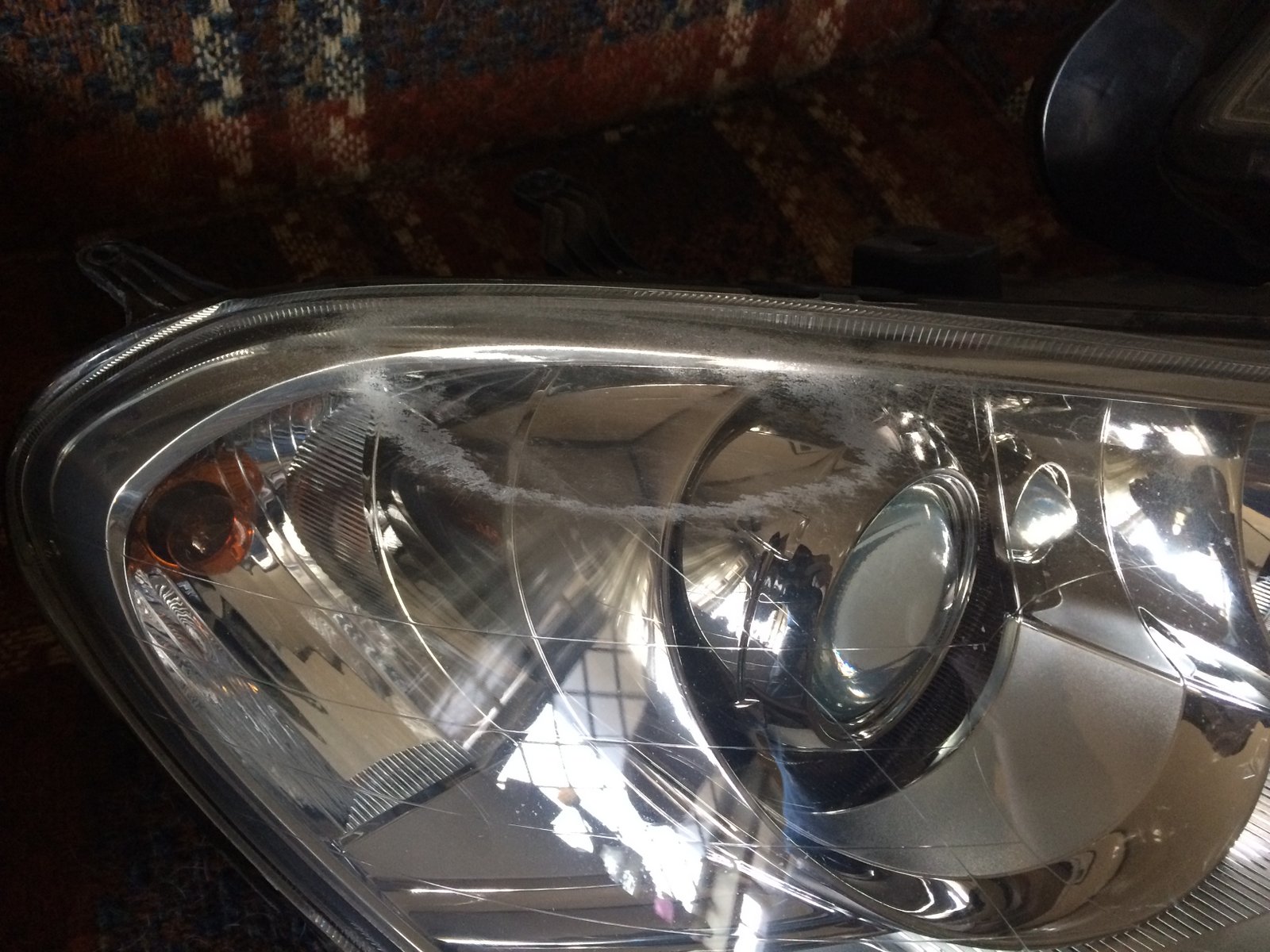

For starters, this is what the headlight looked like before the process. The haze at the top is the UV damage. UV rays from the sun eventually harm the plastic of the headlights and cause them to haze to an opaque yellow over time, significantly reducing light output.

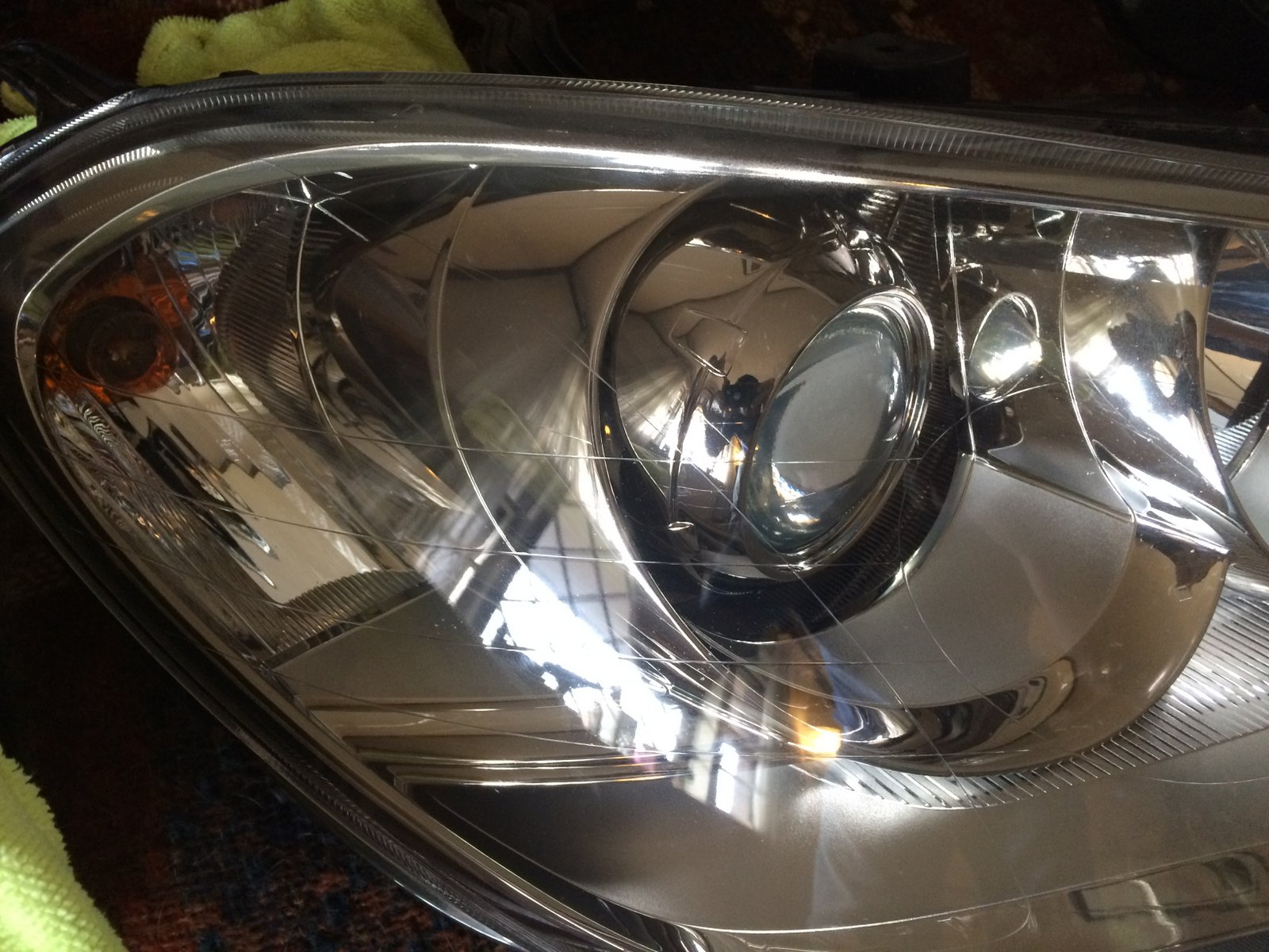

Finished result:
