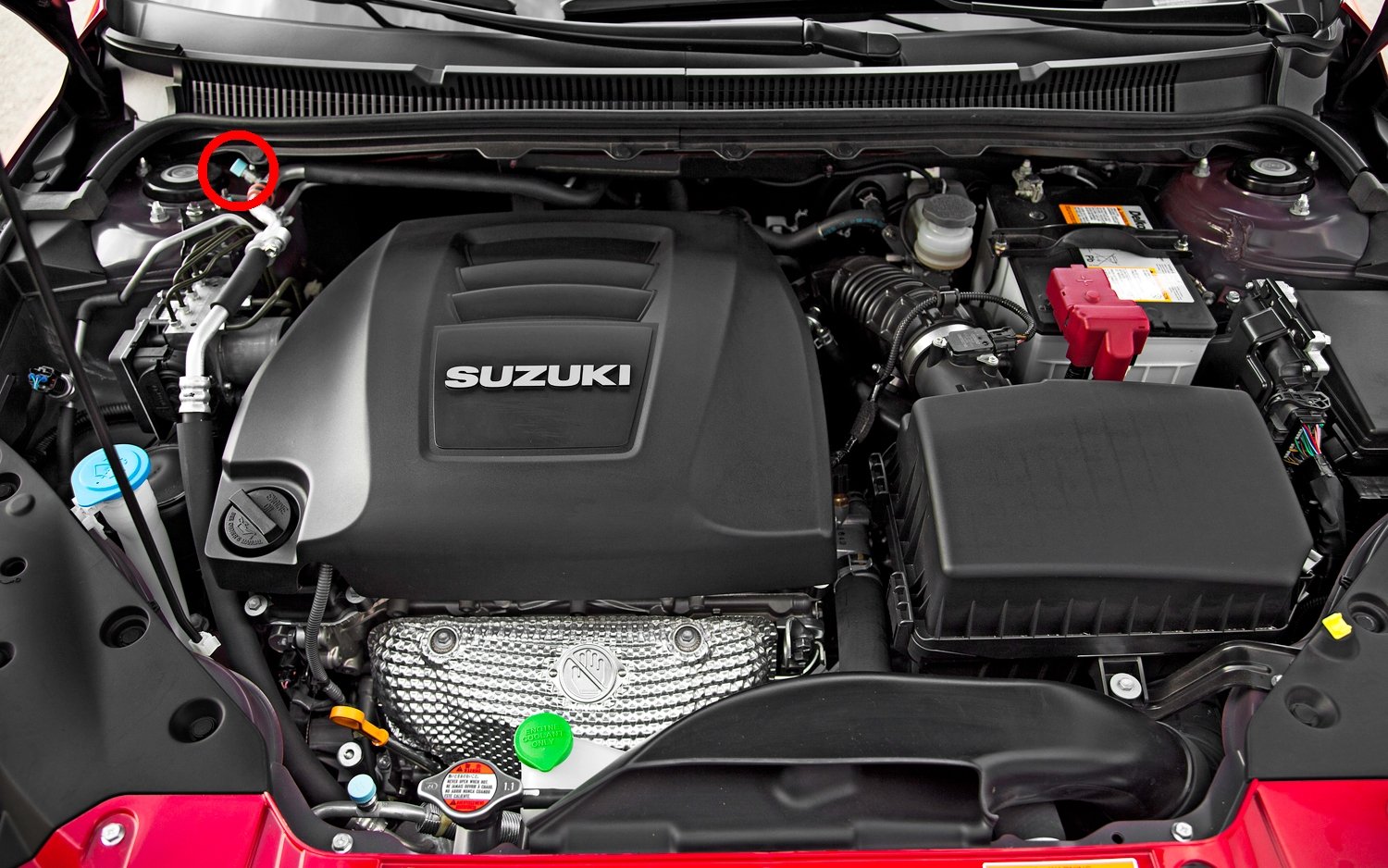

Hi. Im wanting to service my cars AC using AC PRO. Im curious where is the low pressure port located in the 2011 Kizashi SE?

It should be the one I've circled in the photo below.
Kizashi engine.jpg (281.09 KiB) Viewed 8211 times
