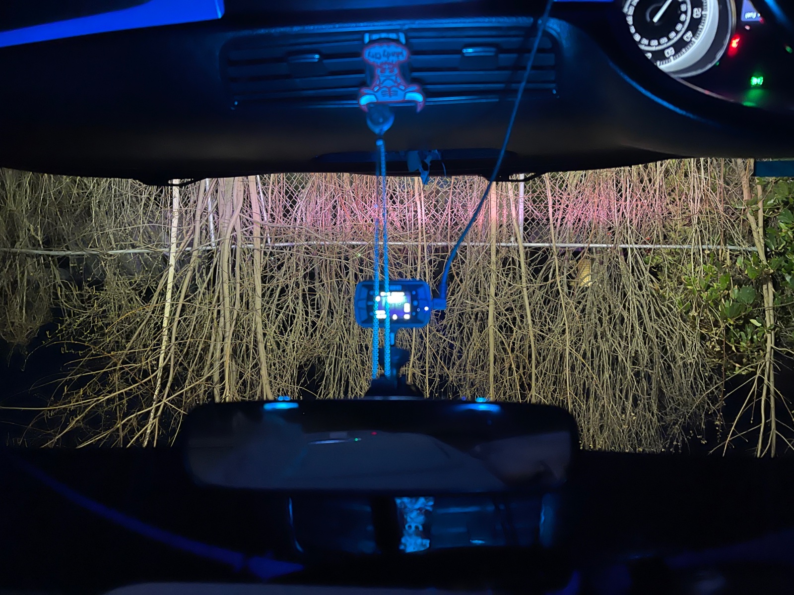

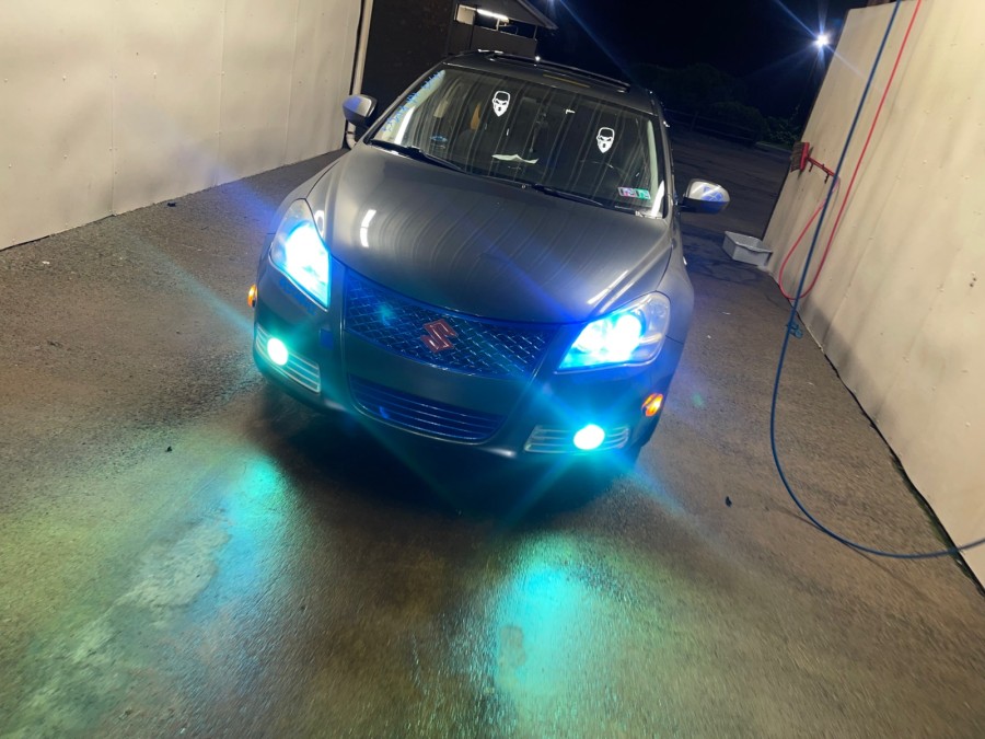

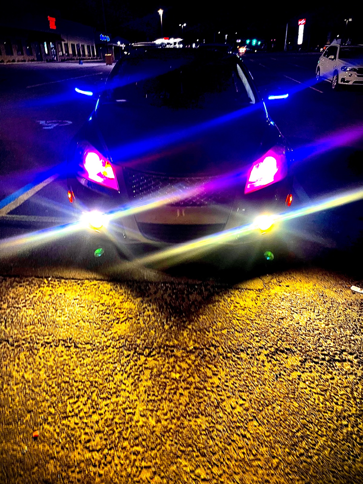

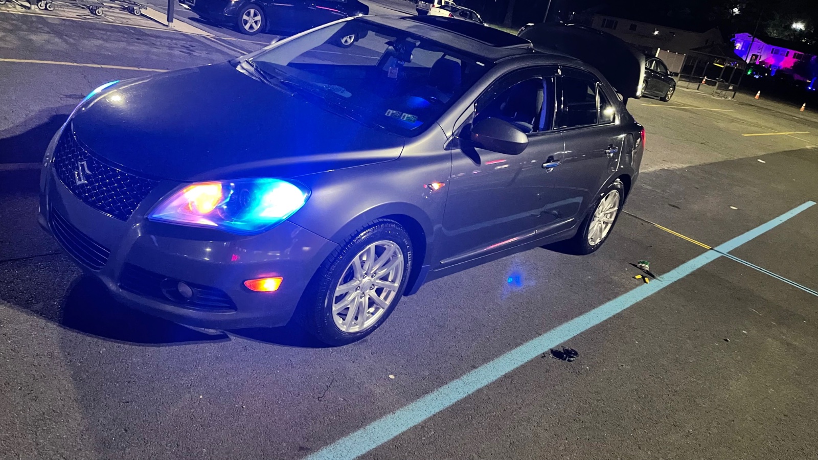

Jerzsk
Posts: 6
Joined: Sat Feb 12, 2022 9:58 am
Here are Some pictures of My Zashi ewith multiple different color H IDs and Bulbs that go from 30 K purple 3K Amber between maybe this will give you a visual IDEA
