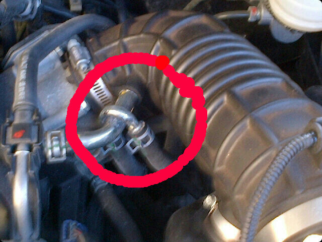

So far I looked for any cracks in intake and did not found any crack. Filter is clean and filter box is closed like it should be. The only thing I notice that one of the hose that is connected to intake rubber hose is lose mean I can push it inside and take out completely. I took pict of that and will post it. I show it to the dealer and guy say he will check that when I bring car in on monday. I check my friend kizashi and I can't move this hole and in mine it come in and out. Maybe is that the problem? I bring car to dealer on monday because they did repair last week. Car was making noise like maybe belt was ware down but they say that it is water pump. I left the car for 3 days at dealer to replace water pump and when I pick car up they say water pump was ok and they did replace alternator. Car was ok for 2 days and then nose come back. What kind of noise I am talking about you can check on my dealer suggestion post in performance. I hope that they will fix that problem. Also yesterday I received phone call from suzuki rep from california to find out if the problem was solved. I told them what's up and rep say that monday they will call my dealer and later me to let me know what the deal. The hose in a red circle is the hose that I can pull out or push inside that big black rubber hose. Can this be the whistle problem?

Ok I got some updates about that whistle noise. I went back to dealer and after running different kizashi and than mine they finally say that there ia a whistle noise while accelerate. Dealer say that they want me to get second opinion form different suzuki dealer and they send me there. I got to different dealer and guy there drove car and put in a shop and accelerated. After like 5 minutes guy told me that the whistle noise is coming from alternator that dealer replaced a week before. So I get back to my dealer and told them what other suzuki dealer say. Now I have appointment for tuesday. I will keep update about that and I hope it is alternator and they will fix it. Thanks all you guys for replays.

Wow, this is crazy bro what the dealers are making u go thru. But in that picture where u have the red circle, that cud be it, cuz if something is loose in the intake it will make a whistle sound when revving. So guess u can get that replaced so it wont be loose. You have a 2011 car and i doubt u have more then 30k, the dealer shoulda gave u a brand new car for all the crap they told u... good look man, hope u find whats wrong
