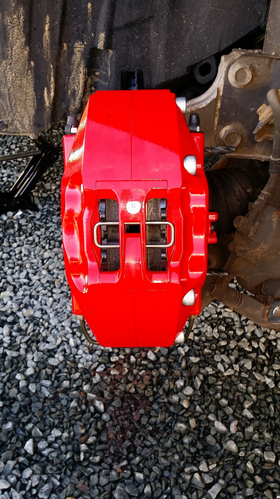

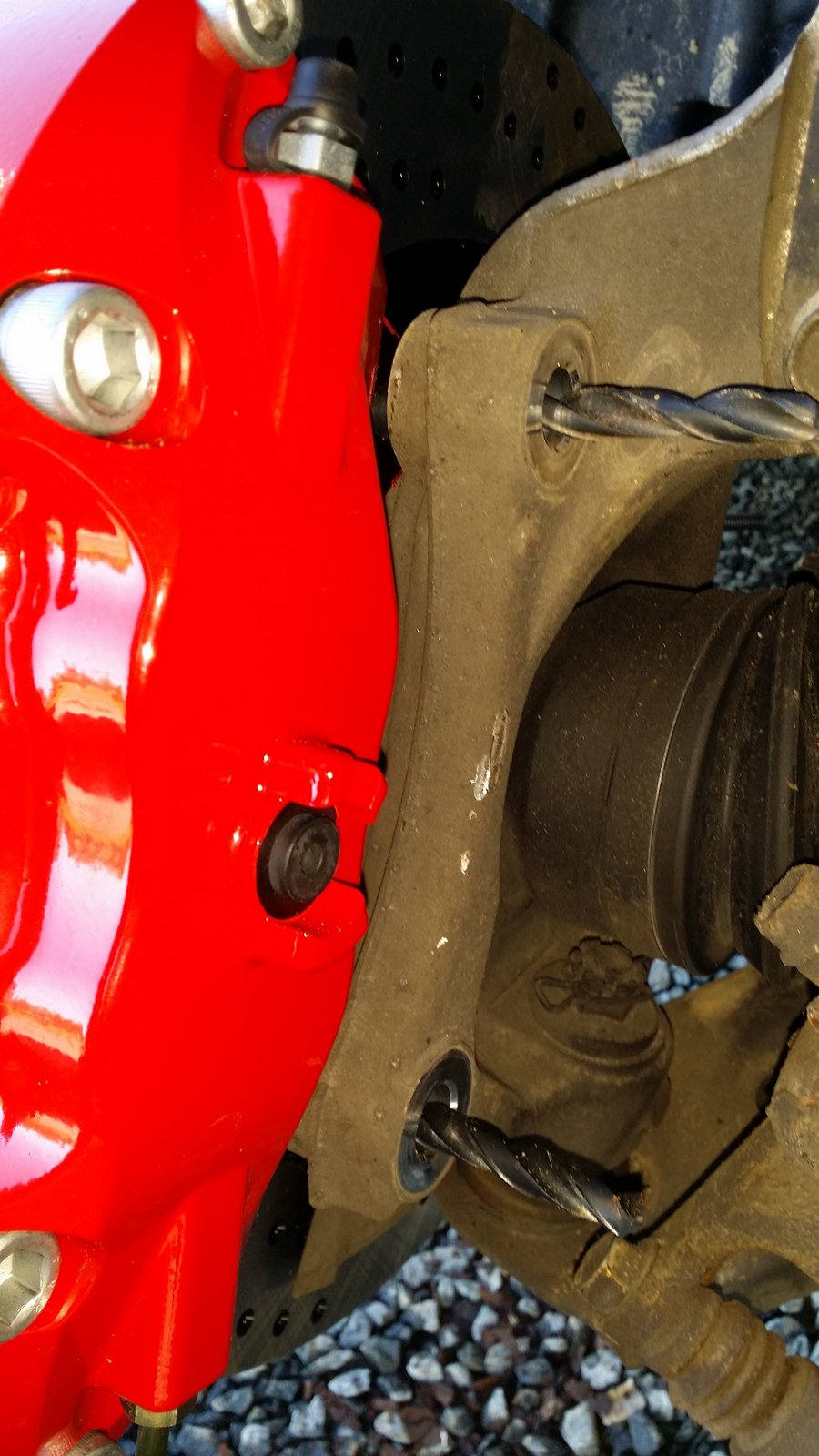

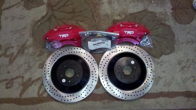

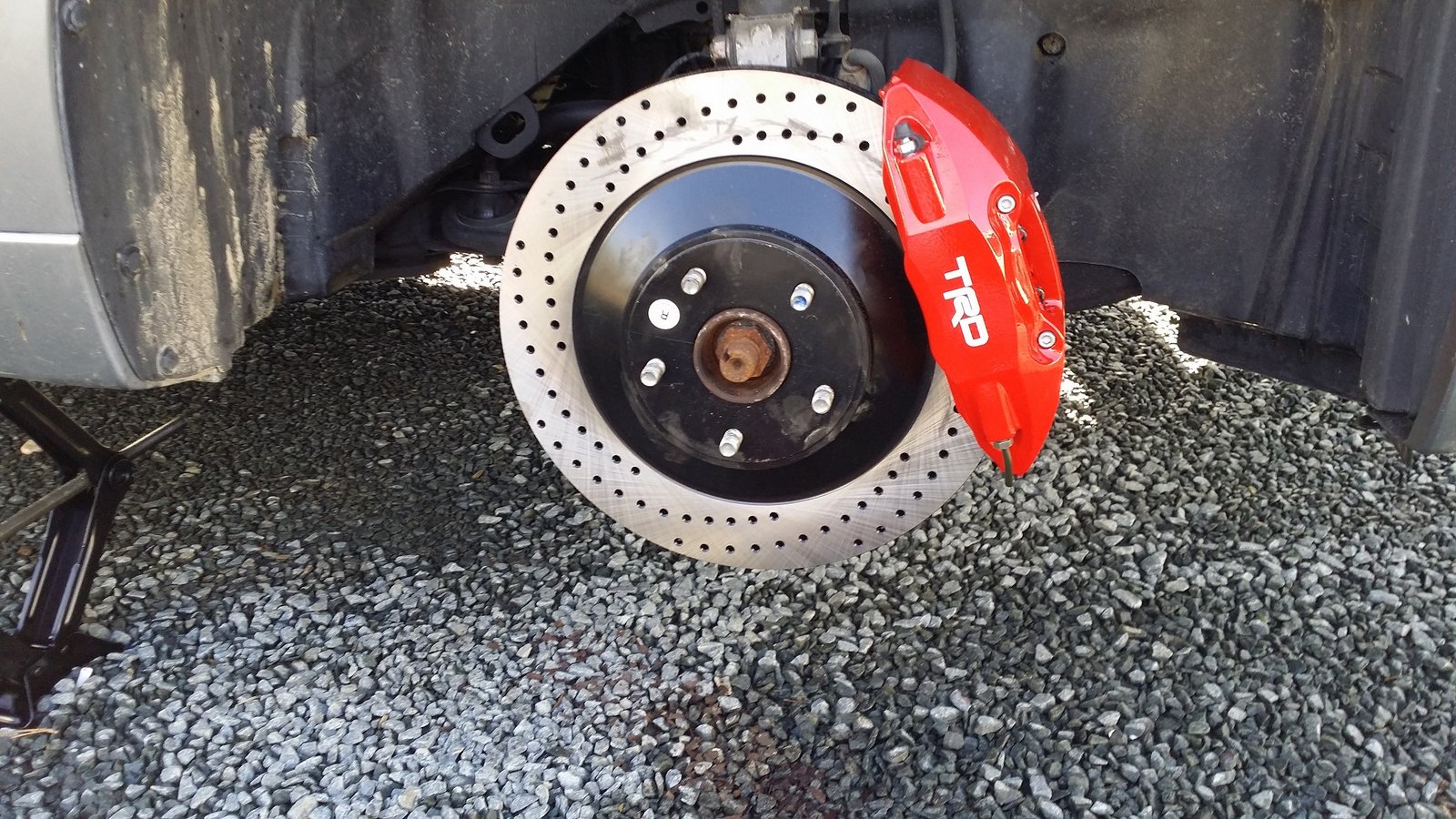

So I have been looking around for a brake upgrade but trying to keep the budget low. I tried a few options like the 350z brakes and 300zx but no luck. I was doing something at Toyota when I saw this showcase for the Scion it had a big brake kit for the Scion XB 4 piston caliper big rotors. i asked the guy to measure the bolt hole spacing long story short i talked him into letting me try 1 for a mock up i also talked my boss into letting me go home on luch for an hour to try out lol.
Here is what i got so far.
B.B. kit $2500 marked down to $1800 I offered him $1 lol
after some back and forth i got them for $440 tax
Stock setup
Stock setup

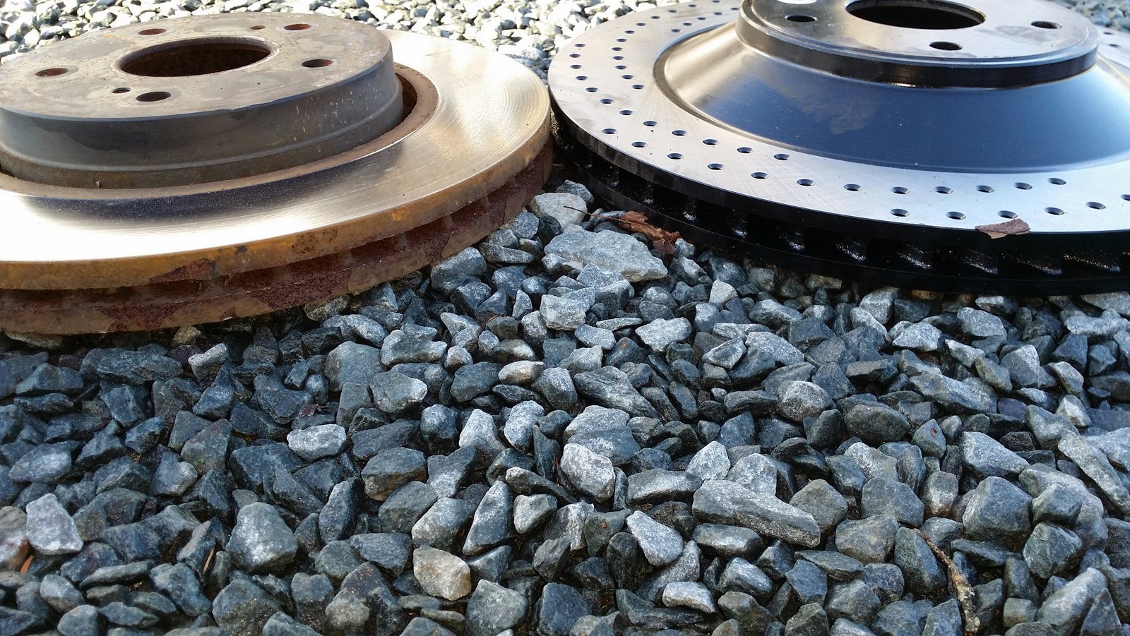

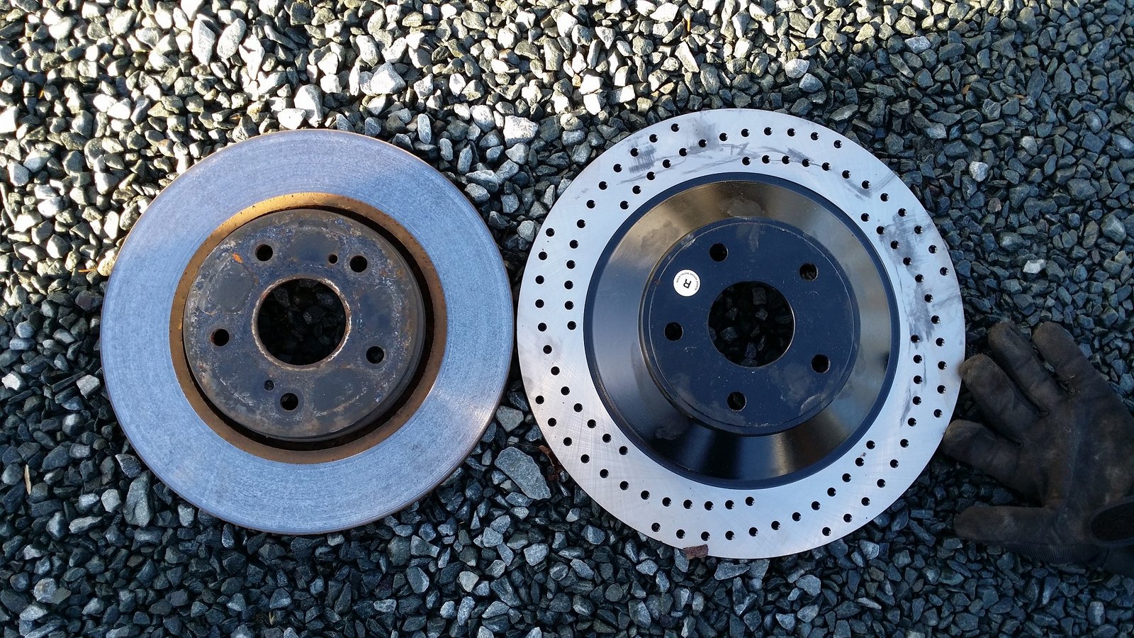

big rotors
big rotors

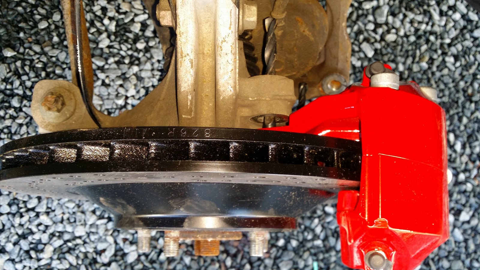

yes those are drill bits i had nothing else that would fit
this will need a spacer made up to fill the gap

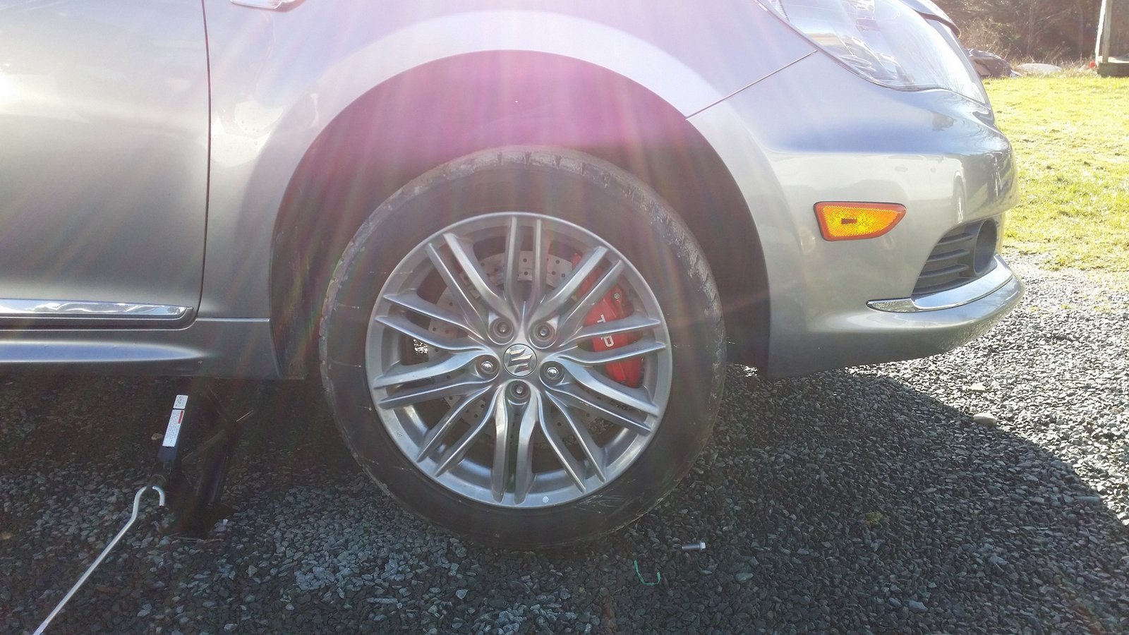

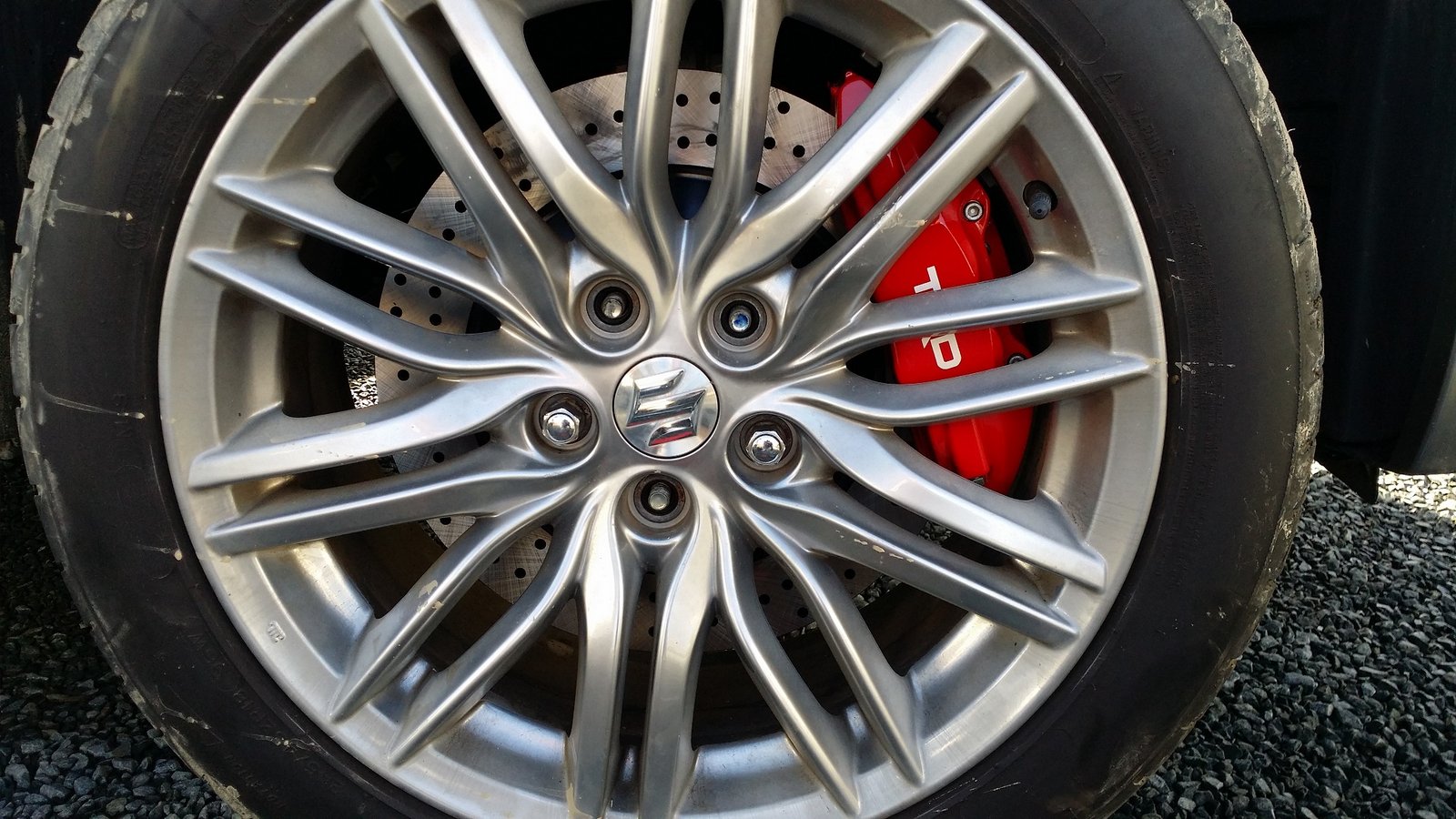

Fits over my 18'' wheel they said the kit recommends 19" wheels it is a close fit but no contacting

Thanks for the input a friend of mine on Facebook saw my post and told me they will fit both are M10 1.00 so ya this is actually going to work all I need now is away to make a bolt fit and im good to go
MrNWA
Posts: 104
Got bolts today but its so cold out probably just wait till spring to finish this off see yall in a few months with photos and detailed update
