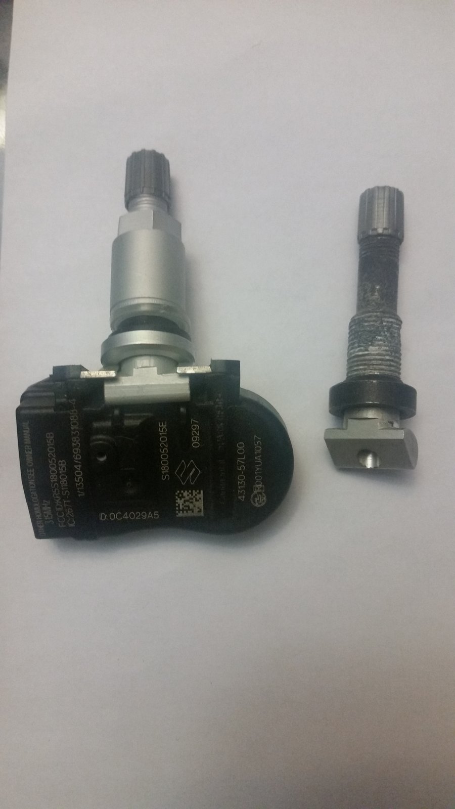

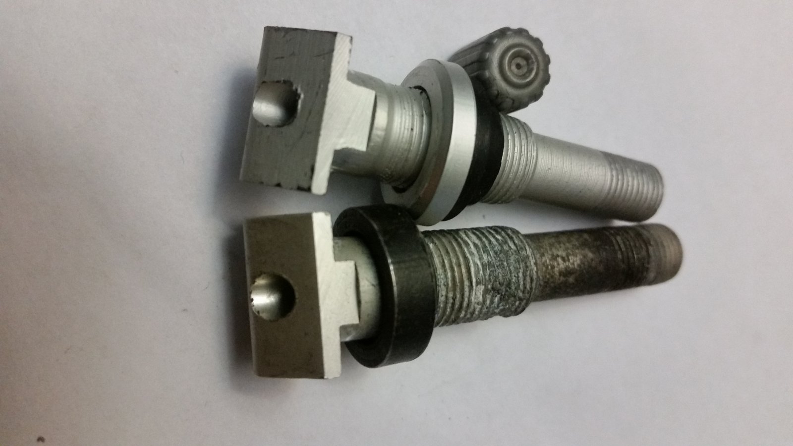

I found a solution regards to TPMS sensor valve. I found out that the metal area is damage and can't be fixed, so I found a Kizashi replacement tire stem rebuild kit on ebay for $8. Everywhere I went they're selling me something different or they don't have it, but they want to sell the whole entire device.
The metal part can be replace.
