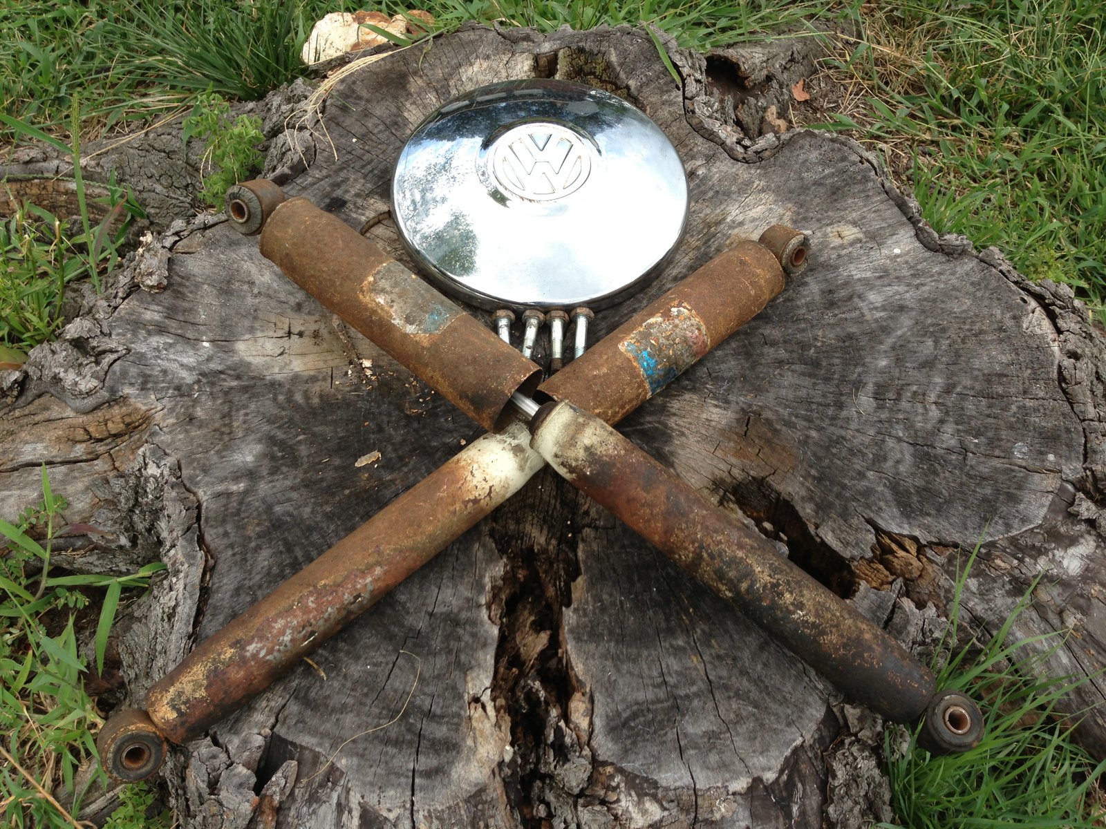

- Replaced all shocks with KYB Excel-Gs. (The old ones were complete goners.)

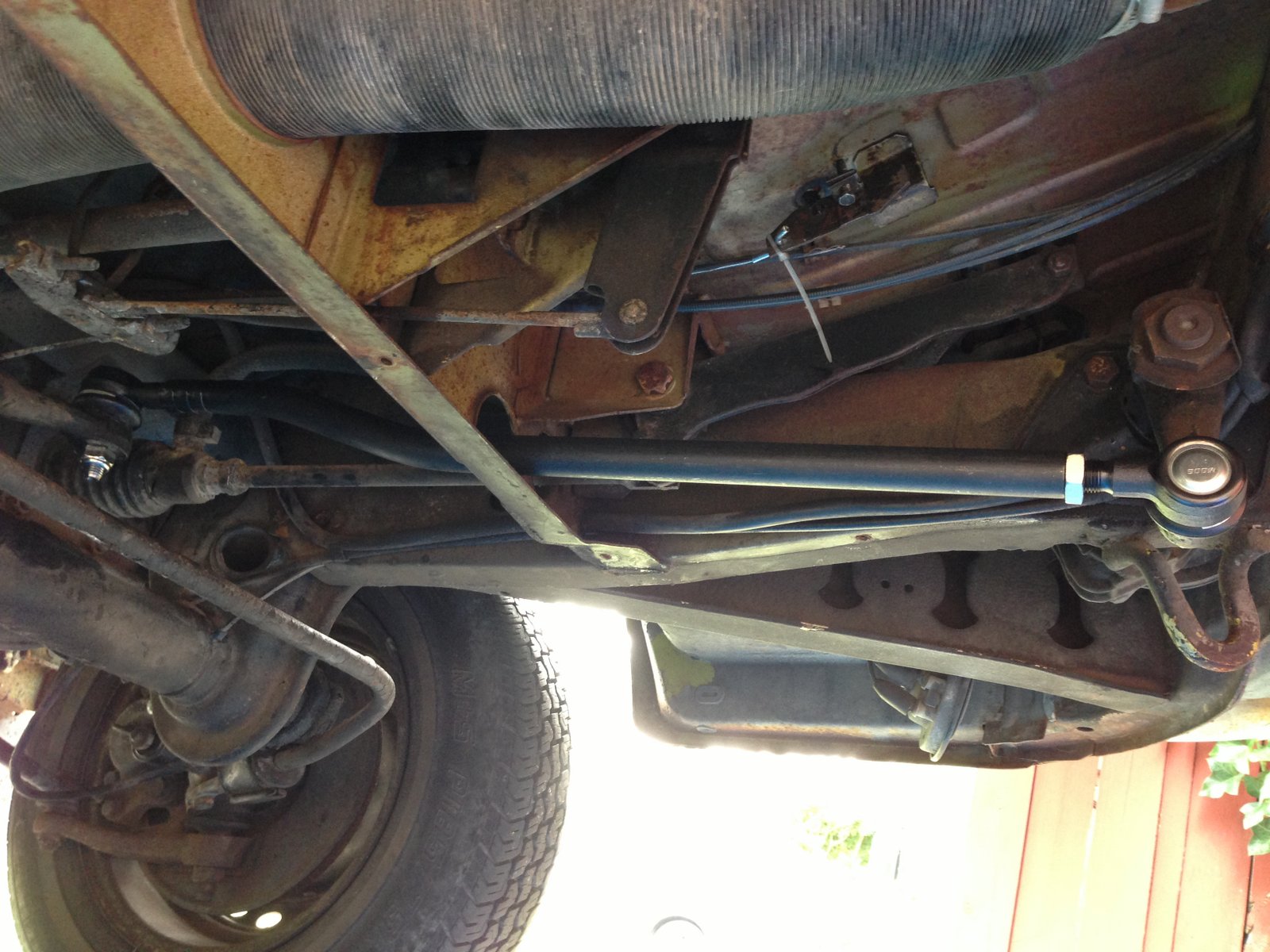

- Replaced the drag link. (Got rid of the clunking in the steering.)

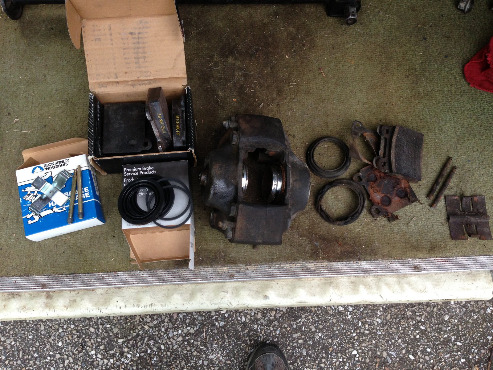

- Replaced front brake pads and rebuilt front calipers. (Got rid of the screech and the bus stops decently now.)

Here are some older photos from the VW bus project.
Playing with parts.
A new drag link installed.
Front brake caliper rebuild.
