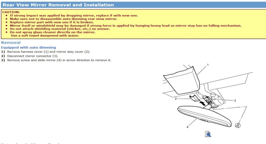

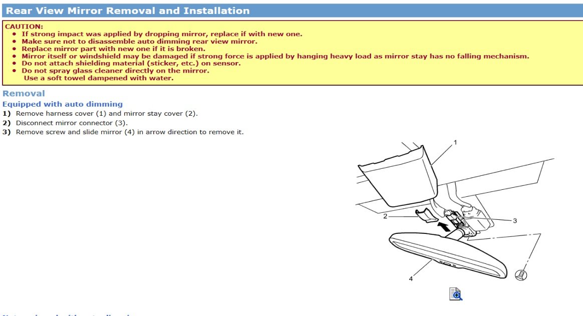

Can you please describe how to take off the mirror? I'd like to take a look behind. Maybe it's a matter of dust or something - like I said, all worked well right after the windshield was replaced earlier this year.

here instruction to open mirror and check sensor

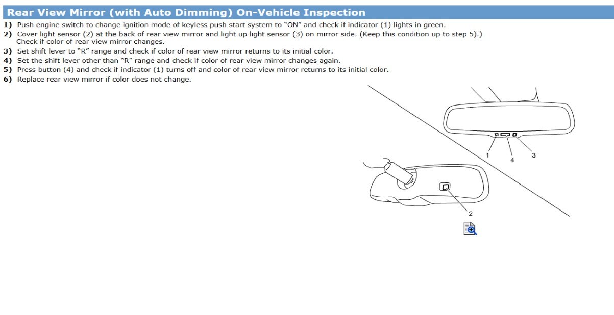

I think the best way to describe is to quote from the service manual
