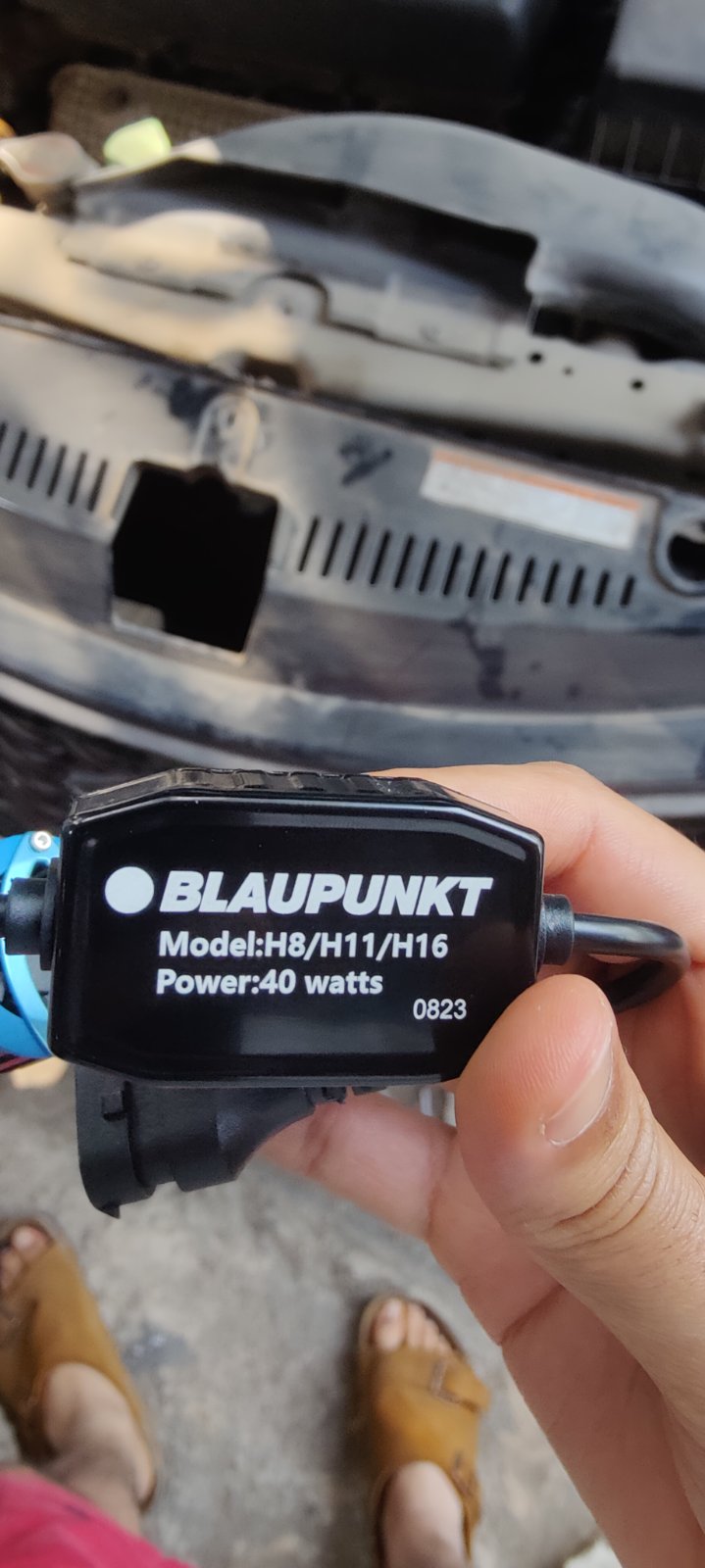

I too changed all my bulbs (3 pairs - high beams, headlight and fog lamps) to all LEDs. This was long overdue since I've been running my car on factory halogens last 11 years. Will click more pictures at night and post them soon.
