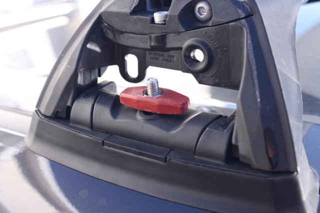

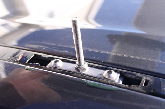

Installation requires that you attach a bracket to each roof anchor (2 screws each, 8 total) Each bracket has a single bolt sticking up. The crossbars go on top of the bolts, and tighten down with flat red wing nuts.

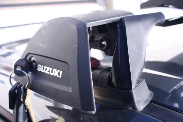

The locks you see are for an outer faceplate that prevents access to the wing nuts. The faceplates are the only place you'll see the Suzuki branding.
One thing I highly regretted when trying to put them back on this winter was that I didn't treat the permanent threads on the roof, nor the screws for the brackets last year. Rust!! It took a little bit of elbow grease and a ton of wd40 to get them tightened back down, glad I put them on when it was above 50 degrees outside. Hopefully, come spring, they won't be permanently attached. I haven't come up with a good idea regarding rustproofing them next spring when/if I take them back off again.

Bracket attached to the factory anchors: With Crossbar attached + wingnut tightened: Cover with lock to prevent theft:
