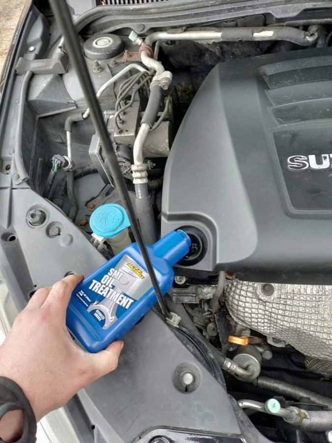

Hello, I am new in this forum, from czech republic, sorry for my bad language.. I have finally bought kizashi 2010 cvt automat, 200 000 kilometers on the speedometer, everything is fine and smooth, love this car. I bought it, change oil and now, after 12000 kilometers i look on the oil and the motor take about 1,5 liter of oil. My question is, if in this 2010 year kizashi is normal, that motor take about 1,5 l oil after 12 000 kilometers. I think, that my ride is normal, no need for speed on the road, normal speed.. I check with mechanics every single piece under the hood and car, and no drops of oil anywere, motor is clean and dry. Thanks everyone for comment, I love this car and if it will be the engine broken, take too much oil and need expensive repair, I dont now, what to do..

Good point! Yesterday we add this to oil, it might little help, before the next step
