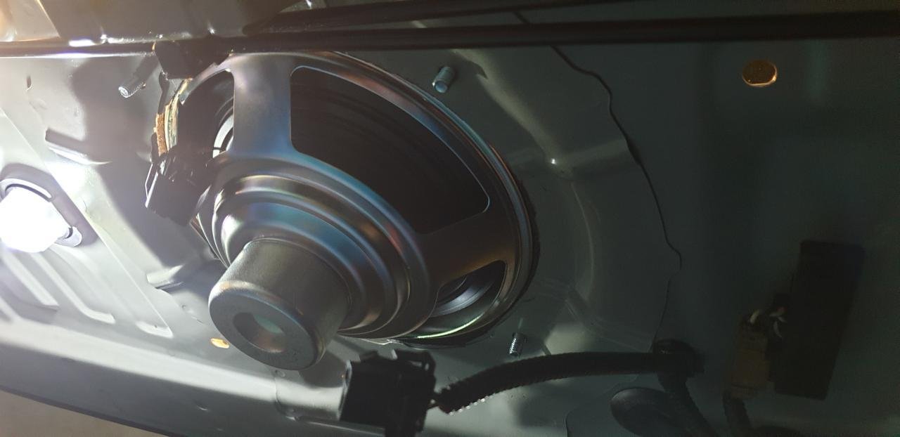

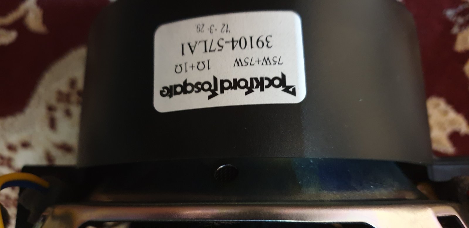

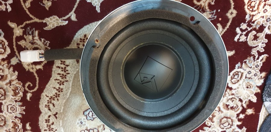

as far as I know, in the case of the subwoofer there are 3 options:
1- no sub: no Rockford sound system just a 2-pin socket also no opening on the trunk.
2- simple sub: in this case also no Rockford sound system but a simple sub for the factory head unit. 3- the last one is Rockford Subwoofer and in this case, there is 4 pin socket and also a factory head unit with a Rockford sound system equipped.

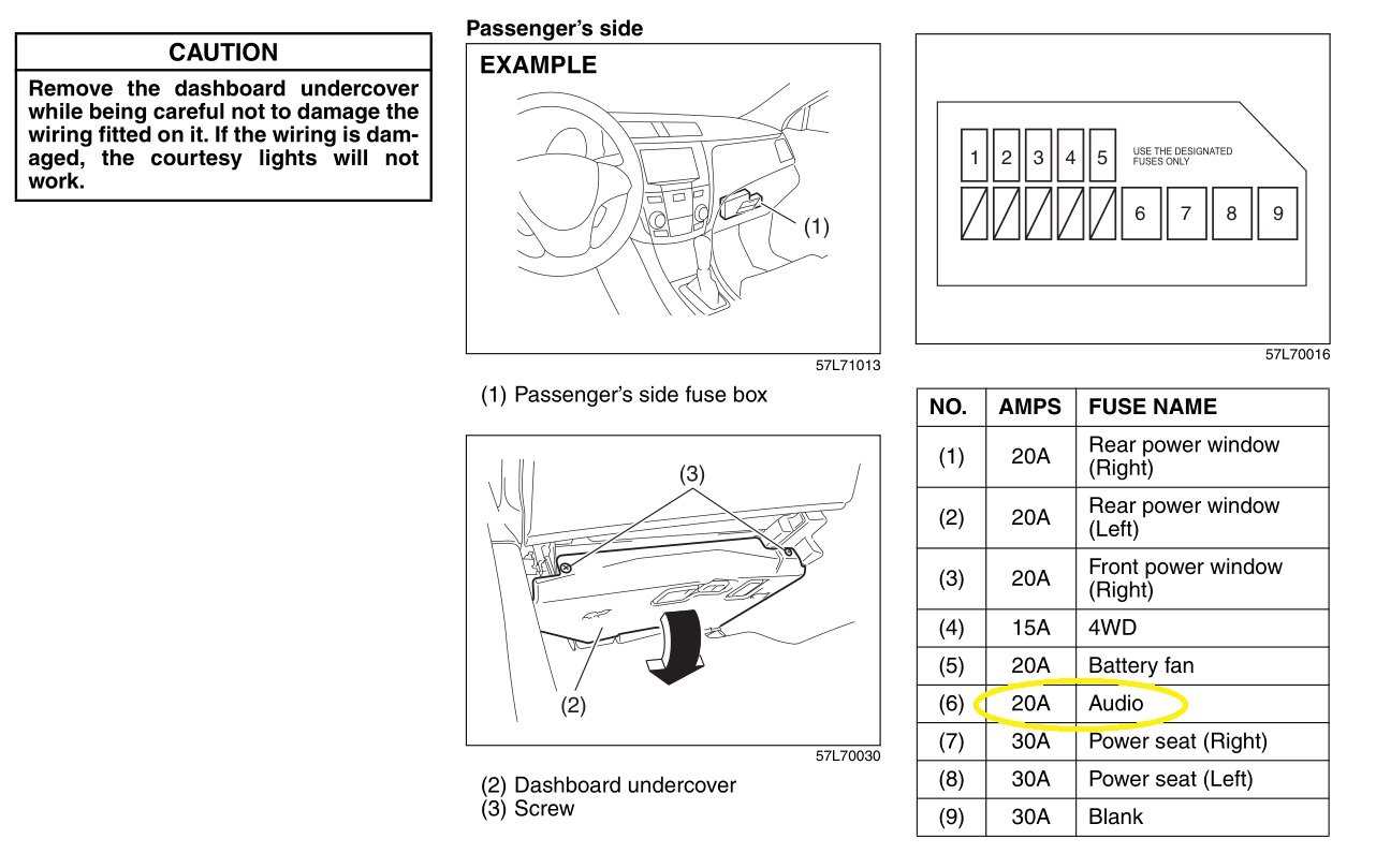

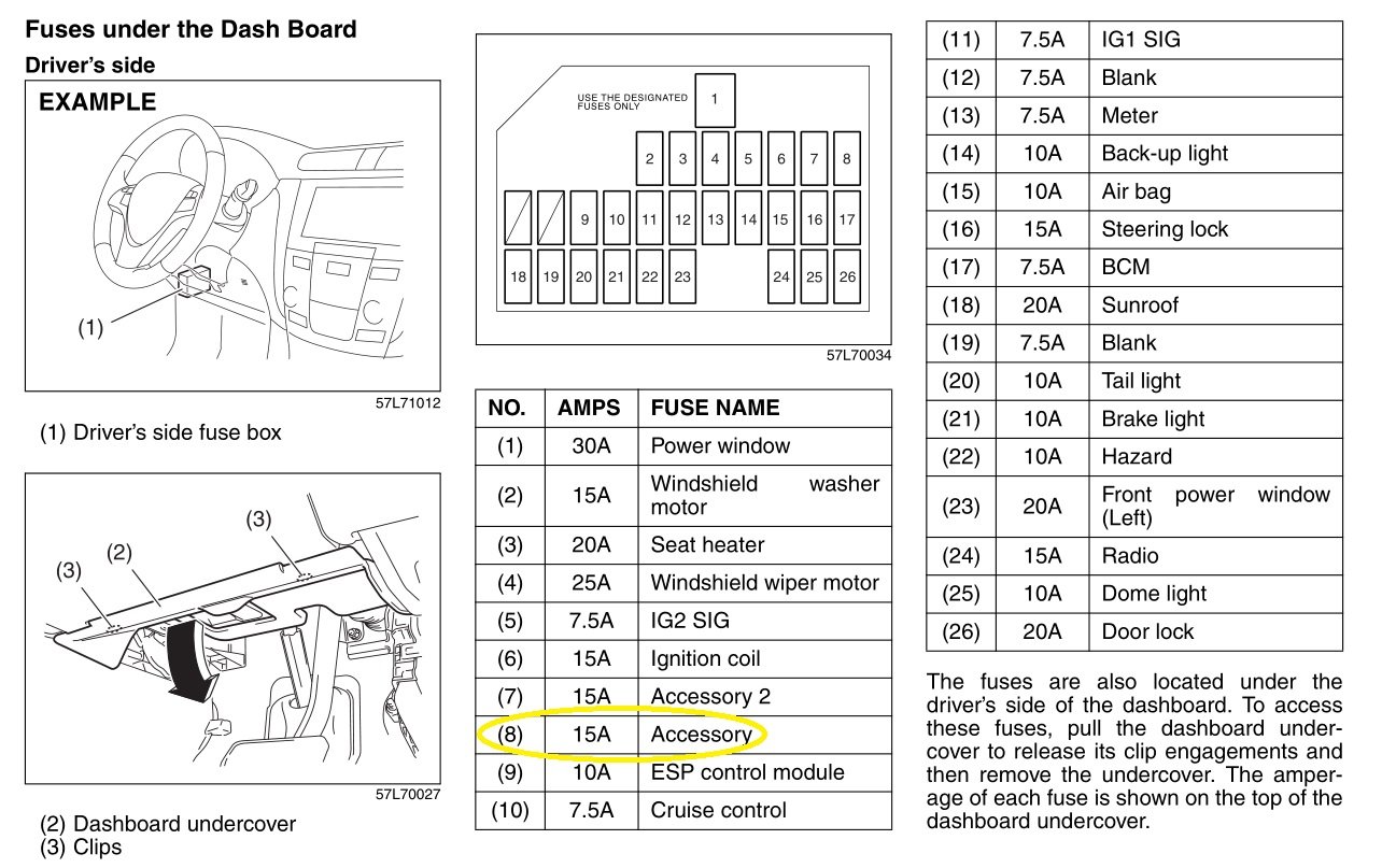

Hey there yes so I have the first set up that you explained. No sub or rockford system. I have successfully hooked everything up. I am getting power to my amp from my main sorce, but I read nothing on my remote wire when car is on and stero is aswell. So my amp isn't powering on, I also made sure everything was grounded properly aswell. (I am using a RCA adapter) I did get looking into fuses to see the set up below the glove box , and I notice that there is an audio slot for a 20A fuse. If I were to add a Fuse to it would it work and turn my amp on ? I'm super lost! Thanks for any help !

first, you need to provide a remote wire you have 2 choices:Theghost04 wrote: ↑Sun Mar 27, 2022 11:13 pm Hey there yes so I have the first set up that you explained. No sub or rockford system. I have successfully hooked everything up. I am getting power to my amp from my main sorce, but I read nothing on my remote wire when car is on and stero is aswell. So my amp isn't powering on, I also made sure everything was grounded properly aswell. (I am using a RCA adapter) I did get looking into fuses to see the set up below the glove box , and I notice that there is an audio slot for a 20A fuse. If I were to add a Fuse to it would it work and turn my amp on ? I'm super lost! Thanks for any help !
1- if you are familiar with car wiring and soldering you can tap into ACC wire on the OE head unit connector and use it as remote wire for your amp.
2- in this case you need to check for the fuse box below the steering column and tap into the fuse that connected to ACC(be sure to use a 10A fuse on this wire)
second, you need constant 12V battery power as you mentioned you can use a fuse box under the glove box for that. but amperage for that fuse depends on your amplifier.

Oh also I am wondering what you mean by make sure I use a 10A fuse , do you mean in the ACC along side with my fuse for my amp? Or with the ACC run my amp and sub? Once I get everything else finalized.

and for 10A fuse I mean just for safety you need to add 10A from fuse BOX to your amplifier remote pin (at beginning of your remote wire of course )
