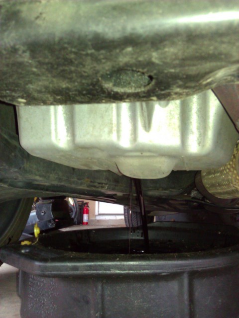

At this point I lower the car, ensuring it's level. Let the oil continue to drain.

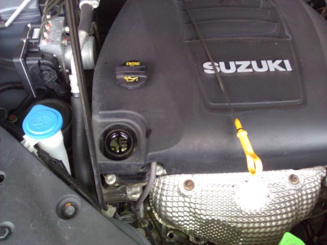

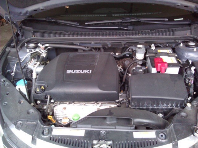

Remove the oil cap and the oil dipstick. Wipe clean. Removing these items allows more air into the engine and the oil will flow faster. (I prefer removing these after the oil plug but it is a personal preference.)

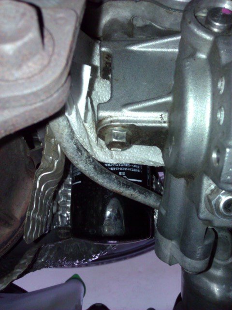

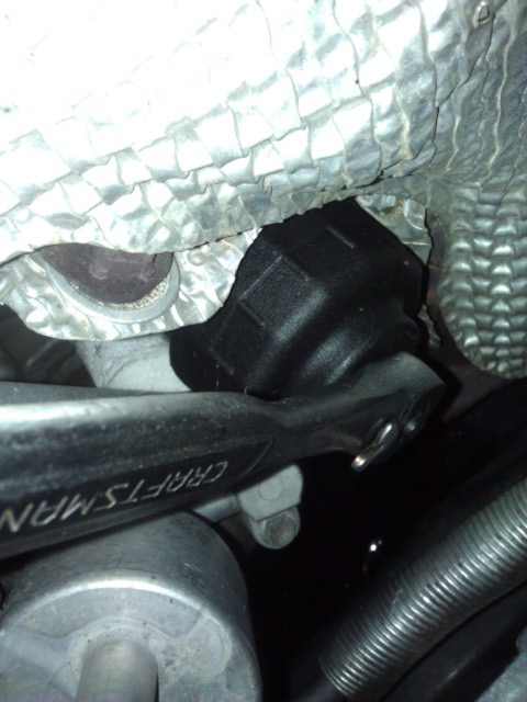

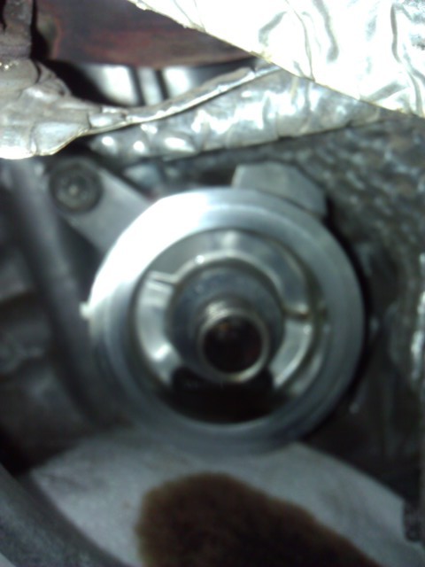

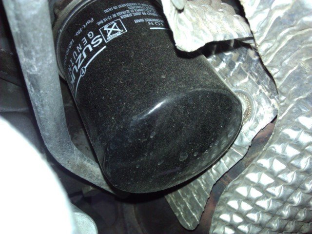

Clean the oil filter mount. Put a bit of clean oil on the outside ring. Get the new oil filter and put a bit of clean oil on the outside ring. Put the new oil filter on. Twisting clockwise until tight. Then add about a 1/4-1/2 a turn.

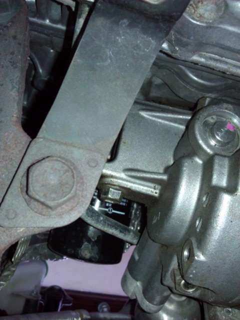

Wait until the car is done draining. (I give it about 1/2 hour but that's probably way overkill.) Jack the car up.
Climb under and clean up the oil spills. There will be some under and by the oil filter. There will be some by the oil drain plug.

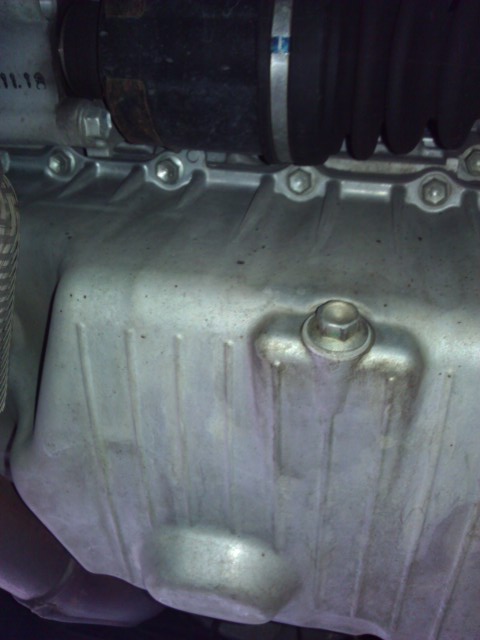

Take the oil plug and gasket. Put a bit of clean oil on the threads and seat of the oil plug. Put a bit of clean oil on both sides of the gasket. Wipe the oil plug hole on the oil pan. Put a bit of clean oil on the oil plug hole on the oil pan. Put the oil plug in. Twisting clockwise until tight. Use the 14mm wrench and tighten just barely snug. Then give the bolt about a 1/4-1/2 turn.

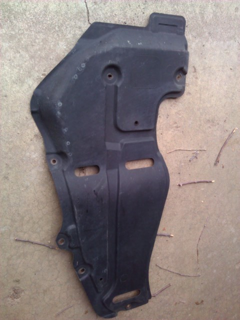

Next reassemble the plastic guard. (I noted my bolts were a bit rusty. I cleaned the rust off and added a bit of grease to them to help prevent rust. Another reason to do these yourself is you are more likely to give these extra pieces a bit of extra care. The cheapo oil change shop won't.)

Grab your funnel and put it in the oil hole. Pour in about 4 3/4 quarts of oil. Put the oil cap back on.
Put the dipstick back in. Check the level a couple of times. (On my car the oil was above the full dot on the stick.)
