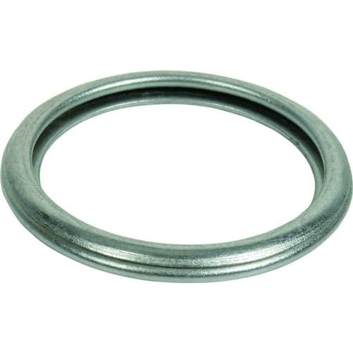

Not all oil drain bolt washers need to be replaced. It's pretty clear to tell the crush-type from the permanent. I've changed the oil in the Kizashi a few times and can say that it has the permanent type, not the crush. The crush type have a hollow space in them and that gets compressed when you tighten the drain bolt. Because of the compression, it needs to be replaced every time. My Subaru Impreza used this type and they can leak if you reuse them too many times. However, most cars now use the permanent type, including the Kizashi. I have absolutely no leaks from my Kizashi.
Below is what the Subaru crush-type washer looks like.
This is the Kizashi's:
I think it's supposed to distort. I only torque to spec, so that can't be it.Ronzuki wrote:If it's crushed to distortion, you (or someone else) were cranking too hard on it in the first place.
My thinking is that if this is the way they designed it, as long as it works that way in reality, it's probably something that needs to be changed.
Even my Nissan's is a solid one like the Kizashi's in the lower picture. But it does distort, even with normal torquing. It's never leaked so I only replaced it once, and it was actually a pain to get off the plug. Once that one seated in, I never replaced it, but I do check it each time to make sure it's in good shape.
