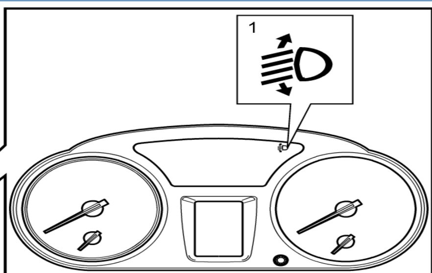

The "Back" fuse on JB No.2 below the steering wheel is the fuse for the automatic headlight level module, but it is not a problem if it is blown; a bunch of other modules will stop working, too.
do you see the indicator for Automatic leveling light on the Instrument Cluster?
