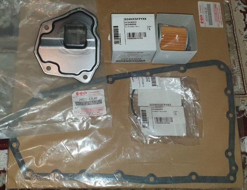

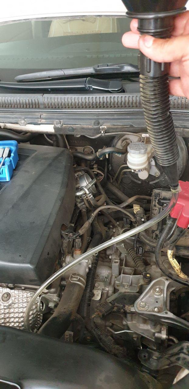

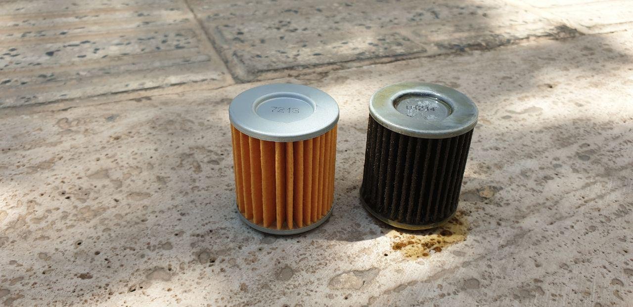

thanks to y Ronzuki I managed to change CVT oil filter today at 140,000Km and also change CVT Oil and this is my third CVT oil change so far
1- at 85,000 Km
2- at 102,000 Km
3- at 140,000 Km
every time around 3.2L CVT Green1 Suzuki. overall gearbox is in good shape I think no whining noise or any error codes so far :D

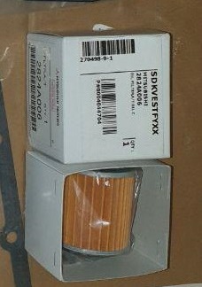

Suzuki does not acknowledge the existence of that filter (or the o-ring for the housing it is inside of). The CVT is made by Jatco and used in several other makes including Nissan, Dodge, and Mitsubishi . Mitsubishi appeared to be the only brand that sells both parts:
Mitsubishi part numbers
CVT Filter: 2824A006
Housing O-ring: 2920A096
yes indeed. here pic for that filter

Before I order CVT Filter: 2824A006 and Housing O-ring: 2920A096 in Mitsubishi I want to make sure that we are talking about Kizashi 2010, which had the JF011E transmission mark.
Edit: I called the suzuki service again and they said that this filter does not appear in my model. And if it had the correct part number is 26572-57LR0
kizashiwanter wrote: Edit: I called the suzuki service again and they said that this filter does not appear in my model. And if it had the correct part number is 26572-57LR0
That's because they're looking at the same diagrams online from Suzuki that can be found elsewhere and that I have in the OE Suzuki parts book. Suzuki calls out nothing internal to the transmission less the pan filter screen and gasket because, well, they didn't design it or build it. So the bearings, pump, cogs, gears and such must not exist in there either according to Suzuki service :roll:
I started this thread and have a 2010 AWD CVT. The Mitsubishi o-ring and aftermarket filter shown in the pics above work. I re-used my original OE factory pan gasket.

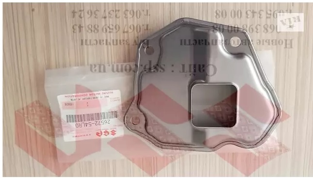

This aftermarket filter fo they have the entrance withdrawn towards the back, does this not affect anything?
I have a 2013 in which the filter is different as seen in the forums and the part number
Aftermarket Filter Enter Slightly Further Bac
26572-54LR0 Kizashi.JPG (191.66 KiB) Viewed 17617 times
Long Tube 2012-2013 And TSB
26572-57LR0 Kizashi 2012-2013.jpg (131.08 KiB) Viewed 17617 times
Original 2010-2011 Without TSB
