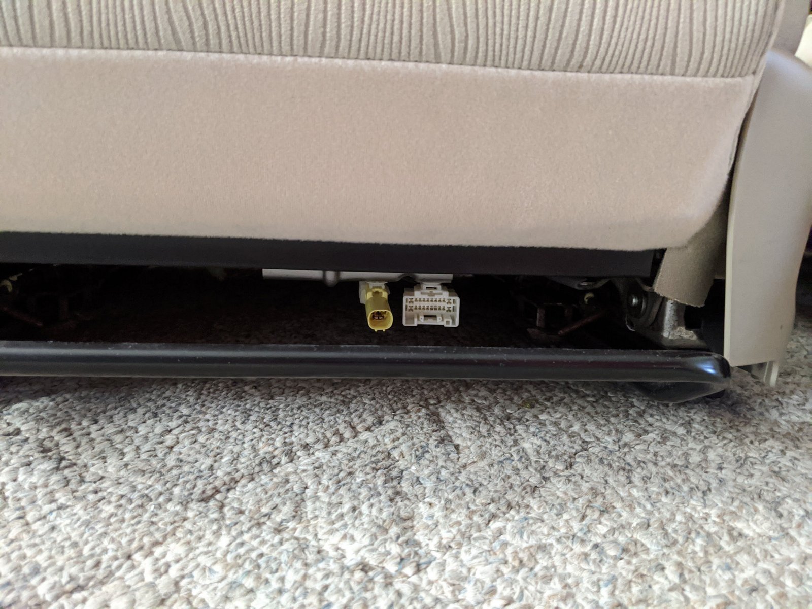

2) There are 2 connections under each front seat that need to be unplugged. A small yellow connector for the air bag, and a larger white connector that carries power for the seats, seat heaters, seat belt sensor, and OCS mat (passenger only) The larger cable with the white connector is held the the seat bottom with a small press clip strap. Carefully remove this from the seat bottom and reinsert in the same spot on the new seat once installed.

5) Set the "new" seat in place. There is a pin on the bottom of each seat rail that drops in to a hole just a bit behind the front bolt to locate them. Plug the yellow and the white connectors in to the bottom of the new seat, and snap the press clip that retains the cable in to the hole on the bottom of the seat. Put the 4 bolts back in to the new seat rails, and torque to 17 ft lb ( 23Nm).

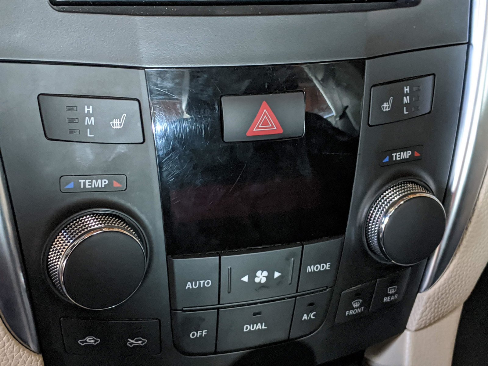

7) At this point the power seat install is done. If you have added *heated* seats, you will need to replace the climate panel in the center console in order to be able to operate them. The climate panel is only held in place with clips, so if you open the cubby below the climate panel, you can get your hand behind it and carefully pop it straight out (try not to twist much or you could break the clips). Unplug the connector on the back of the climate panel, and install a replacement climate panel with the heated seat buttons (part number 39510-57LA0) . These panels are occasionally mis-listed, so I suggest something with a picture of the unit so you can see that the heated seat buttons exist. Just plug the connector in to the new panel, snap it in to place, and it is done.

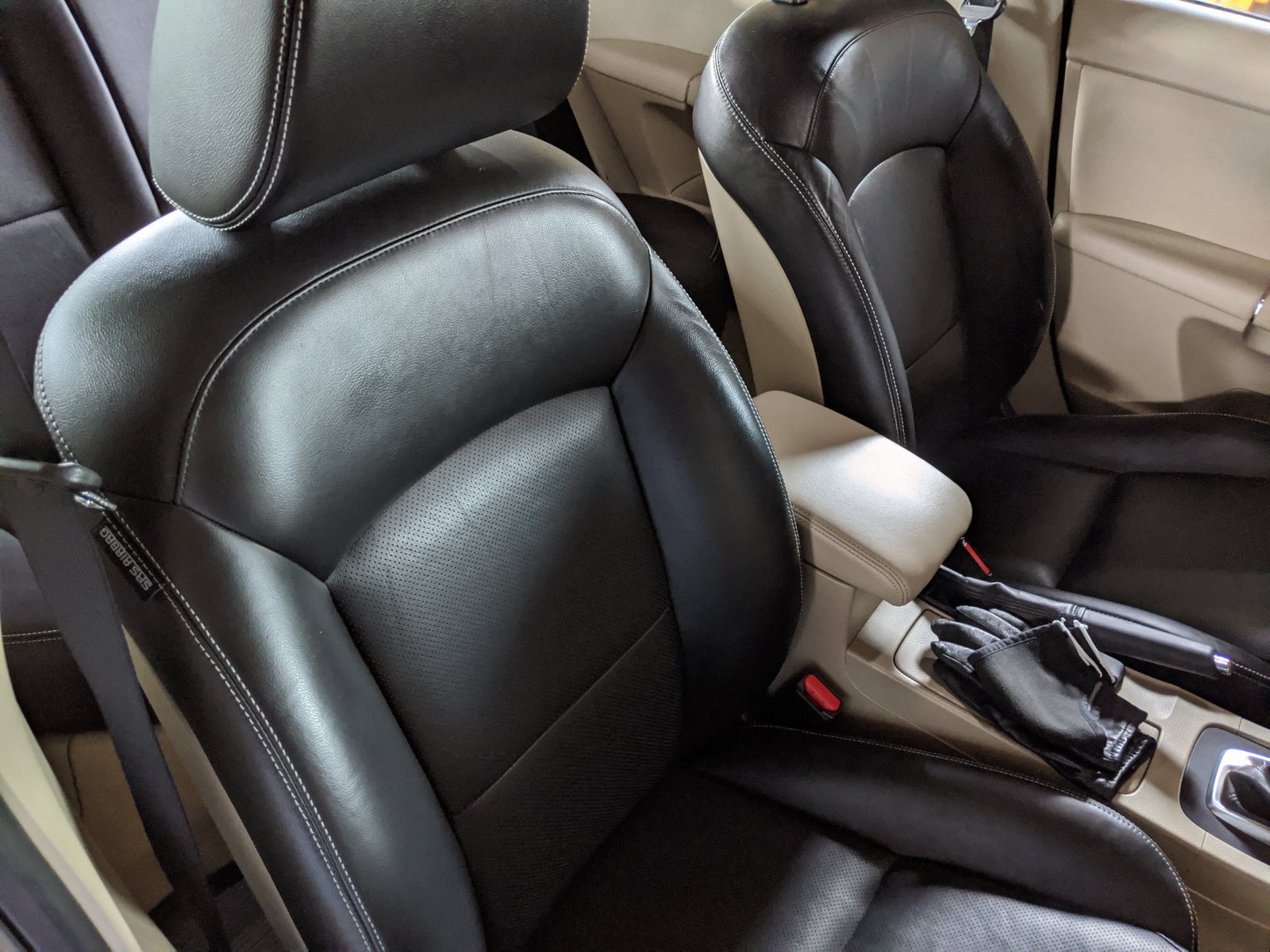

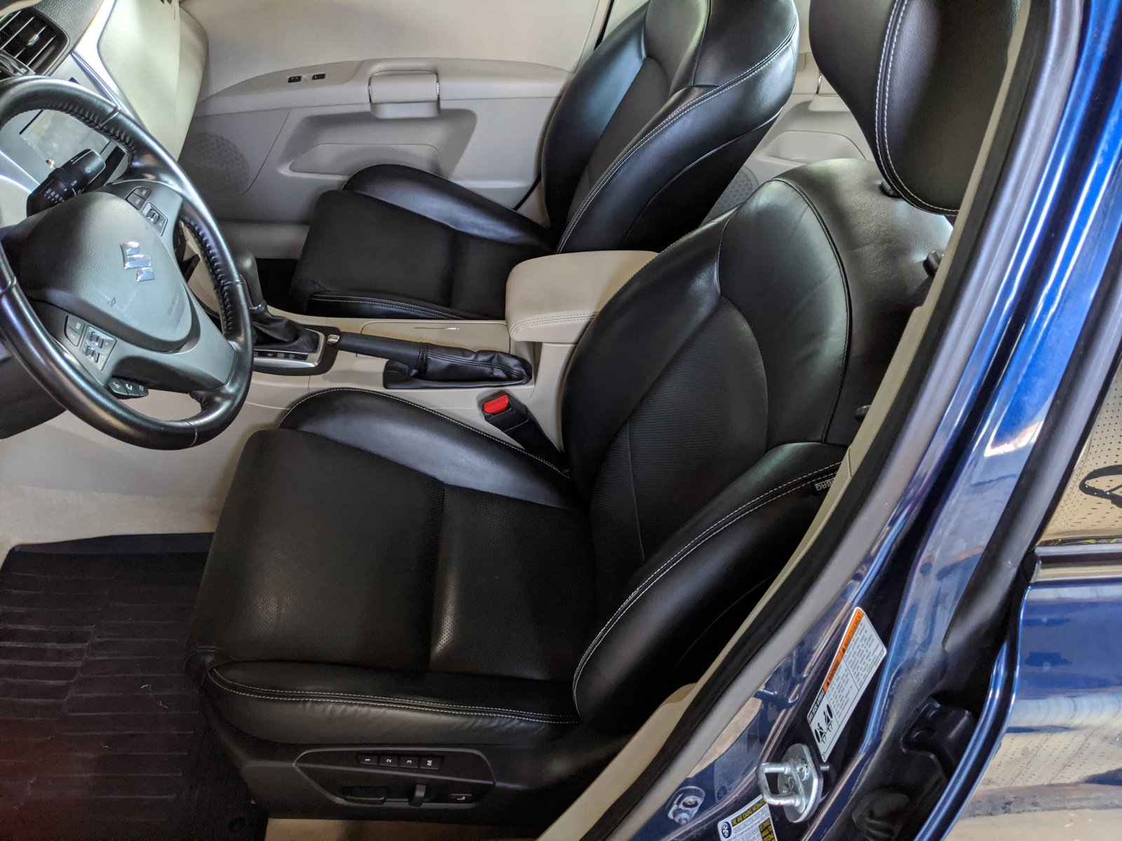

Here are a few photos. If anybody would like a photo of any part in particular, let me know and I can add one.
- New front seats installed
- Front Seats.jpg (314.46 KiB) Viewed 26483 times
- New rear seats installed
- Rear Seats.jpg (294.88 KiB) Viewed 26483 times
- Seat connectors, shown on the old removed seat
- Connector.jpg (316.31 KiB) Viewed 26483 times
- Climate panel with heated seat buttons
- Climate Panel.jpg (310.76 KiB) Viewed 26483 times

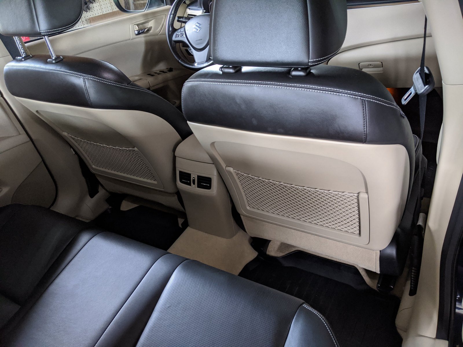

Update:
I decided to see what I though of the tan seat back shells with the black seats. I'll leave it that way for a bit and decide how I feel about it.
- IMG_130809.jpg (312.18 KiB) Viewed 26149 times
- IMG_130733.jpg (312.68 KiB) Viewed 26149 times
