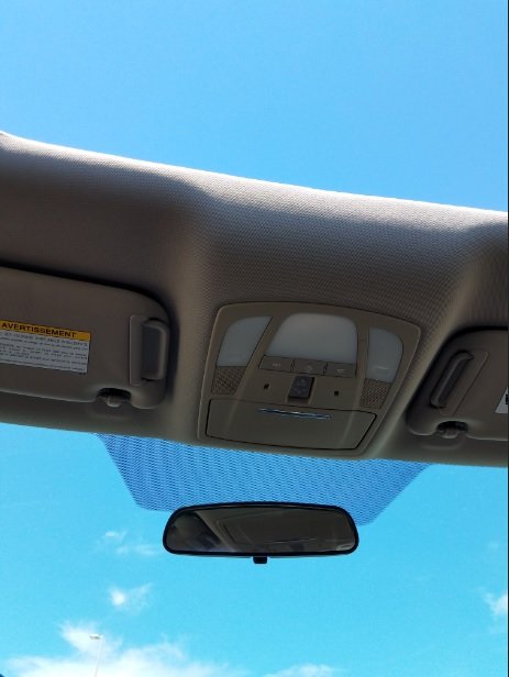

Ate lunch under the open sunroof in my 100,000+ mile Kiz that I've owned for 10 years.

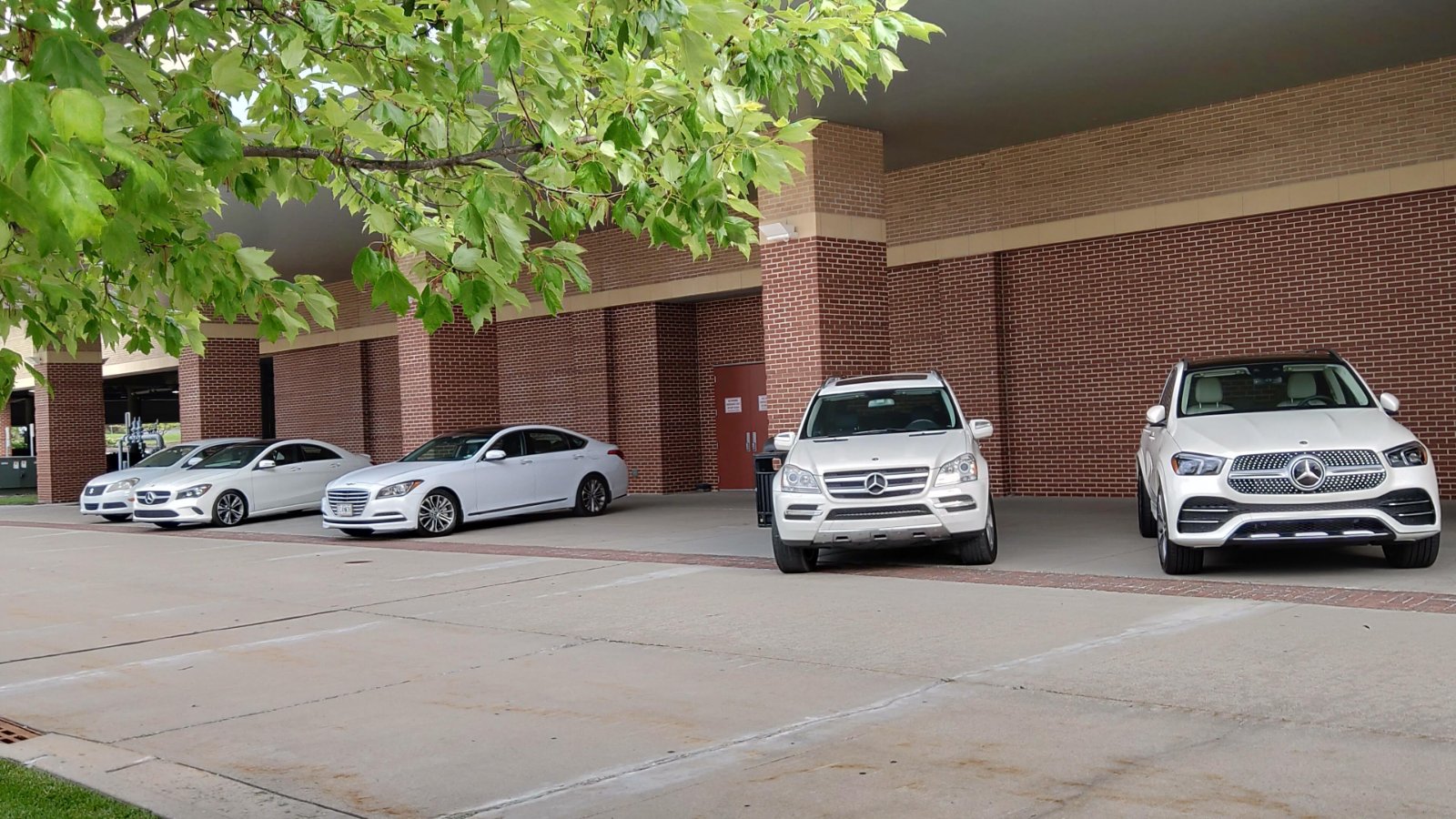

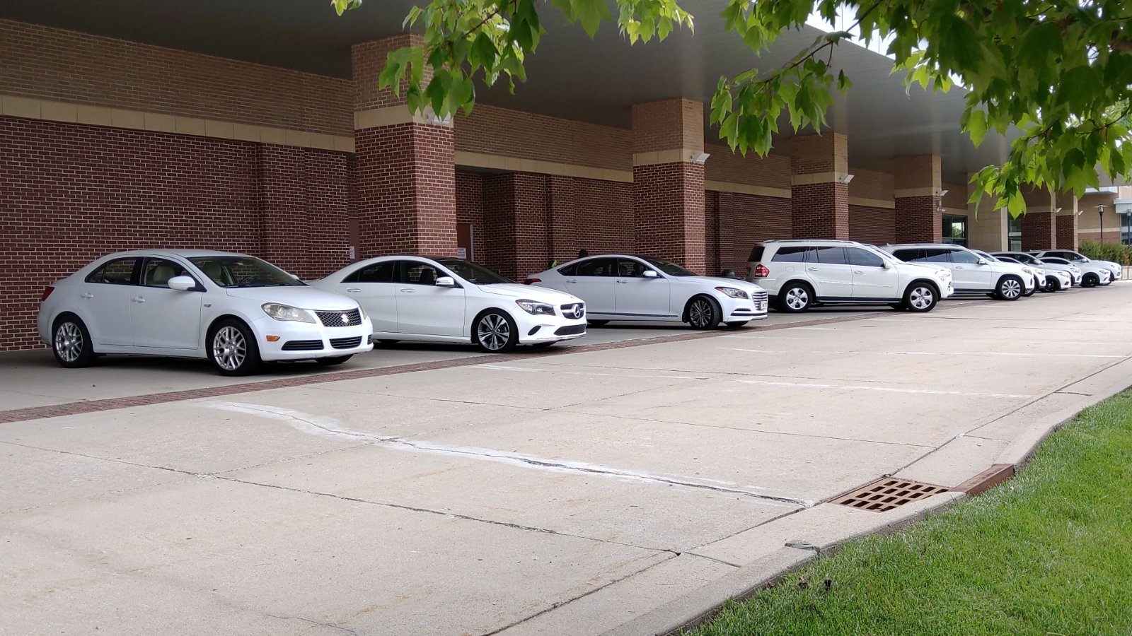

Snuck in to hang out with the preppy kids at an MLM event
3rd car from the left is a Genesis. All of the rest of them besides that one and Azumi are Mercedes Benz.
